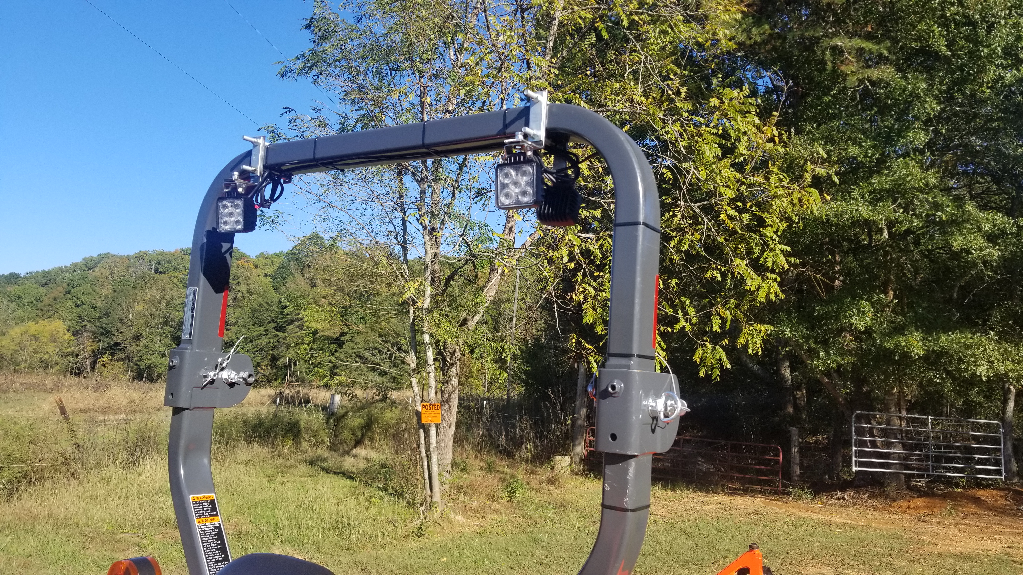

You’re missing what I’m looking for, lighting that does not blind oncoming traffic.
I may need to fabricate a glare shield to go with the flood LEDs I have to guarantee the results I’m looking for if I can’t find a decent pair that won’t break the bank.

I bought a pair of LED lights that are combo Spot/Flood to add to my tractor when I buy it. I know kind of wagon in front of the horse but the more I spend now the less I spend then.

I like my car headlights better whiter. I just mounted some LEDs on my tractor, but I drive that so slowly I don't think depth perception could ever be a problem, if it is true as someone stated. I'll see how I like them soon.

I have amber covers that can be popped on over my LED lights. They work really well for plowing snow by reducing glare and don't seem to blind others while still providing plenty of light. Seems to work really well for me.
