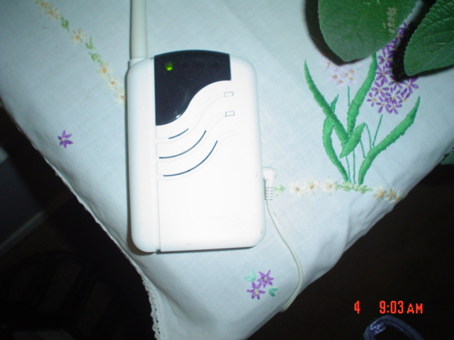

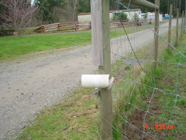

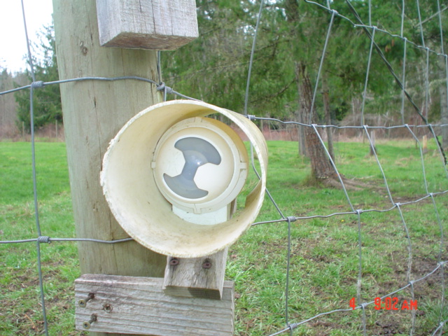

We an Optex driveway alert. It is wireless and has been in use for about 7 years with no problems. Range is good for about 300 feet. I put a white drain pipe over it to keep snow off it. Have 2 receivers for it, one in the house and one on the outside of the barn, that way if we are in the back yard or barn area we will hear it. One night about 10 PM it went off and the wife went to see what set it off, turned on the 500 watt flood light and there was a mother cougar and 2 half grown cubs about 75 feet from our front door.
