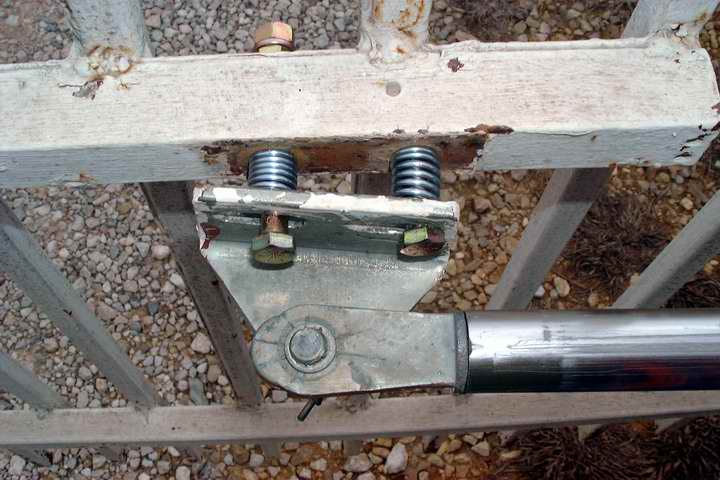

Harv, I thought I'd show you what I've finally done on my girlfriend's gate to get it working again. I decided to leave the gatepost hardware alone and concentrate on the point where the operator attaches to the gate bracket. In this first attached photo, I took a picture of the gate to show that it really is a bit large for this opener. The guy who installed it told my lady friend that the gate was "right on the limit" and I think he fudged a few pounds. /forums/images/graemlins/smile.gif

I removed the gate bracket and put a couple of compression springs behind it. I used grade 8 3/8" bolts because the bolts take a lot of side-to-side stress and grade 2 bolts bent like plastic.

When the operator starts to close or open the gate, the springs compress and the gate doesn't provide an instantaneous load on the operator. The operator is much quieter than it was before when it would load up with the whole weight of the gate as soon as it started to move.

As the gate latches, the operator compresses the left spring to it's maximum and provides a torque buffer. In this picture, you can see the slotted holes on the gate bracket. these had me worried because I thought the bracket sliding back-and-forth would make the calibration of the operator really tough. Well, I was wrong. The bracket just slides from one end to the other and then the springs start to compress and "do their thing" so that nothing is sloppy at all. /forums/images/graemlins/cool.gif
This setup has worked for over a week now with no problems, so I'm hoping it will hold up at least until I can get a better gate operator. All-in-all, I think things have turned out pretty good so far. /forums/images/graemlins/grin.gif

Thanks, John. It's not a "truly" elegant solution, but for now it works and I don't think the gate operator is self-destructing. /forums/images/graemlins/crazy.gif
