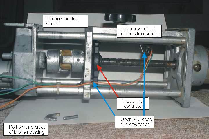

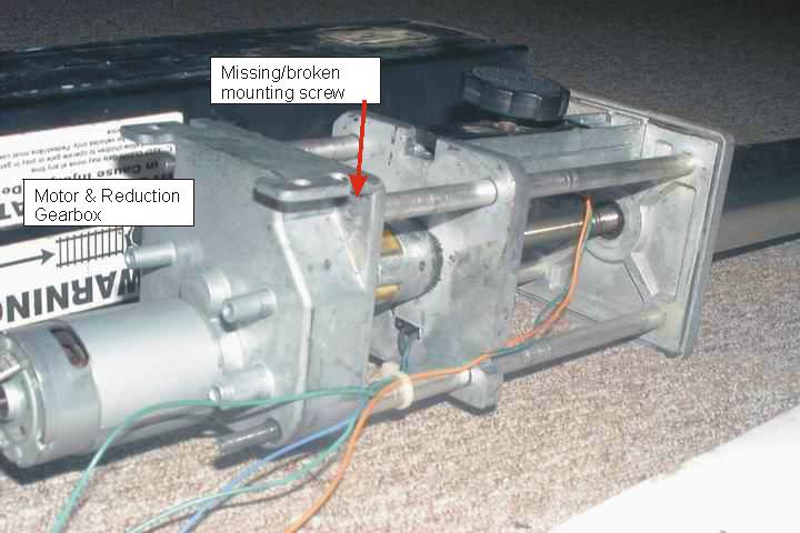

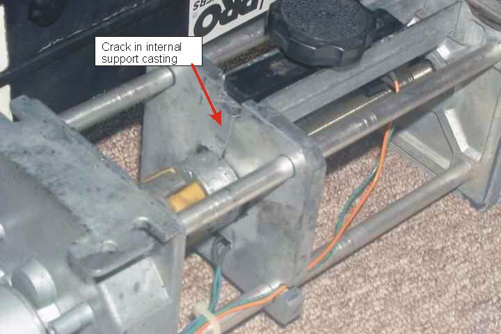

Morning Jim,
Your repair looks great.
I'm glad it worked for you.
I once put a set up on a gate where the gate attachment was attached to a rod that slid back and forth. It had a compression spring too.
But it was to provide a deadbolt affect. When the gate hit home the operator moved another two inches. This shoved the rod into a receptacle providing a dead bolt latch. The first couple of inches of travel released the rod from the receptacle and then the gate would open.
It worked. Was fun. And you can't ask for more than that. /forums/images/graemlins/grin.gif
