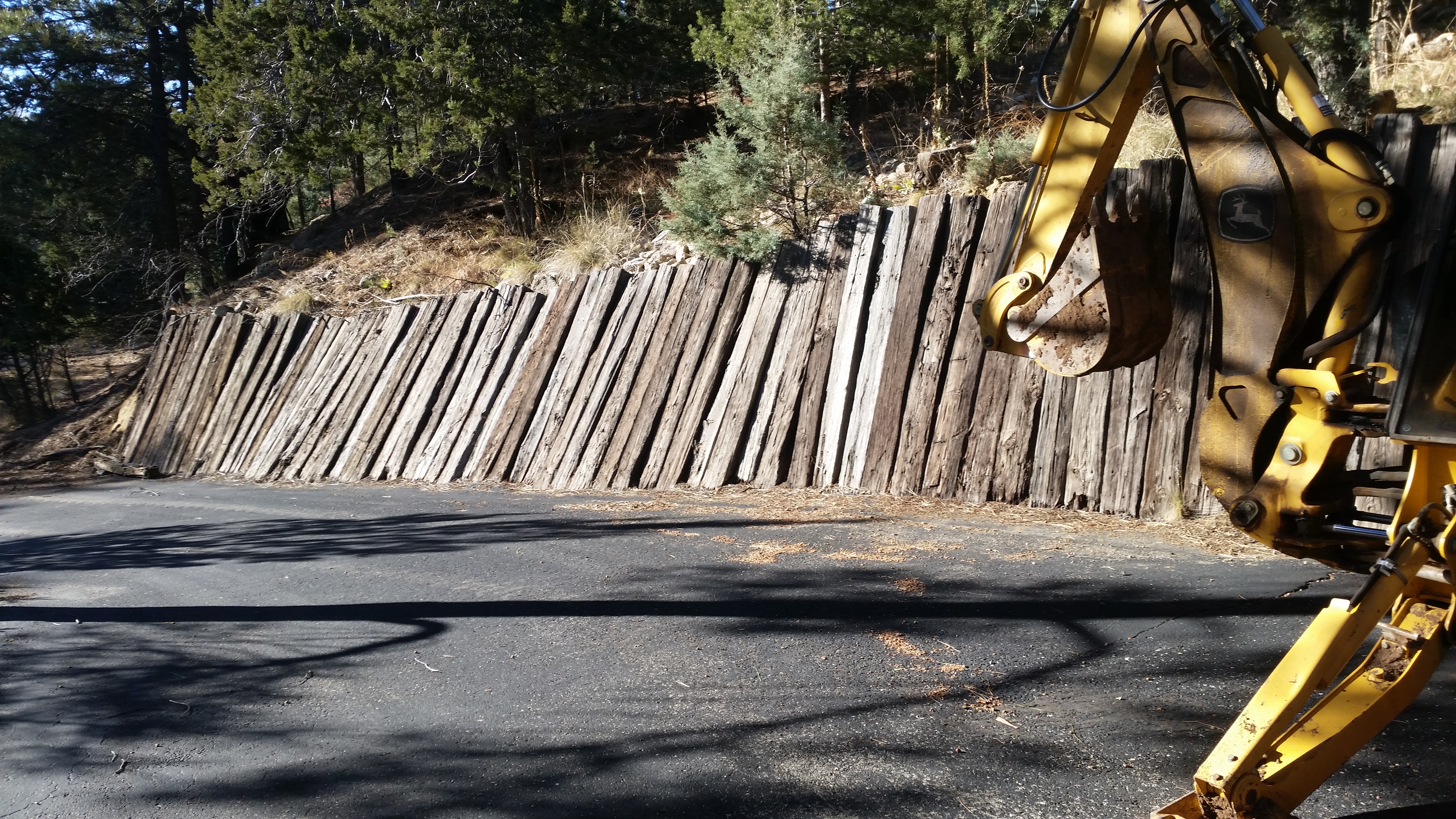

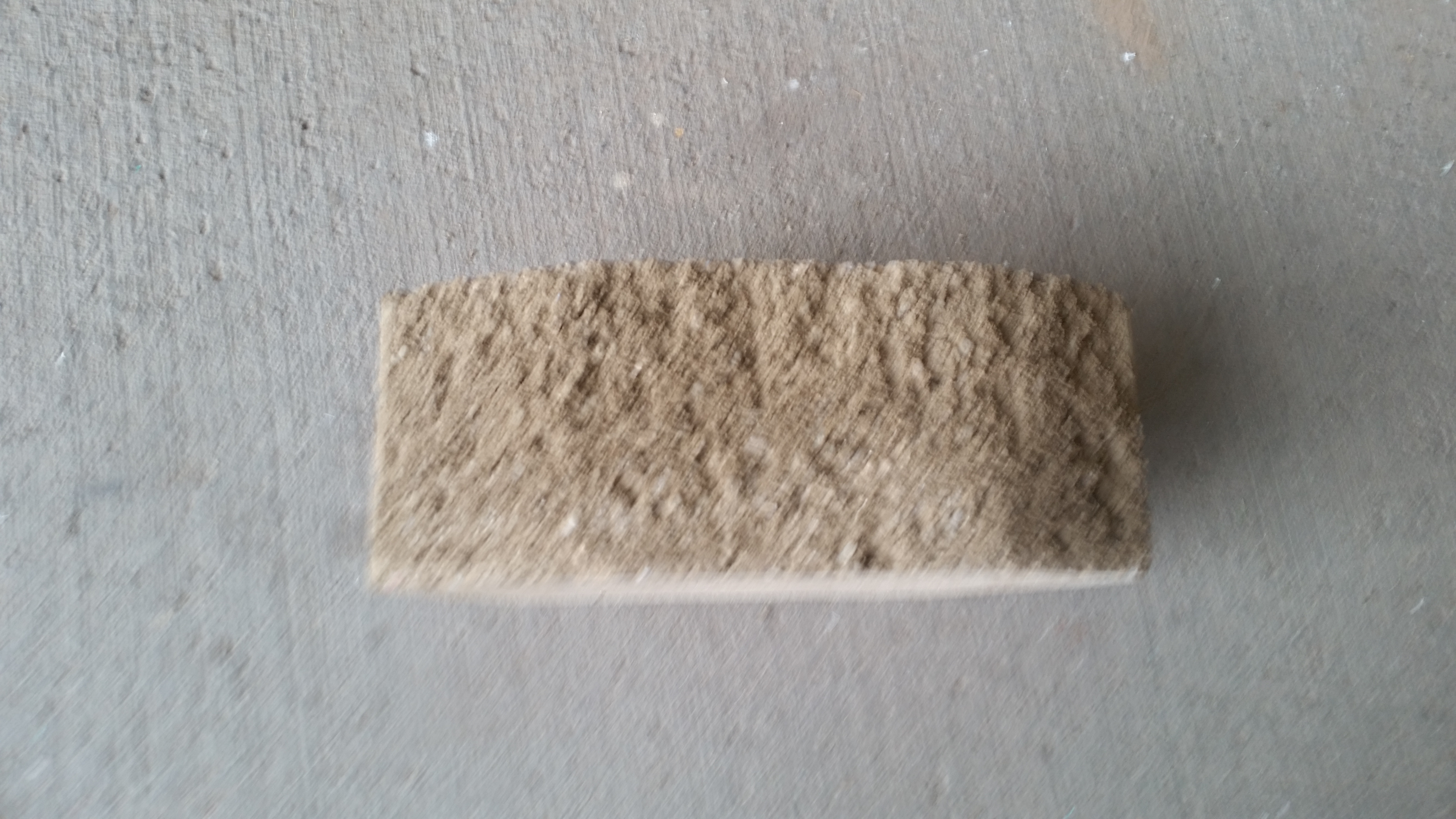

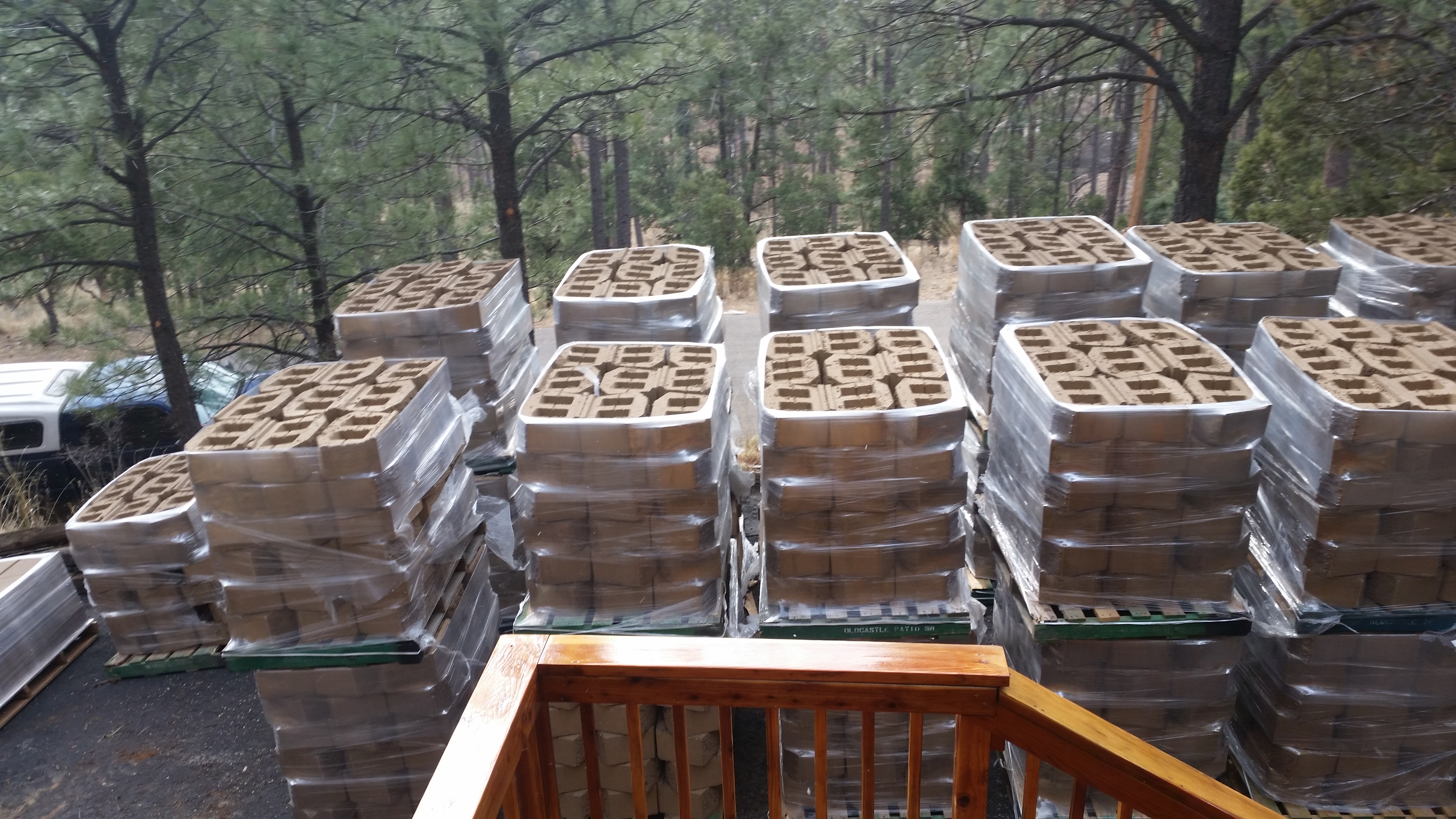

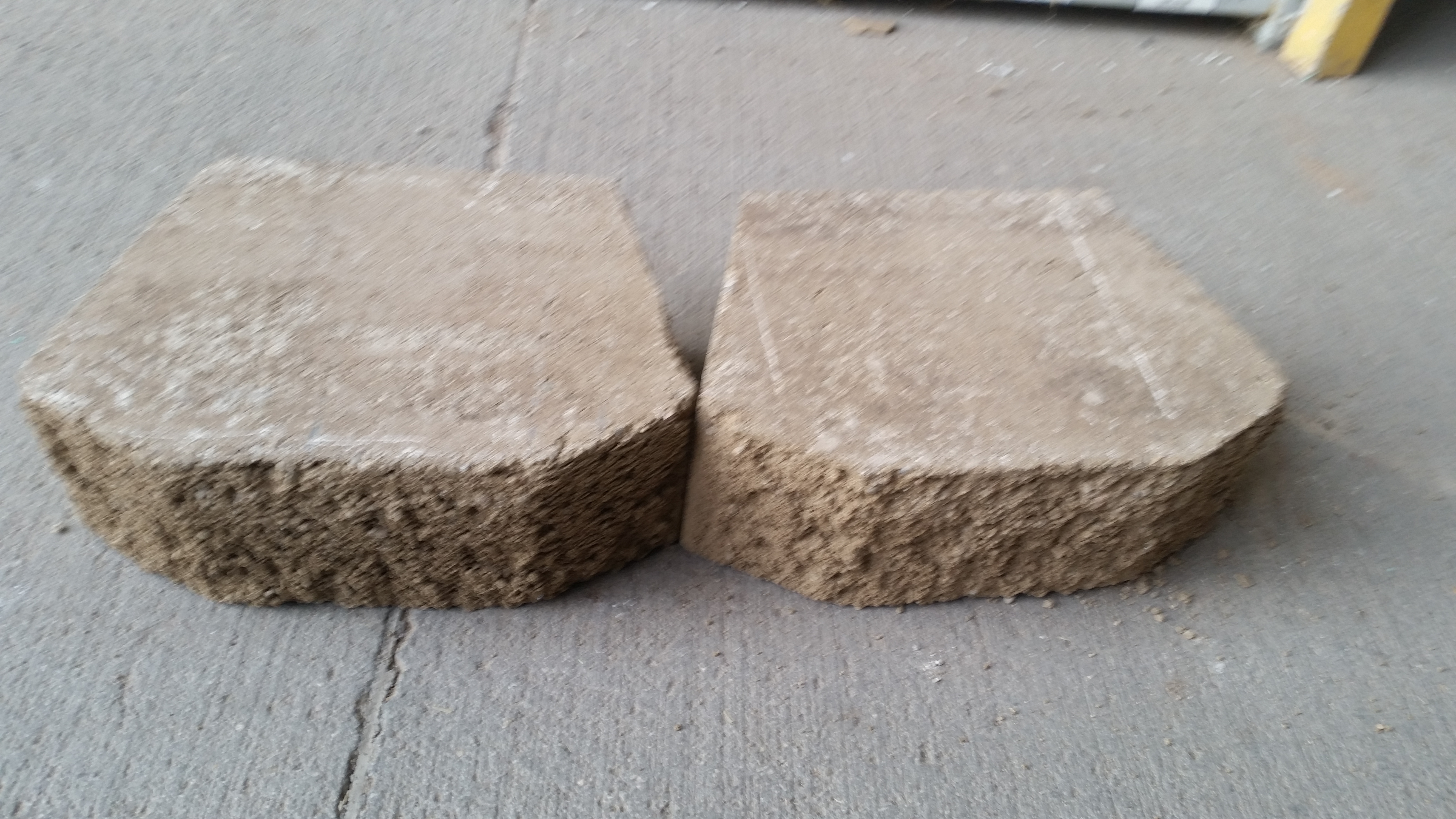

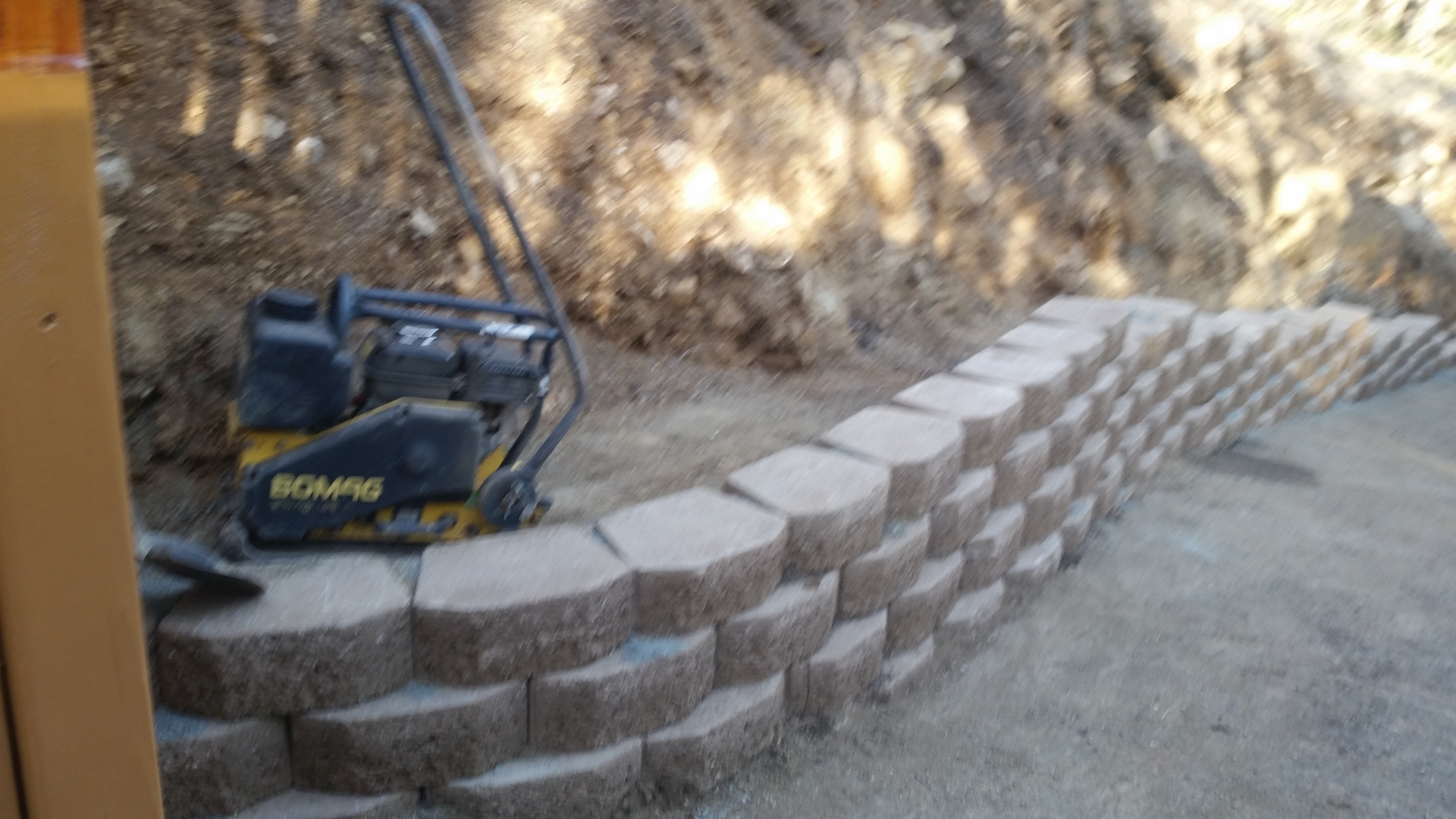

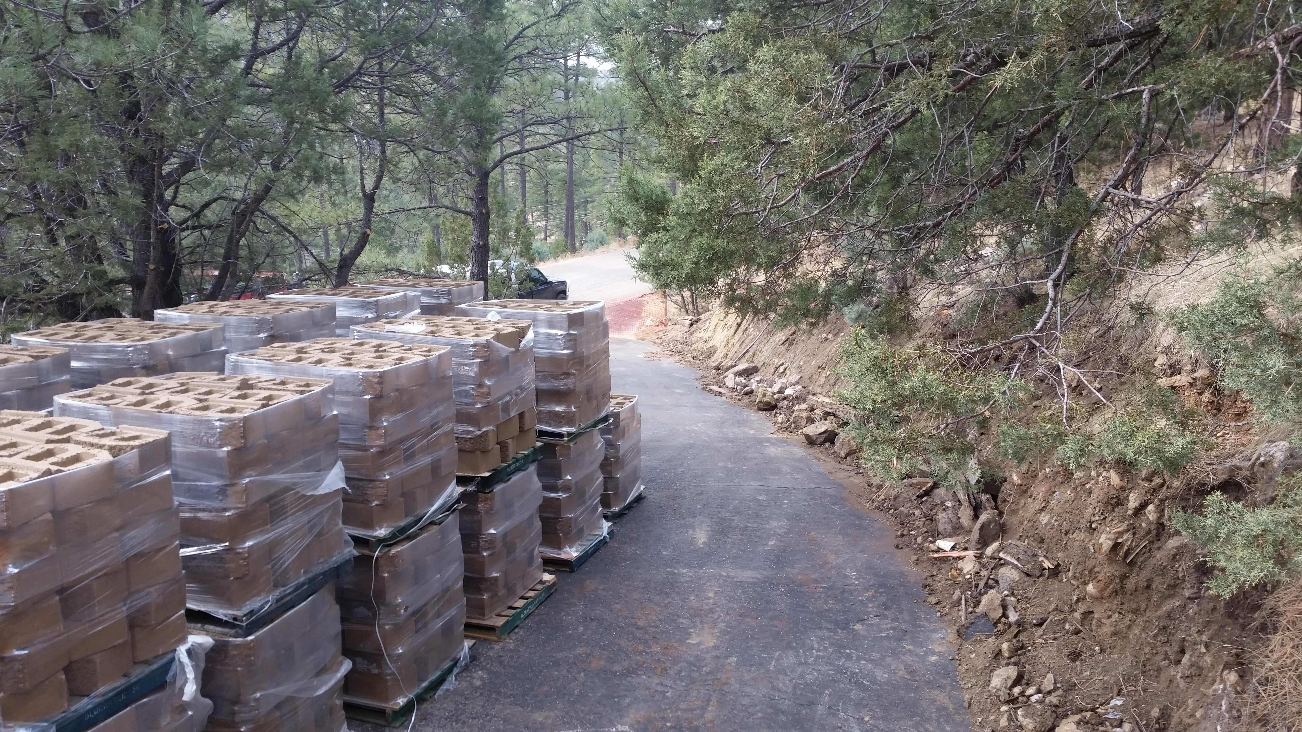

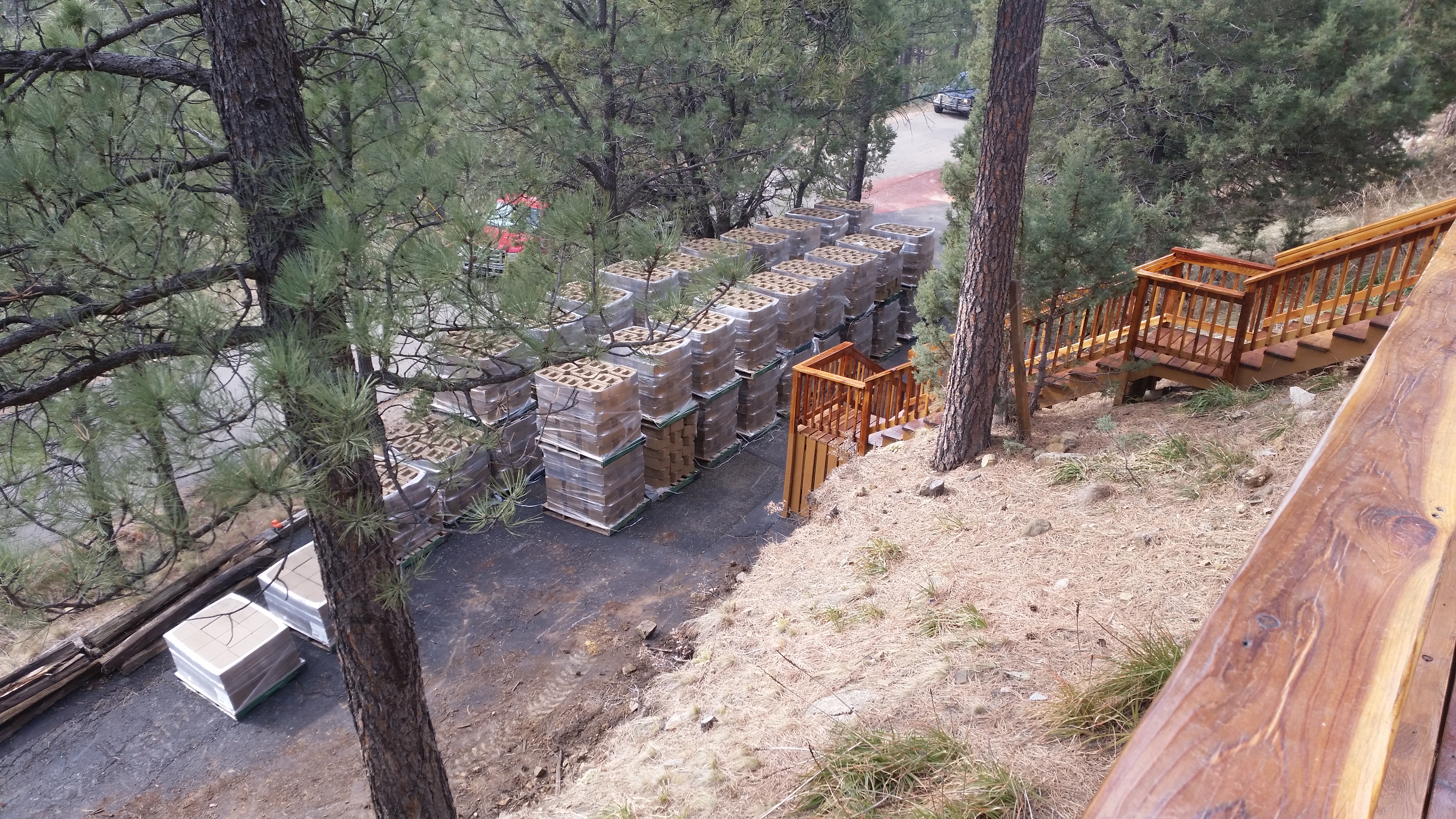

High end pavers and polymeric sand are good for small projects. For most of us operating on a budget cheap pavers, cheap retaining wall block and engineered fill works extremely well. I bought the retaining wall block for this job for $3.50 each delivered up near the top of a mountain. These are concrete with the color all the way through and 62 lbs. each 16x12x6 lwh. Engineered fill is $20/ton delivered. I ordered 2200 block and `12 tons of fill to start. If I had chosen a block that was expensive and used polymeric sand the customer would not have signed up.
The railroad ties along the 180 feet of driveway have been removed and are being replaced with the retaining wall block. Should be finishing this job in the next week or so.

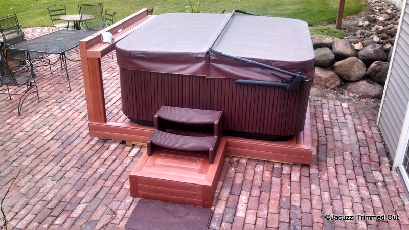

I work in road construction here in WI. I had a job 6 years ago in Watertown, WI that was being reconstructed. Underneath 2" of asphalt, the entire road was brick pavers. I was able to hire a truck driver to bring me a quad axle load of these pavers for $100. I used them for my patio in the back yard. The patio is odd shaped, but about 30' out and 20' wide. I can tell you that after I laid the last paver, I was completely done with them. Once your base is prepped and ready for pavers, they do go in fairly quick, but it sure gets old after while. Looks great, but there is maintenance also. When the frost sets in come winter, the patio heaves here and there. Come spring time, it settles back down to "level". You're talking about a monster job to lay 250' of pavers. I would just drive on the gravel for at least 2 years, and let the base settle. After that, concrete or asphalt. Very costly, but it does add significant eye appeal to the house.
Only pic I could find of the patio was this one, with the Jacuzzi tub all finished up.:D
