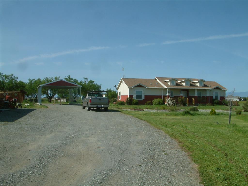

So you like a grey colored driveway. Here's mine.
It's a 20 ft wide x 330 ft long gravel driveway. Ground excavated 6 inches. Three 2" thick lifts of crusher run. Each lift watered and compacted with a vibratory roller.
Cost: $4000 in May 2005. Maintenance expense during the 10 years I owned that ranch: zero
Pavers are the last thing I'd use for a driveway in Maine. Pavers heaving due to freeze/thaw cycles during the winter. Expensive to install and likely a big, costly maintenance headache.
Good luck
