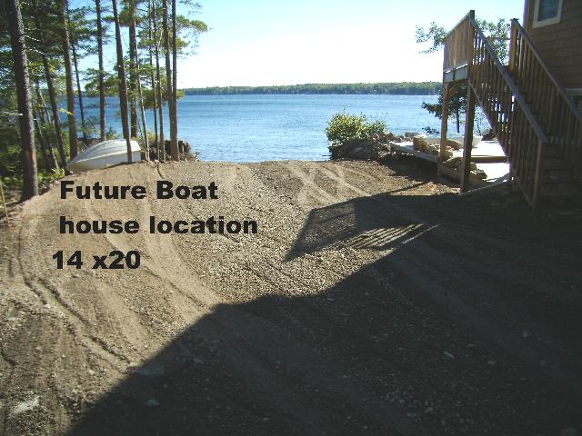

Its just that I have a different perspective of whats proper. For me a well graded gravel laid down and compacted is what I'm looking for for durability.
Others may what a course open graded gravel that looks nice and gives lots of opportunities for working on it to look good. Difference perspectives.:D
By the way I'm not an Engineer.
Picture enclosed of work done with a Kubota B7100 HST and back blade. Make you own judgment on quality of work!:D :D :D
And I will admit I'm not a good operator!:D

Say,..... Egon.... what kind of sailboat will go into that boathouse. That is some thin slice of heaven you got there. As far as the gravel, I think it looks fine it just needs a boat on top of it to make it look more finished.

Easygo, that is not our place. We live in town but do have some lake front land at another lake.:D
I was just doing this work for someone else. Went out to spread a load of sand as a favor and spent most of the summer out there working on projects.:D
