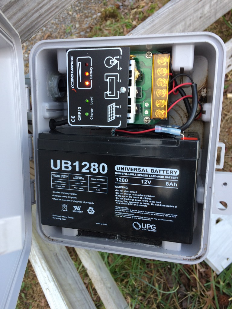

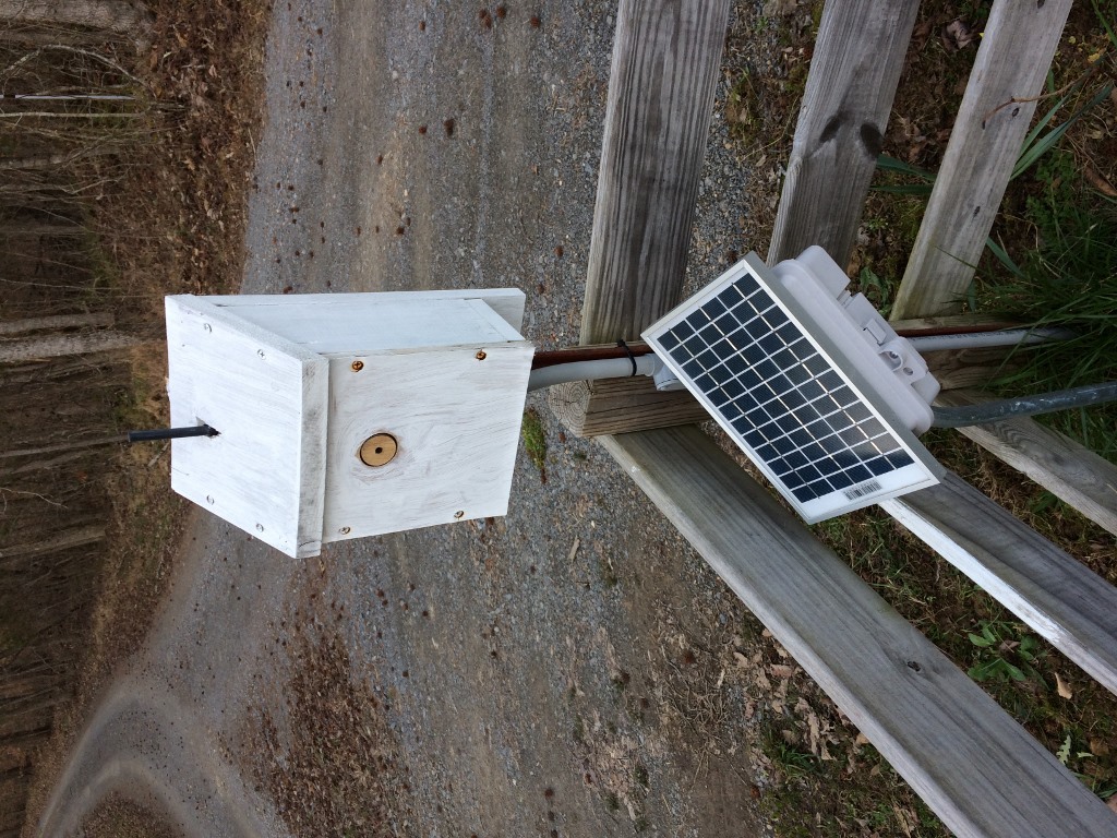

My Dakota Alert transmitters run on 12vdc, meaning a 4 x CR123 battery pack. On the one at the solar gate, I just alligator clip 12vdc from the gate battery to the transmitter battery pack terminals, so no problem there - it has an automotive 12v battery with solar charging via the gate control panel.
I was replacing the CR123s on the other one about twice a year. Maybe 6-8 "events" per day. Got annoyed with that, so built a little outdoor electrical enclosure box filled with a gel cell battery and solar controller and mounted a 20w solar panel on the cover. Got about 2 years of trouble and maintenance-free use out of that so far.

Went to add a pic, but site will no longer let me edit, so -
