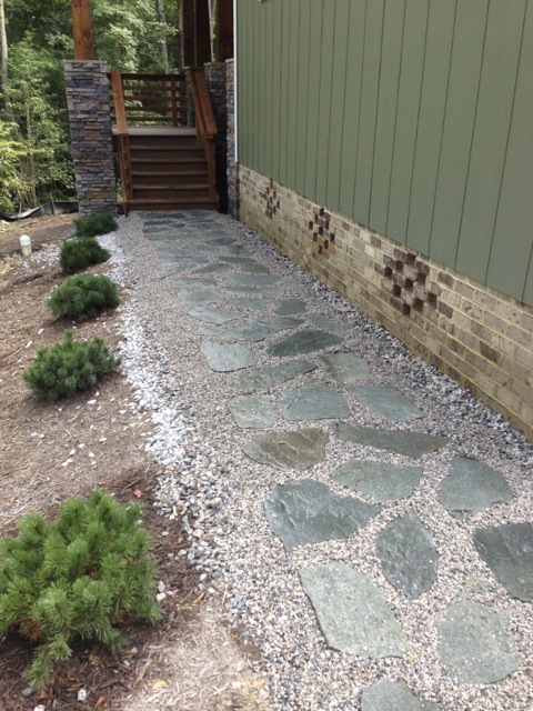

For our sidewalk up to the house, I laid down flagstone (a ton pallet was $300 or so and did about 25' long 3-4' wide). I then spread #8 gravel between the stones to fill in. I may add a little more gravel this summer (after 3 years) to fill in some spots between the flagstone where things settled. I'll see if I can dig up a pic later on. The only downside with the flagstone sidewalk is snow removal in winter. I normally skim over it with a shovel best I can, and then need the sun to do the rest.

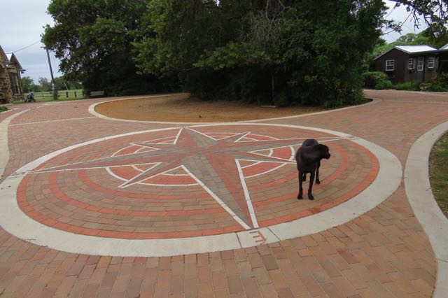

Since you have not ruled out pavers, here is a pick of my circular drive with cement curbing. No dust. Doing a section at a time it is not overwhelming. After the forms were set, I got the pouring of the curbing down to 3min a foot with a home depot mixer and a wheelbarrow. I bought the bags of cement a pallet (42) at a time and could throw them in the mixer from the pallet reducing the number of times I had to handle them.
Holy cow, that looks great. Also, holy cow that looks like a TON of work.
I think pavers are out for me, driveway will be 300-400ft long.

Here are a couple pics of our sidewalk. First shows the flagstones laid out and arranged, and second shows the #8 gravel filling in the cracks. I later lined the edges with gabion stone, but don't have a pic of that.
