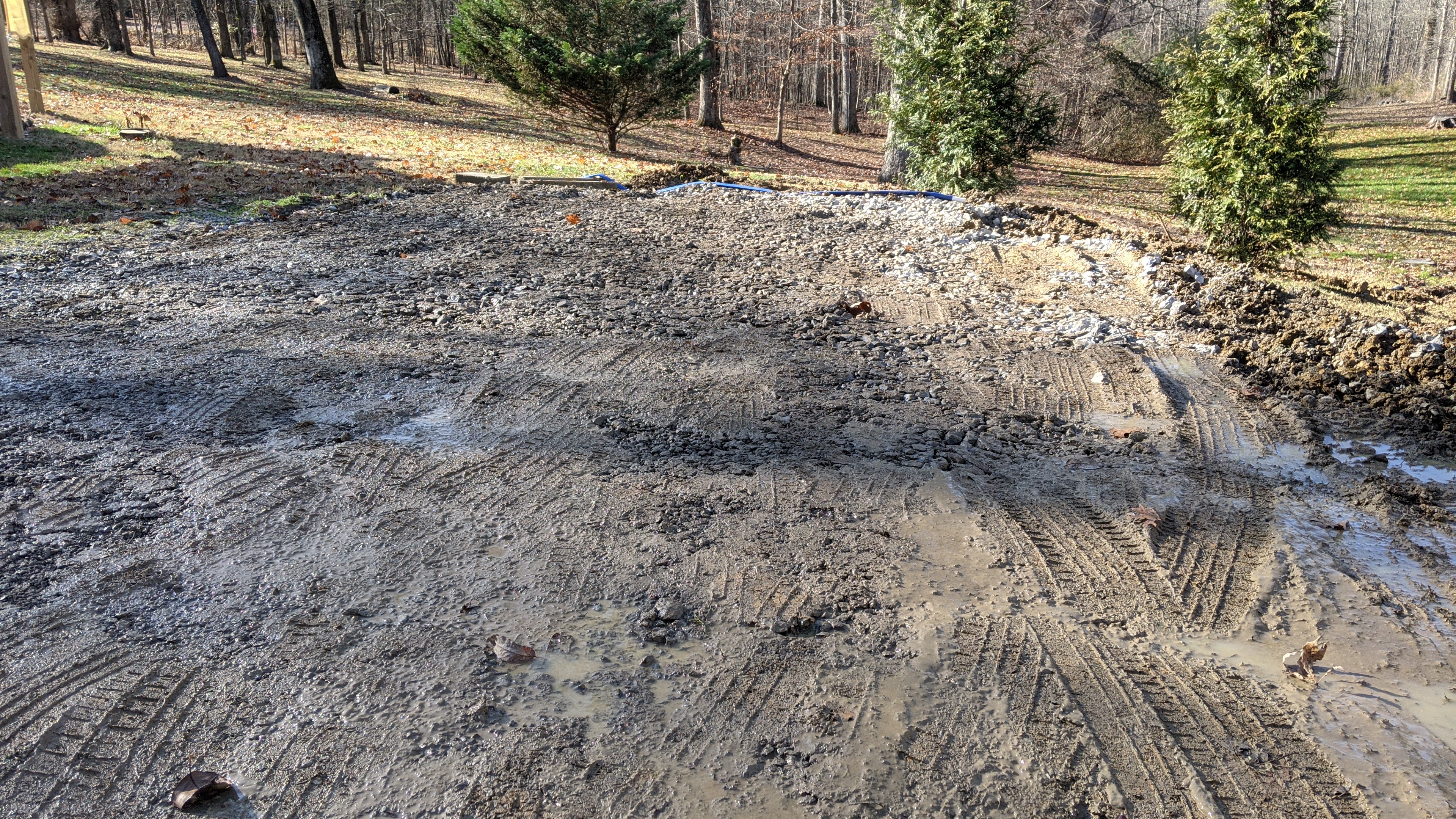

Alright, the consensus so far seems to be a load of large gravel, the existing couple of inches was probably 3/4 - 1" range with a bit more we added on top some years ago. You can't tell because so much just mashed in.. Under that the soil is mostly clay, for whatever that is worth. I'm going to look at leveling the area by filing in the ruts then dropping some 3" gravel on top. Add a layer of finer gravel on top of that. I have seen some ads for road millings and I've been impressed where the road crew used that for the new culvert installed a couple of years ago. That stuff packed in great.
I'm hoping about 4" total will do it, not opposed to spending a bit more but I'm guessing this 20x20' area can all be done for $400-600 total. Still wondering if a fabric would be good to lay down before the load of big gravel.

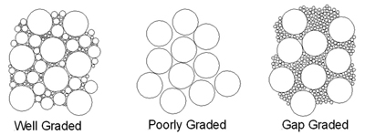

Haven't y'all ever heard advice that say's "when you find yourself in a hole,stop digging"? I believe that applies here. It is universally agreed that present rock is too large and need's airspace filled with smaller material. Digging out present rock just stir's up loose soil and mixes dirt with existing rock. Next time it rains, all that dirt turn's to mud and sinks. No need to spend time digging,put a layer of pea gravel on top of what's there to fill gaps,put a layer of fines over that to fill gaps in pea gravel and finish off with material that set's up to shed water. Collectivly,those layers will raise pad above grade.
No, No, No. Don't use pea gravel or any kind of rounded rock for a driving surface. It's like driving on marbles. I put down 4" of river gravel for a parking pad one time because that was all i could get. I got my car on it, but it wasn't coming off. I could either call a tow truck or start shoveling. Only use crushed stone or crushed concrete that will lock together.

The idea is to have pea gravel work it's way down through the large stuff to fill gaps. You omitted those two words when you highlighted what I said.
   / Driveway trailer ruts #14
Level off what you got there. It doesn’t have any fines so it will not pack. Properly. Then add three quarters or half inch crushed gravel that is well graded and compact. Add till you get the firmness you desire. Then you can add the concrete tire pads.
