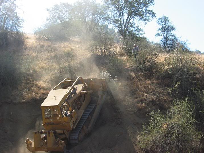

This a dozer, not a tractor but I thought it pretty interesting to see how steep they can work. This was while cutting a road into my property.

Dozers may work the steep but only staight on. Crosswise they have their limitations too.

Tracked vehicles are entirely different animals. The tracks will cut their own berm while going sideways (slightly uphill) and the berm keeps the machine from sliding down. The hills (mountains) around here that I've seen them work are insane. To see them go over and down a hill that appears for all practical purpose to be a sheer dropoff is plain incredible. Of course the trick is for them to operate the blade so that you are always pushing a pile while going down... Nevertheless, it still takes nerves of steel (or an insane person) to task this. Obviously, tractors are completely different, as we have digressed...
