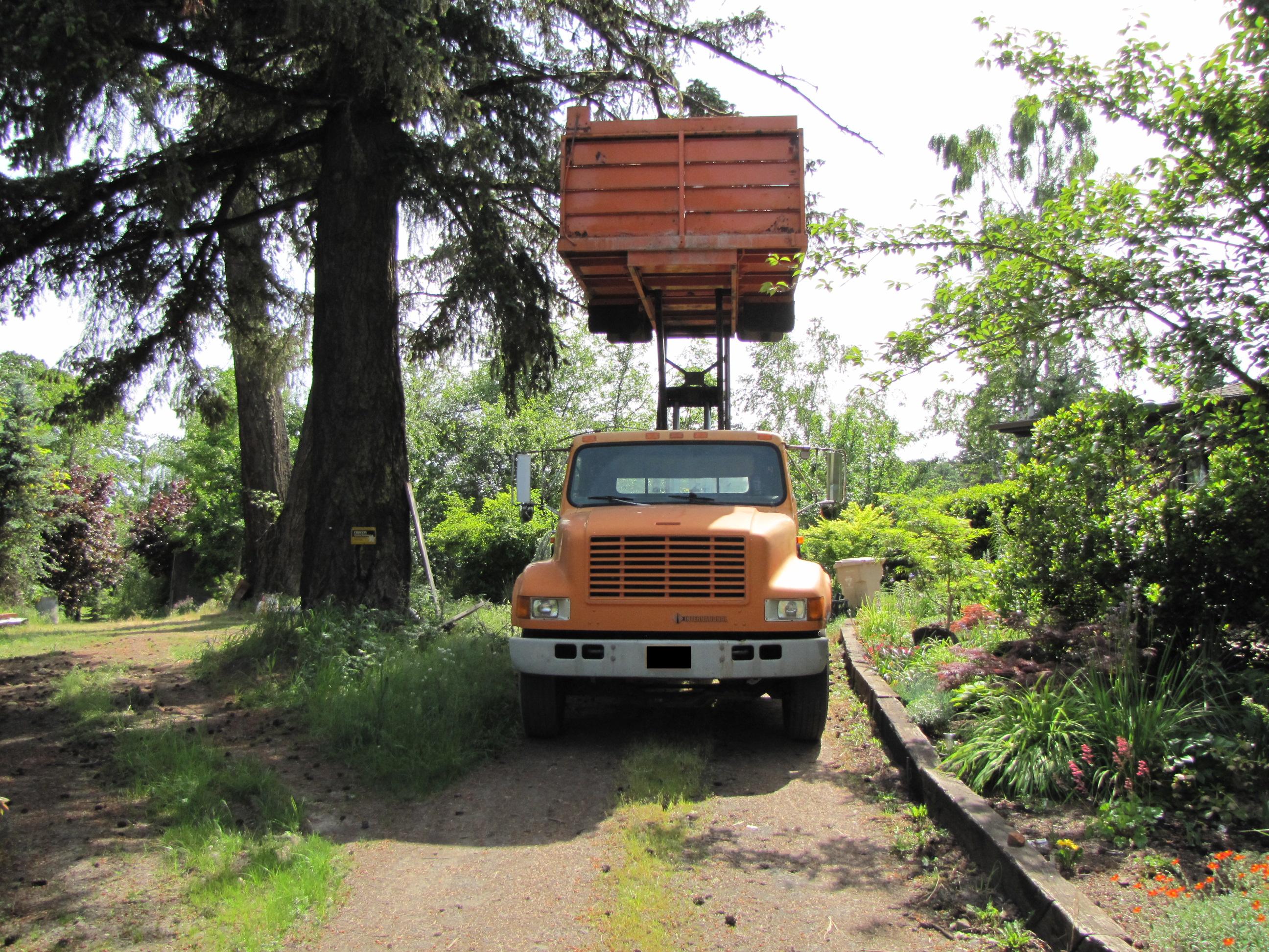

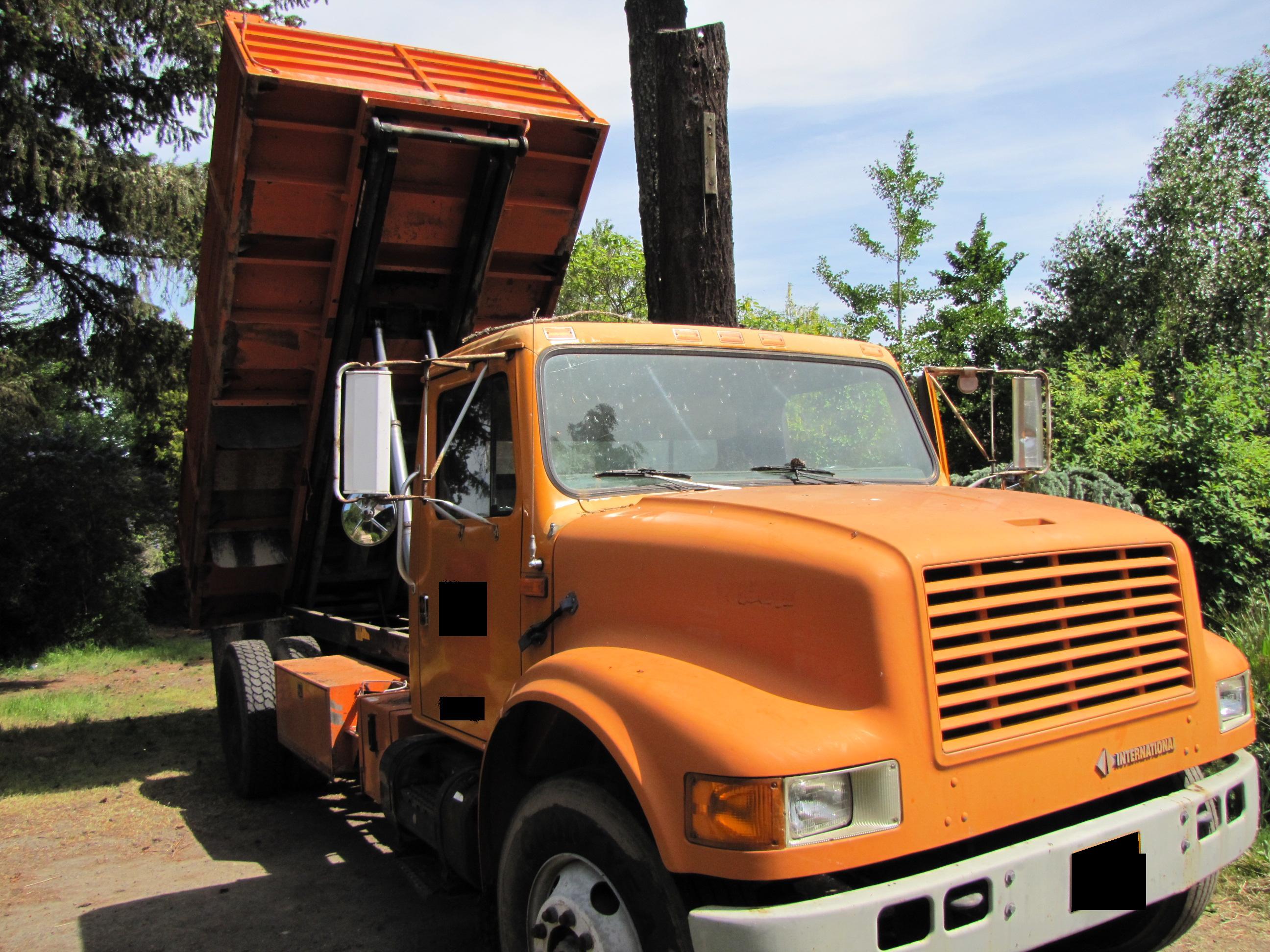

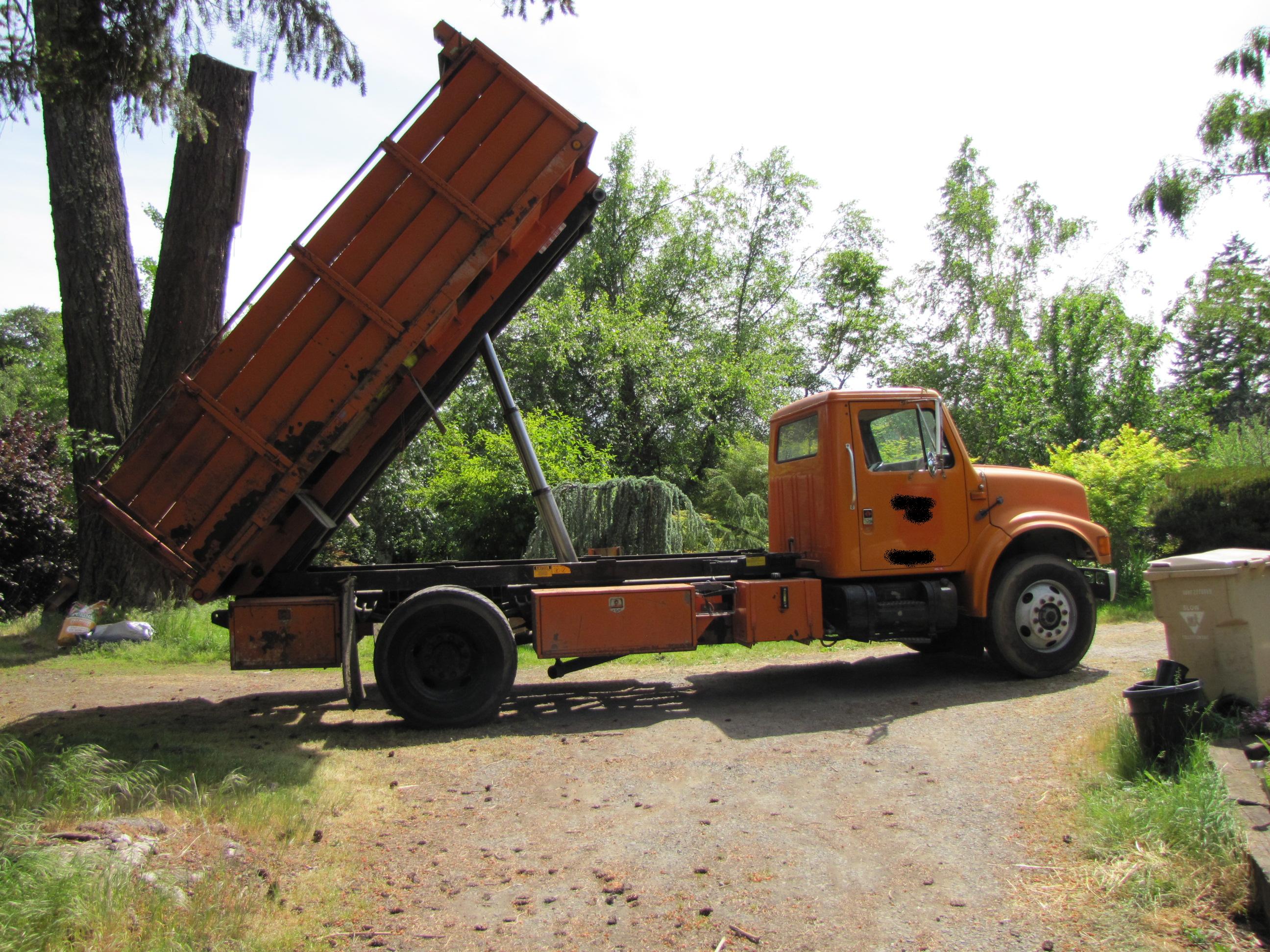

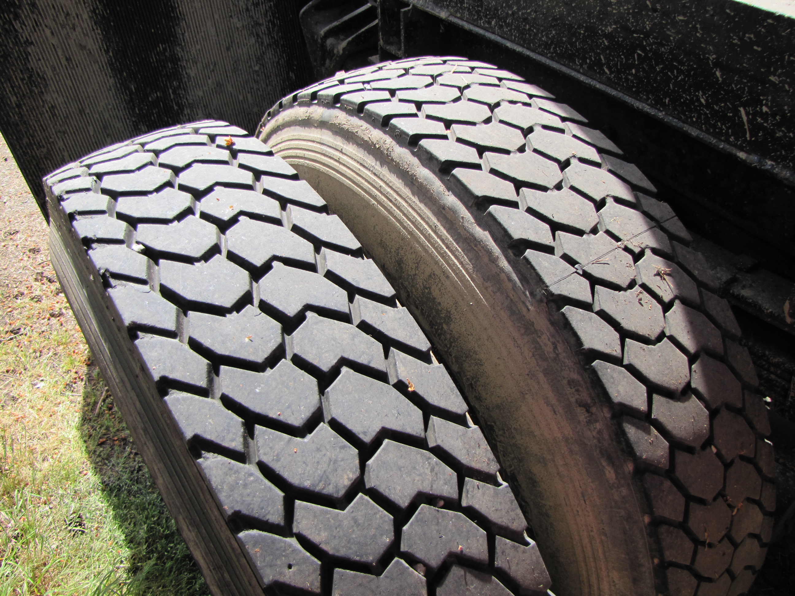

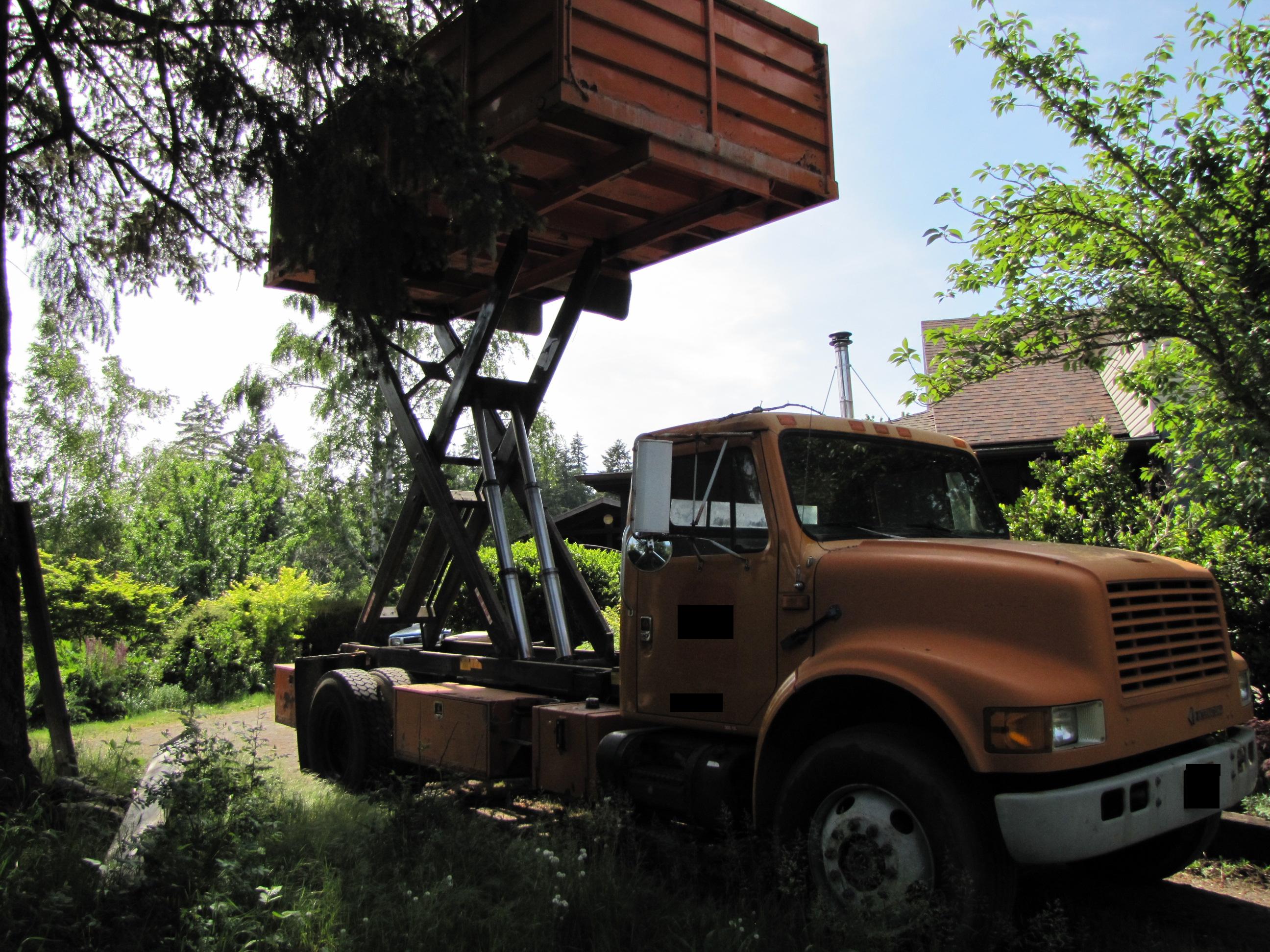

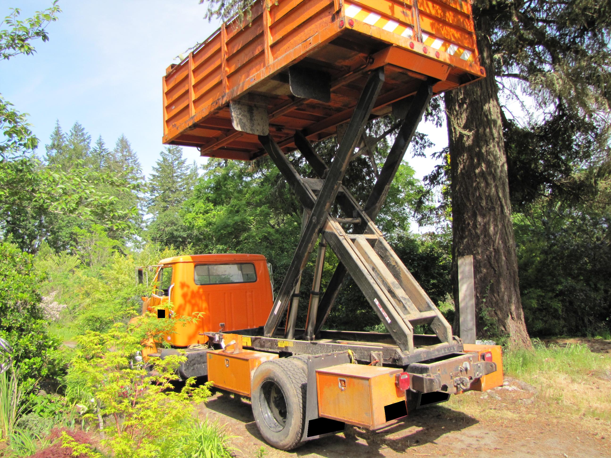

Thanks for the advice on pricing and auction. I had the truck consigned at a local equipment place for 3 months this summer...not a single bite, and no interest in my (now expired) craigslist ad....so maybe pricing is my problem. I was hoping to get at least 17k for it, but with the consignment percentage the final price was too high. I have listed it as low as 14500...but still no interest. It would be a great roofer rig i think. Here are some picts. INTtruck (2).jpgINTtruck (3).jpgINTtruck (4).jpgINTtruck (6).jpgINTtruck (7).jpgINTtruck (9).jpgINTtruck(1).jpg
