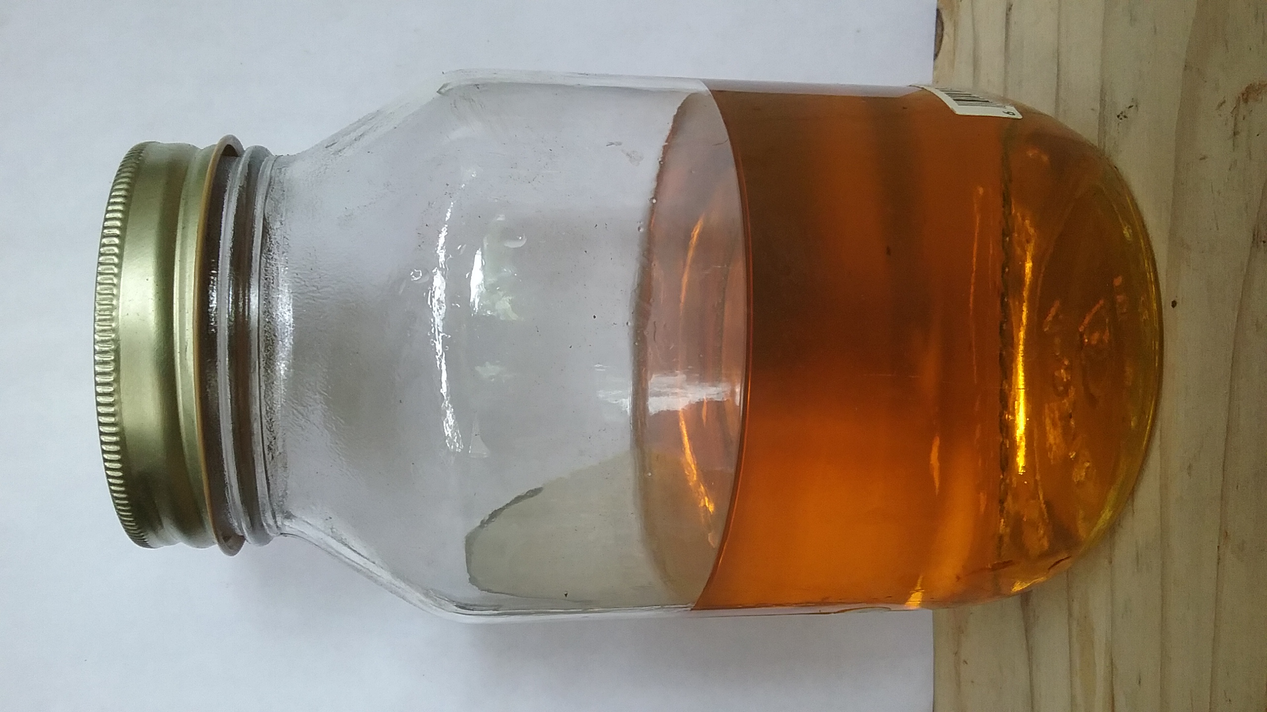

So i have a 1989 int'l with a Dt466 motor. It always fired right up no problems. Several weeks ago it fired right up. I went inside to get wallet etc came out and it had died.
Now she only cranks over fast with no indication of starting. No smoke out the exhaust. I have confirmed that the fuel shut off solenoid is working (visually saw it pull) but feel there has to be a fuel problem somewhere.
I siphoned out 10 gallons of fuel. It looks like this. 1477087692492.jpgIt is onroad fuel so i was expecting red but this color seems off.
My plan at this point is to blow the fuel lines out. Replace the fuel filters prime it and hope for the best...unless someone has better ideas.

On road fuel sort of yellow greenish fresh out of the pump and off road is red. Anyway, crack the fuel line at the lift pump to see if you have fuel there. Do a search on the DT466 lift pump for lots of on line suggestions on trouble shooting the lift pump. Once past the lift pump, see if you have fuel at the filter, the injection pump and finally to the injectors.
One big question I have is about your fuel? Are you adding something like Power Service for lubricity? Low sulfur fuel by itself is typically detrimental to the older mechanical pumps. Not sure about the DT466 though.

Thanks. yeah i always remember it backwards Red is OFF road. Got it now
I haven't added any additives. The local diesel shop said that the fuel doesn't look great. But they have seen worse and the early dt466 is pretty forgiving with crappy fuel. I'm pretty sure the lift pump is upstream of filters but need to confirm.

Without looking, I would assume that you are correct that the lift pump is before the filters. No fuel is usually pretty basic but often expensive.

So i've decided that yhe culprit is the fuel supply pump. It only puts out a tiny little trickle of fuel plus the manual primer that is associated with it is totally frozen up...so at a mimimum that will have to be replaced/repaired.
/ DT466 stopped running
So i disassembled and freed up the primer pump and put it all back together. Replaced the fuel filters. Removed 25 gallons of lousy fuel. Put in fuel treatment in whatever remained. Added 10 gallons of treated fresh fuel. Primed it and she fired right up...whew.
