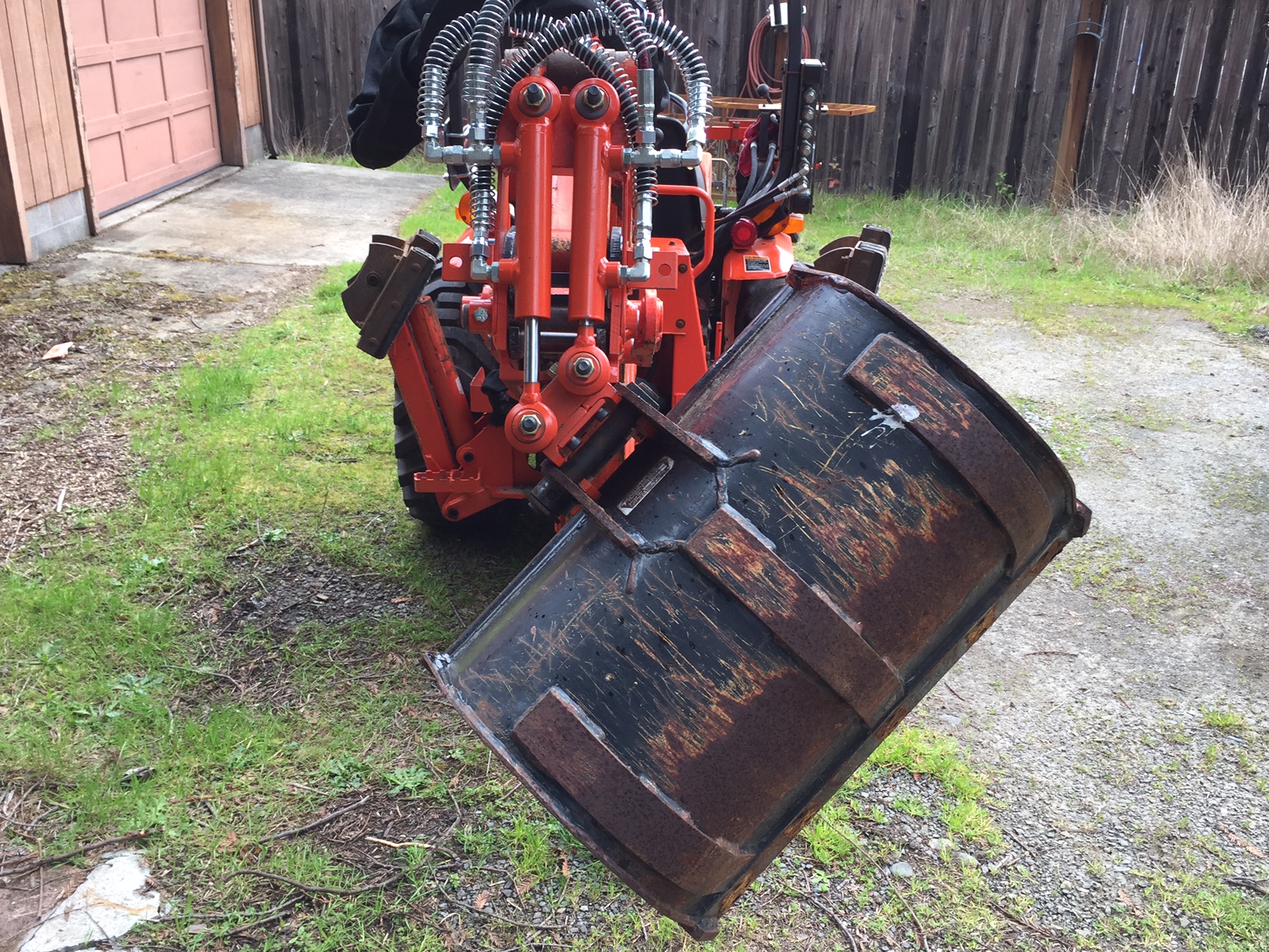

A lot of backhoes with dual swing cylinders are plumbed rod end to base end. I used that style of plumbing, but with a check valve, on my tilt coupler, which operates from one valve. The check valve keeps the bucket tilted where you put it.
   / Dual 3PH Tilt Cylinders--Plumbed In Parallel?
#18
I'm thinking that is also how the angle cylinders on a snow plow blade are plumbed and they are connected mechanically. I'm trying to understand why a check valve is required. Is it a pilot operated check valve?
   / Dual 3PH Tilt Cylinders--Plumbed In Parallel? #19
Yes it is a double pilot operated check valve. Without the check valve fluid is free to move between the two cylinders. Doesn't matter on a swinging backhoe boom. Does matter when you want to hold an angle for grading.
#20
They couldn稚 move if the valve was closed, they were hooked rod end on one to base end on the other. So as the valve was opened it would extend one and retract the other, sort of like a snow plow blade.
I think that the difference between this and the way a snow plow blade angle is connected is that there is a mechanical connection on the snow blade. This prevents the cylinders from moving until the valve is actuated.
In the case of the 3PH double tilt cylinders, I don't think connected rod ends to base ends would work. I understand that shifting the valve spool would cause the two cylinders to travel in opposite directions which is the desired effect.
What I don't understand is the situation where both cylinders would be in midstroke and you let go of the valve handle. Looks like the weight of the 3PH attachment would just cause both cylinders to "droop" as the oil transferred from the base port of one to the rod port of the other and vice versa.
Edit: Or is this another instance of where the oil from the base of a cylinder can't transfer to its rod end if there is a leaky piston seal because the rod end is less volume? It's messin' with my brain.
