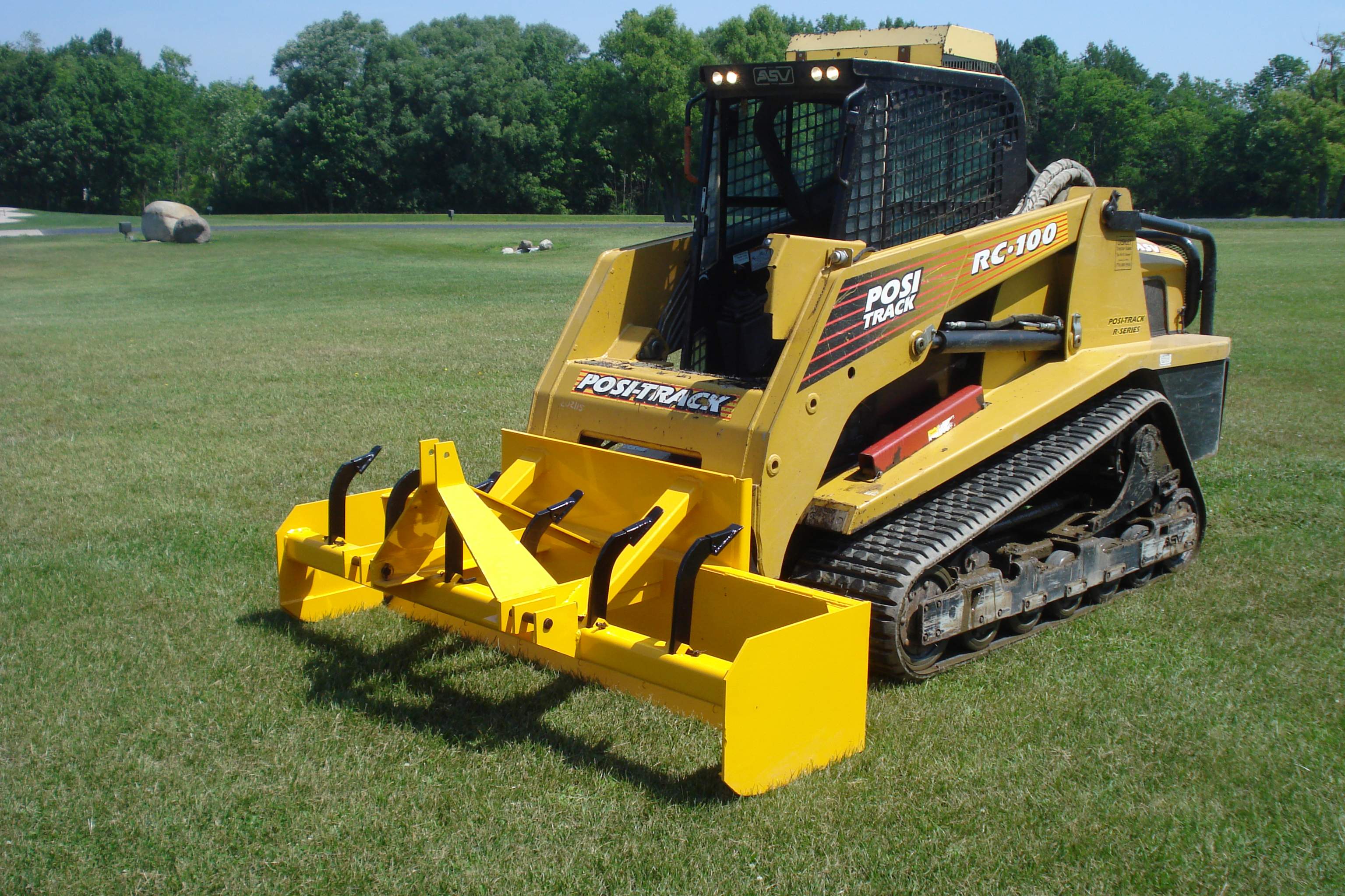

I priced one out years ago....thats why I don't have one ;) Looks like a great idea but it would have to be used almost everyday to justify the price imho...
   / Dual Dozer

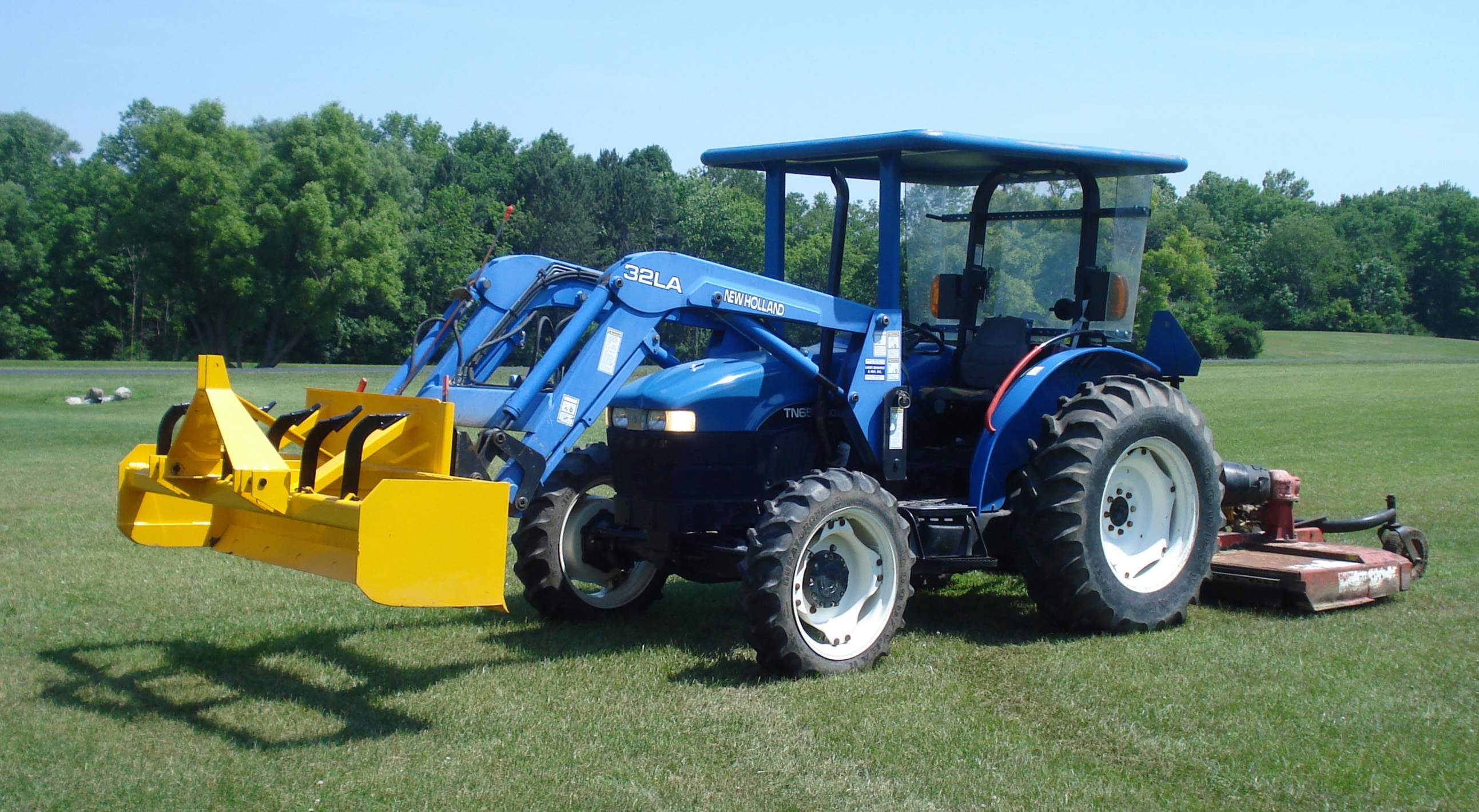

I ran across this one slightly used for about 1/3 of new so I bought it.
It has adapters for a cat-1 TPH and a skid steer quick-attach.
I'm currently in the process of hooking it up to my machines.
Looks like it will make my box scraper obsolete. :D

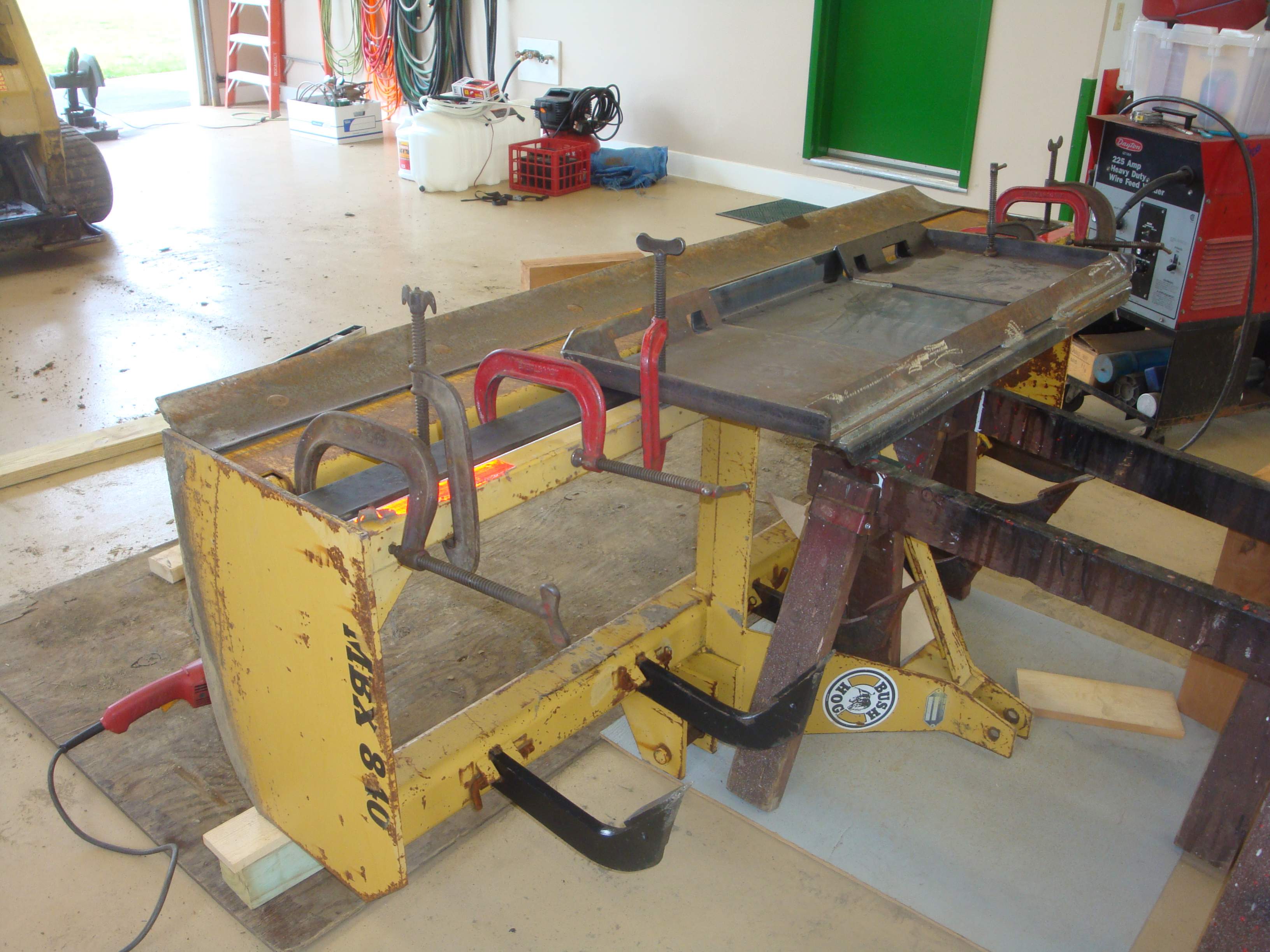

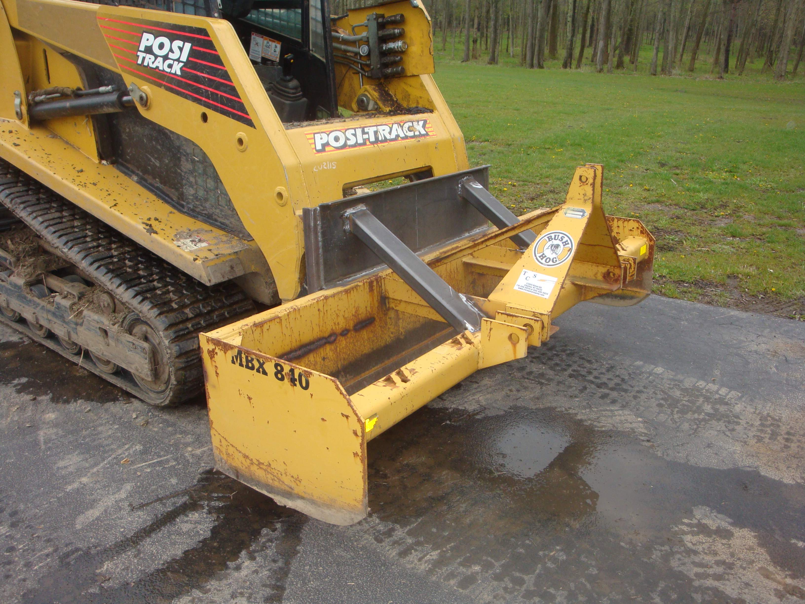

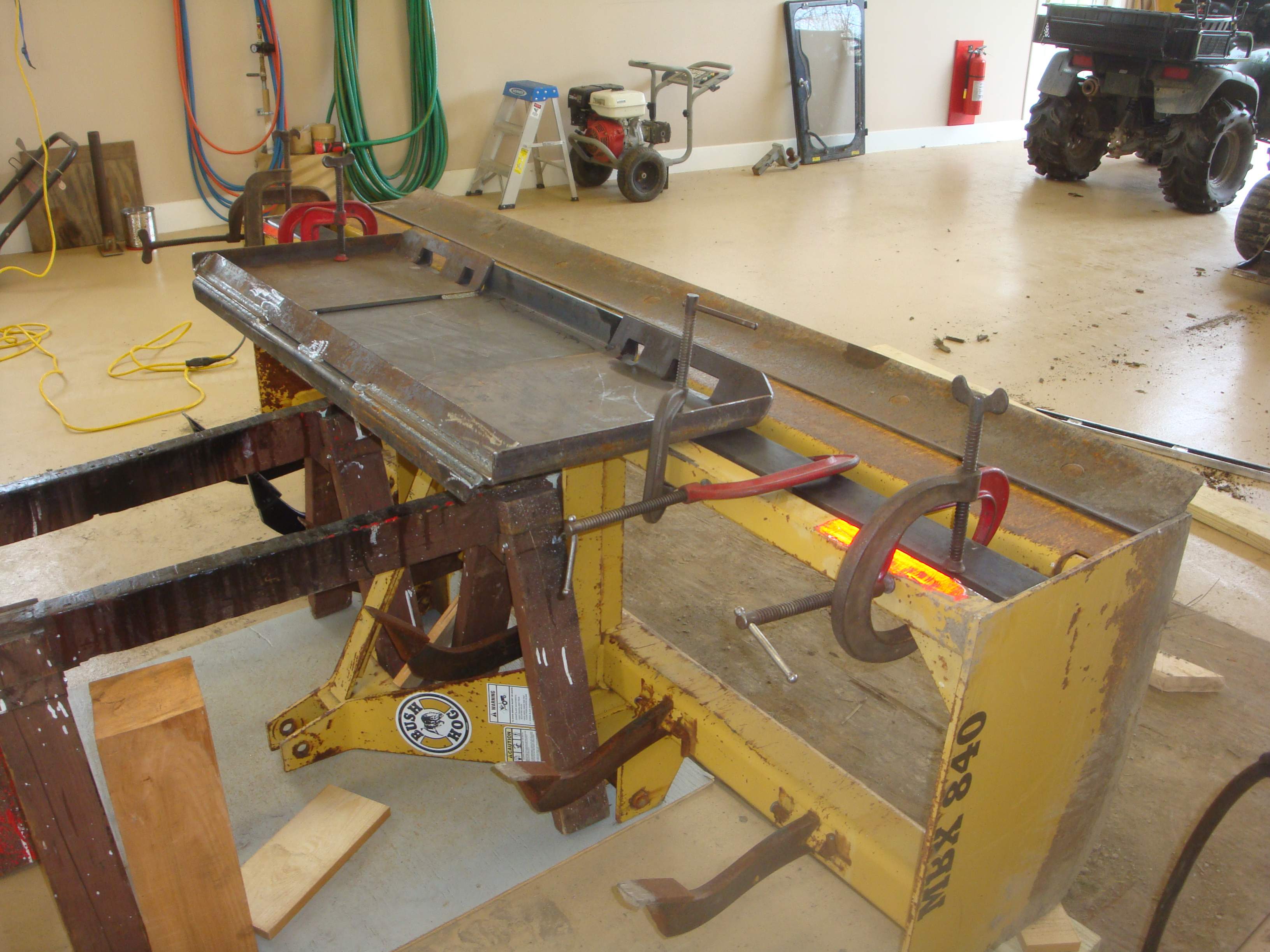

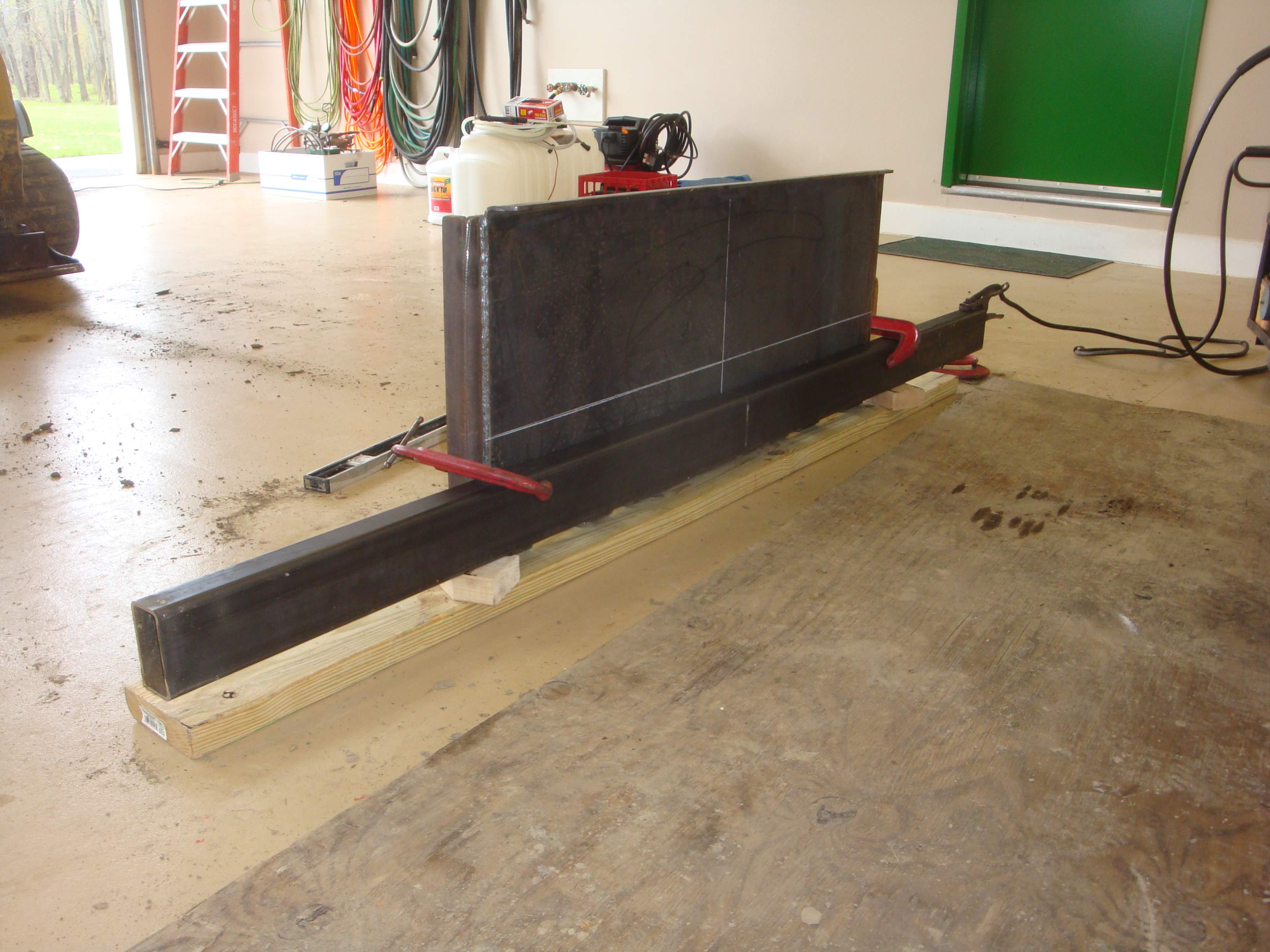

I just finished adding a quick disconnect plate on the back of my box scraper. My intentions are for grading & leveling with the skidsteer and pushing mulch into piles with the tractor. Still has the 3 point links for normal usage.
