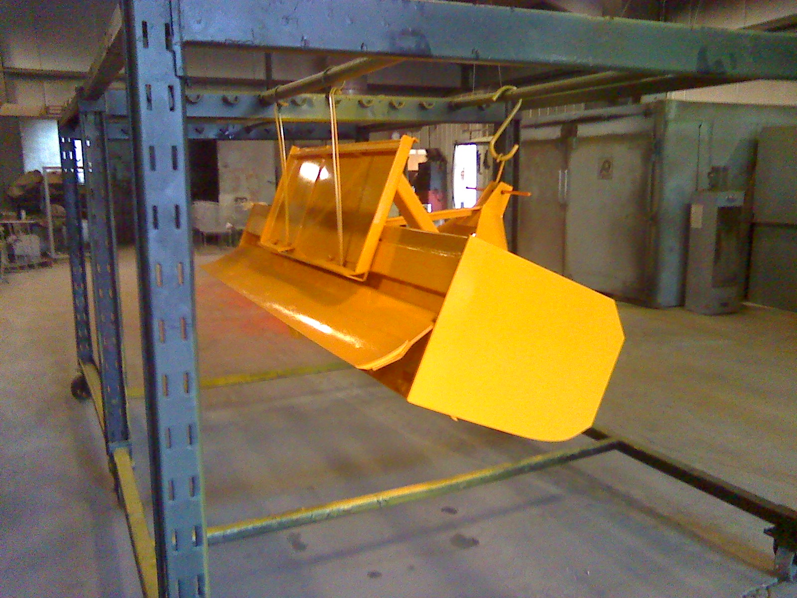

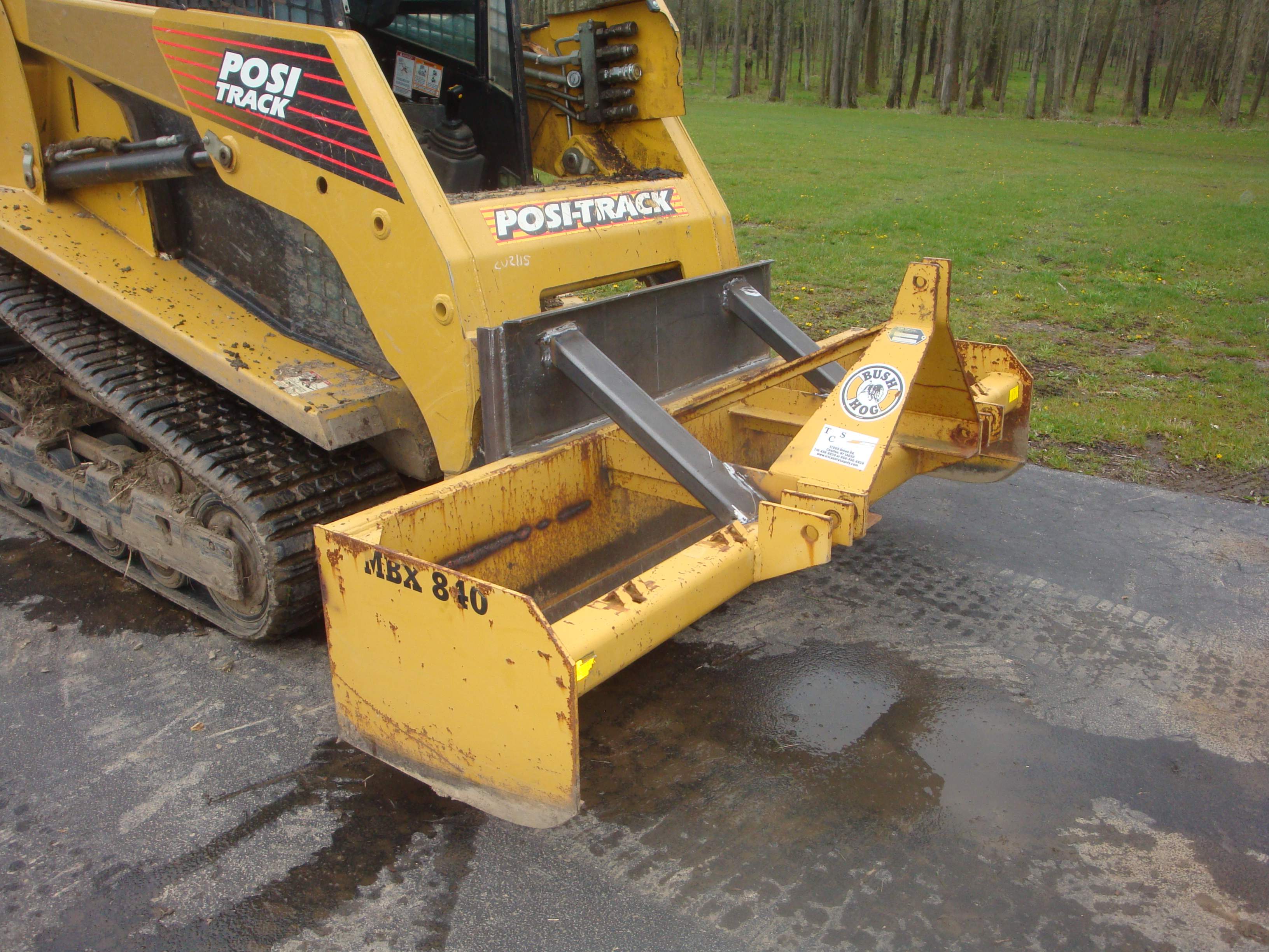

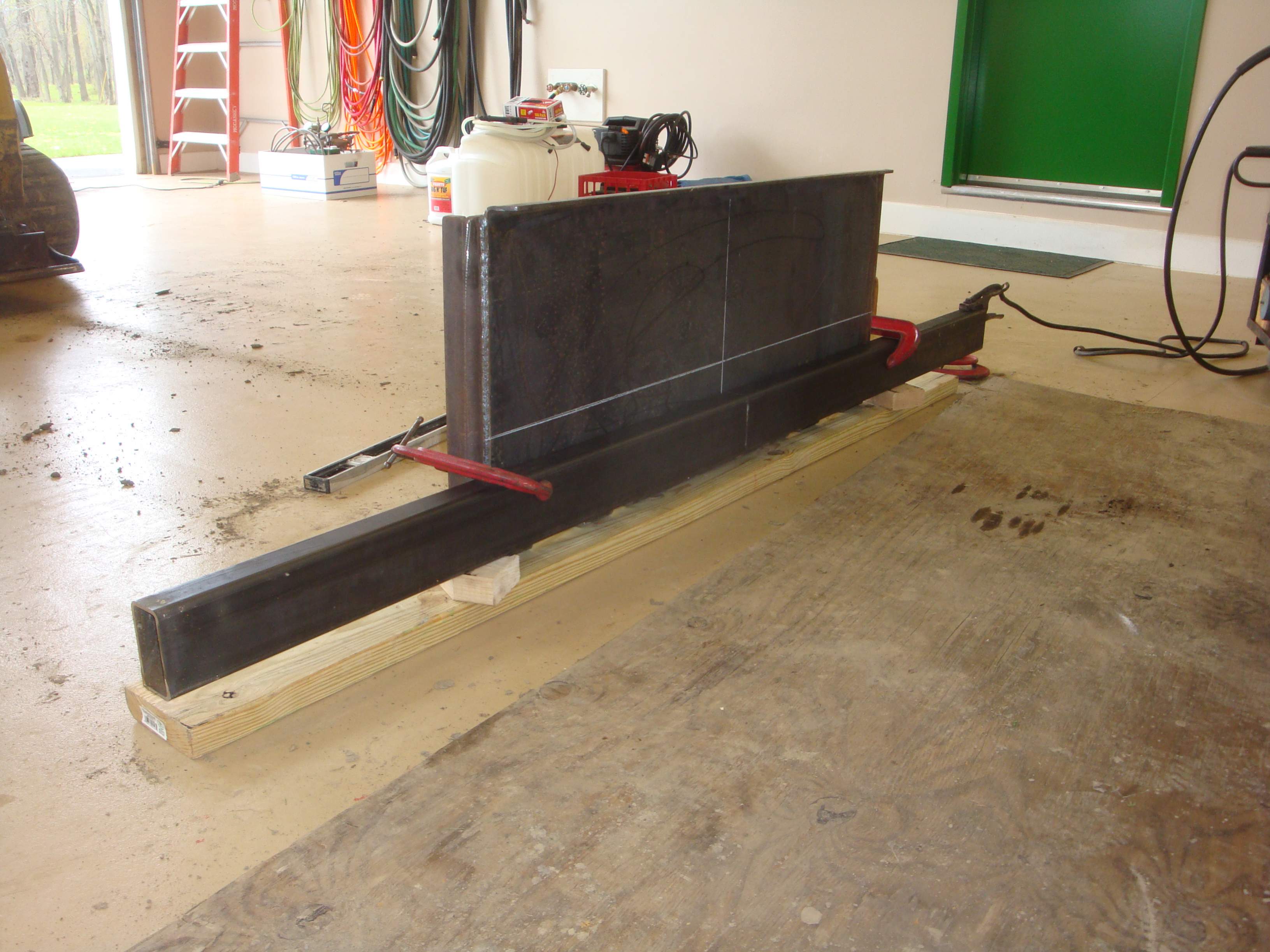

A few more fabrication pictures.
The plate needed to be mounted high allowing the rear scraper door to hinge, but that required extra diagonal braces and removing the SS door when being used. Although not necessary, I had it sandblasted & powercoated at a local shop. Overall, seems like an easy option for the OEM to offer.

That ad extra weight on that box blade for tractor use too. Most box blades are a little light. That's pretty neat indeed.
