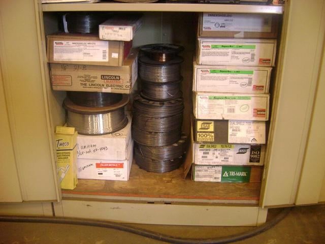

Keep the roll of wire in a sealed plastic bag, and in a warm area!

I thought about moisture in the flux but it was a new spool with intact packaging and a recent mfg date at the time, the guy that turned me onto dual shielded wire ran some in my machine without a problem. I'm wondering if my power source is varying a bit since it's on a sub panel.

I live in the Seattle area. It never gets too hot, or too cold here. Now it does rain every once in a while!:rolleyes: I keep my wire in a locker in the shop.
