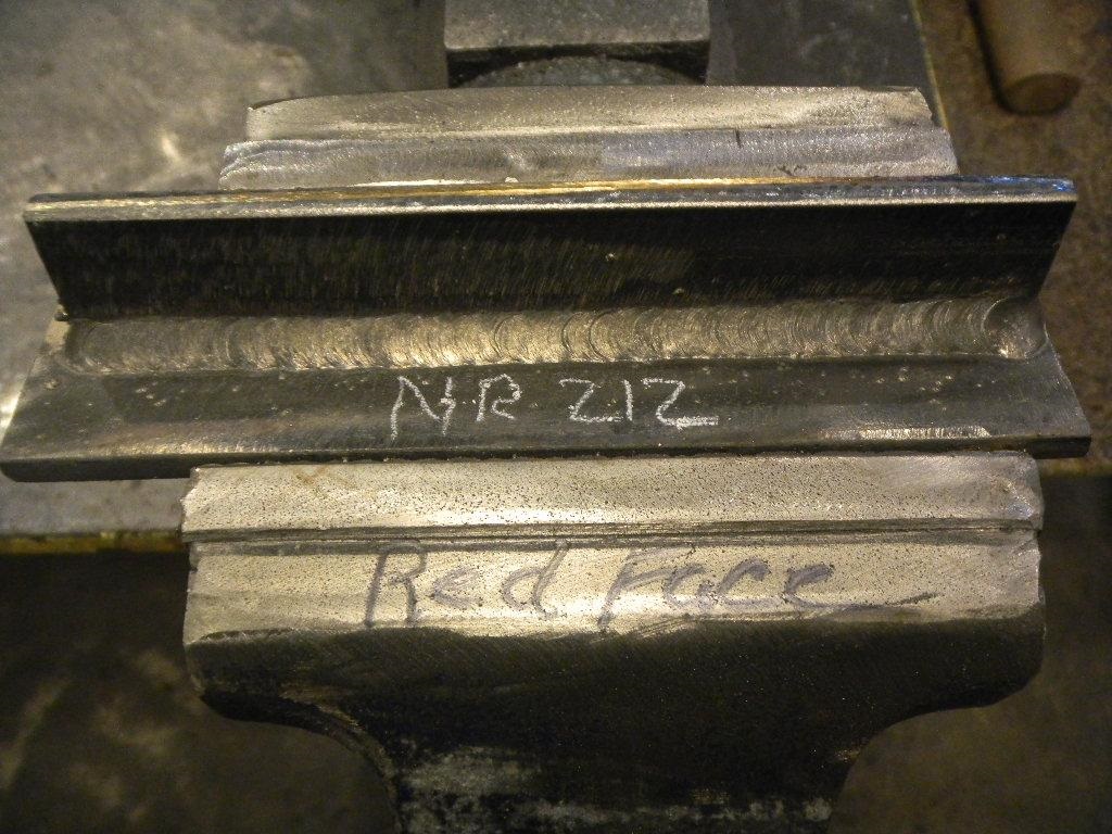

I live in the Seattle area. It never gets too hot, or too cold here. Now it does rain every once in a while!:rolleyes: I keep my wire in a locker in the shop.
