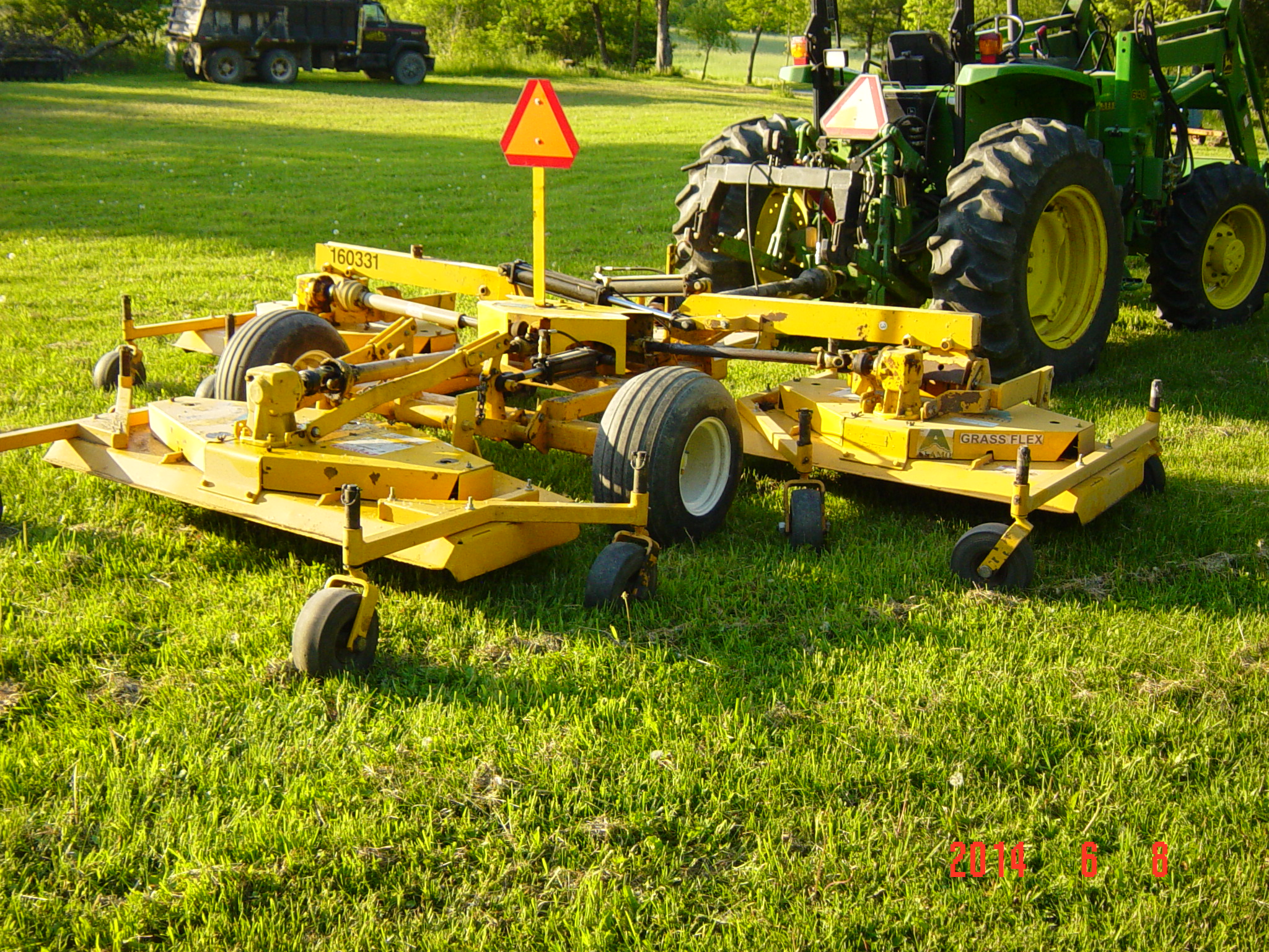

I cut a few unwanted fields once a year (in the fall when the vegetation had dried out) with this (finishing mower) and a 70 PTO hp Deere. Had to replace the wheel frames to get the mower a little higher than for turf. 70hp was maybe a litle overkill but a guy with a 50 something hp wanted to buy it, we tried it and to my surprise it was s total failure. Worked fine in light grass, and bogged down in something just a bit higher. Guy wanted to cut his horse pasture periodically. I don't even remember if the flex wing was 14 or 16 feet.

Anyway, the 2038r is pretty small for the mower. However, it handles it much better than I anticipated.
A 3 spindle brush mower takes less hp than a single spindle version.
I had to go REALLY slowly in the heavy laid over fescue. I find the heavy fescue to be much more taxing on the tractor than some taller weeds and brush.
Without a hydrostatic transmission, I don’t think there would be any way to handle this mower with 30 PTO hp.
Overall, I still think I not only finished mowing the field quicker with the 10’ flex wing than I would have with a 6’ single spindle, but I also did a much better job. The flex-wing does a much better job of ‘lifting’ the weeds up which the tires have mashed down...overall, a much better cut.
The video shows this well, including creeping along in the heavy fescue, and killing the engine on the 4” tree.
I think 40-45hp (with hydrostatic tranny) would be plenty for the Rhino in almost any condition.
The 60-65 PTO ho of the 5075e is more than necessary. I think the 5075e would handle a 12’ with ease.
...and yes, 50hp on a 14-16ft flex wing would not go well.
