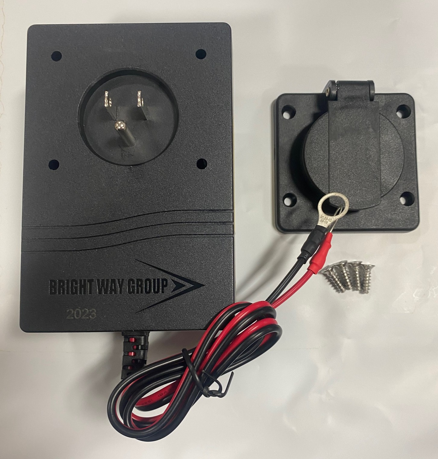

i used a 5 amp trickle charger that mounts thru face of battery box. all i do is lift the lid and plug in extension cord. takes 3 seconds after i unhook trailer. my battery is 5 yo right now....still 100% according to my midtronics tester.
My trailer had one of those and it went bad, got to where it would start charging when I plugged it in but would not fully charge the battery so I started using a different charger works fine a little inconvenient but works. I rotate a couple of deep cycle batteries the one in my trailer and the one in my gate which only has a solar charger on it and with the trees full of leaves it does not get fully charged from the solar so I rotate it out every couple months.
