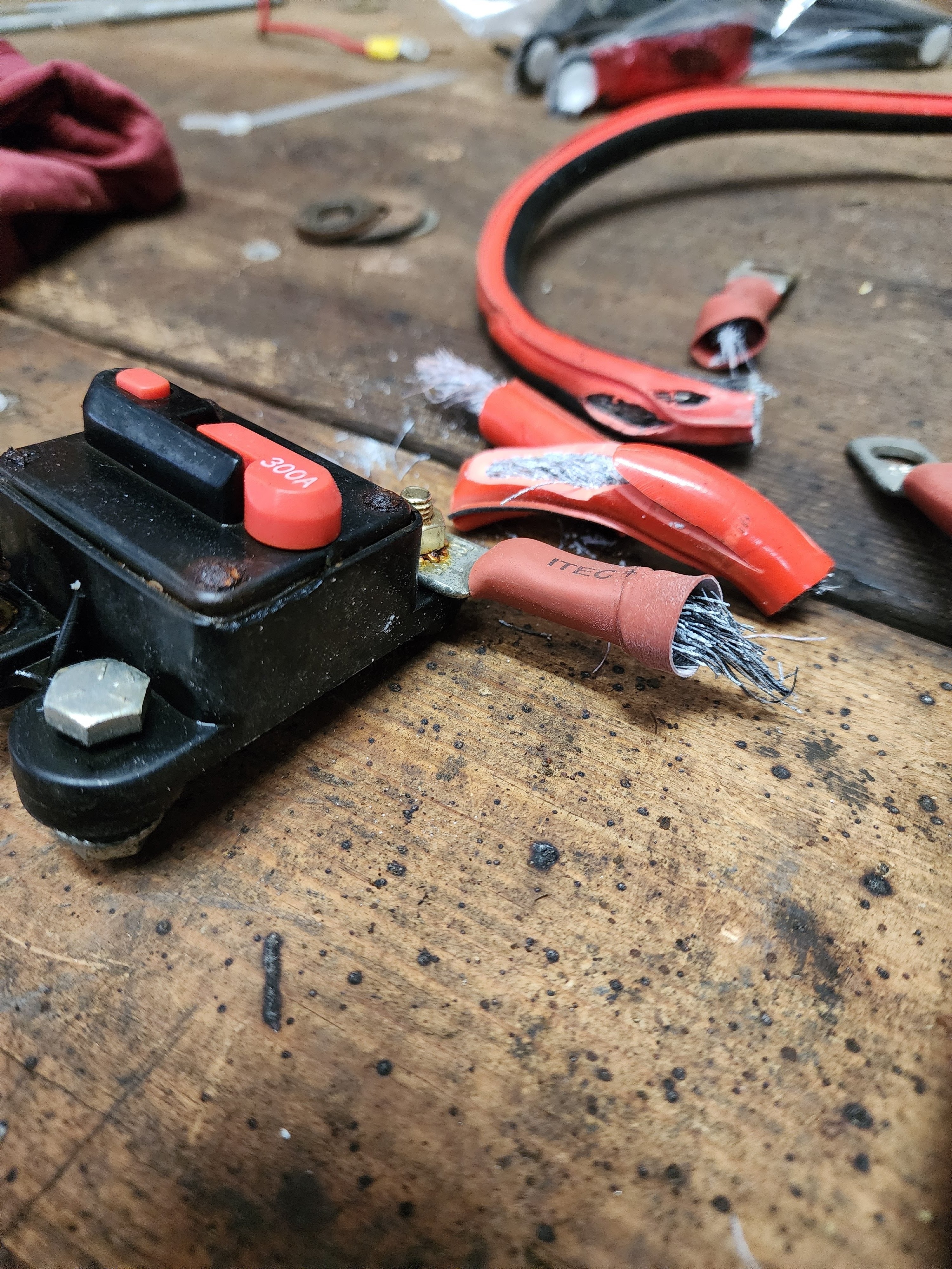

Okay guys I'm digging up an old thread, the cheap DCCA wire got me but it did last 2 years and did a good job. But I hauled some limbs and stuff and when I went to dump it would not dump the second load and when I connect to my truck with the Anderson connector it did not make a difference so after using a jump box to dump it I go home and put the battery on charge. The battery charger after about 30 minutes said the battery was bad, so I connected a different charger to it and it eventually gave the same indication, so I replaced the battery and tested the 7 way plug, yep blown fuse and I replaced that. My grandson called and his car was broke down so I connected up my tilt bed and go get him after loading his car and driving just a few miles to unload the battery was low so I connected the Anderson connector and it was no help so I used the jump box again and when I got home this is what I found.
The wires practically fell apart when I touched them and the breaker feels like it is corroded inside when I try to move the lever. This set up has worked so well for 2 years I will be trying to find something to replace it with but it will not be DCCA wire. Hope this helps someone.

Have the same green rot on mine, usually every 3-4 years. I just cut some cable off and put on new connectors. Lucky so far to have enough cable, unlucky that is shows up when I need the winch.
I have a front receiver mounted winch, figured I would also need it the back, so I ran 2 ga cable both ways with Anderson connectors on both ends and the winch. I also put an Anderson connector on a short set of heavy jumper cables so when I hook up to a dump or tilt bed with a low battery I can just hook up the cables and get the job done. I can also jump off other equipment without raising the hood.

Thanks for the reply, I trimmed off about 6 inches of the positive cable and pressed on a new lug but I had to remove the 300 amp breaker I will replace it when I figure out what I'm going to do.
LD1, I do have the relay wired in and it's been there for years, but since I have pulled other trailers I can't really say the dump trailer blew the fuse' that's just when I found it. I need to wire me up an LED light on that relay then I would know when the fuse was good. I'm thinking about replacing it with 2ga copper wire but that will be expensive. Since the connectors on the trailers are also connected to their own battery I may have to replace everything. If the set up had not worked as well as it does I would not even worry with it but it does.

Be aware that much of the “automotive” wire is now copper clad aluminum conductors. Manufacturers like it because they save weight/fuel. The aluminum wire also embrittles easily with any movement or vibration. So, they are prone to failure. Look for actual copper wire when you wire things.

I have an 08 Dodge Ram with the MegaCab. The factory wiring to the rear doors is the copper clad aluminum, and breaks in the convoluted tube between the cab, and the door. Second time they broke, I took a look at the broken ends with a magnifying glass. The center of the conductors was aluminum color, outside was copper. Replaced the wires through the tube with a high quality copper wire of the same gauge but more strands. Hasn’t broken since.
Manufacturers are cheap. The copper clad costs about half of what the all copper does.
