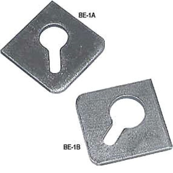

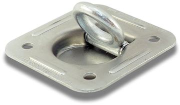

I was also thinking maybe cutting off the D rings making the floor smooth then cutting a 3" hole on the side of the dump
big enough to put a chain hook through. Then istall the D-rings on the outside of the dump trailer. Maybe a door to bolt shut when the D ring is not used.
Another option, but they still have lips but I could grind them down smooth. Only problem these have low ratings 1,600 pounds compared to 6-15K on the other.
