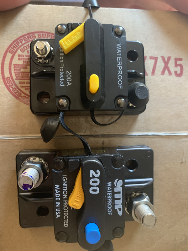

Well, as it turns out....so many of those $100-$120 "winch" kits are CCA or DCCA wires:mad:
But I did find a kit from a company out of Michigan that uses 2ga pure copper welding wire
I also got a 15" piece of 2ga with ring terminal ends so I can go from battery to a 300A breaker which I also ordered.
All in everything was ~$160 which is about the cost of the battery. I measured at the truck and trailer and 24' for the truck and 8' for the trailer was about perfect. 32' total cable.
14.5v out of the truck running and 200A load should still give me just shy of 12v. Which should be sufficient to run the pump. But I think I am gonna leave the battery in the circuit to let it help whatever it can. It may come back to life when I actually have sufficient power back there to keep it charged. But I havent decided yet. I guess I wont decide until I install it and see how it works both ways.

The ends were crimped and not soldered, on the kit. They corroded and I had to cut the corroded part out. I then had all of the connections soldered. My setup stayed connected, quite a while and was exposed to a lot of rain. I also cut the ends a bit shorter and built a jumper, so I could stow them, easier.
The DCCA has been fine. When I bought the kit, I couldn’t afford to build it with copper. That would be better, but not enough to justify the cost difference. Doing it, again, I would solder it, right from the start.
The breakers are awesome. I have never had an issue, in that regard. They do their job and are robust enough to hold the current, even during hard pulls.
