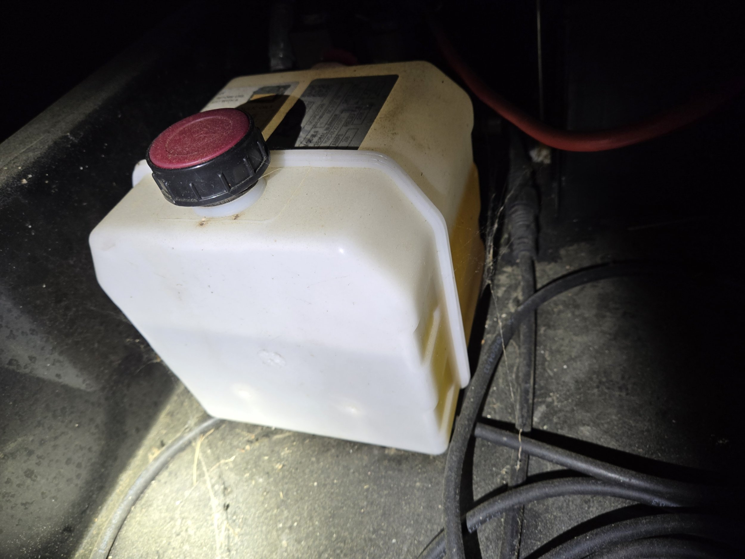

yea your overthinking it, I just ran mine through a cycle, it barely moved a inch in the tank, its a kti on a 4.5 x8 dump.
its a bit over half full

Maybe there's a way to dipstick it when it's down with a curved wire.
Could just raise it full up, and note that it doesn't starve. (or maybe it does?)
Look in the tank, is there inches of volume? If yes, add an inch and you're even gooder than when it "didn't starve".
