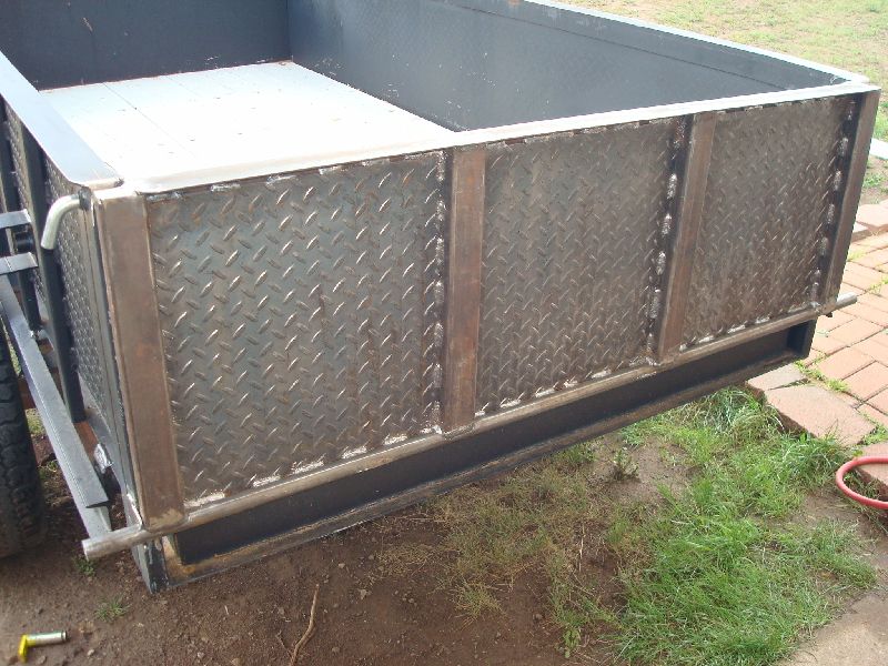

Fantastic job.:D :D :D Is there a tailgate in your future? I'd be interested in your design.
It's been 3 years since I "finished" my dump trailer now it finally has a tailgate, better late than never right?
The plan is to have it operate as a dump gate and tailgate. In dump mode it will be hydraulically controlled. In tailgate mode it will be manually operated. First was to draw up basic operation of the gate in hydraulic mode to identify placement of the cylinders.
This is the basic concept I started with:
One gate shown in three positions, closed, dump mode, tailgate mode.
Larry

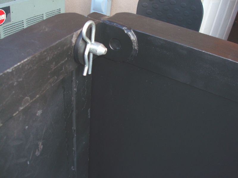

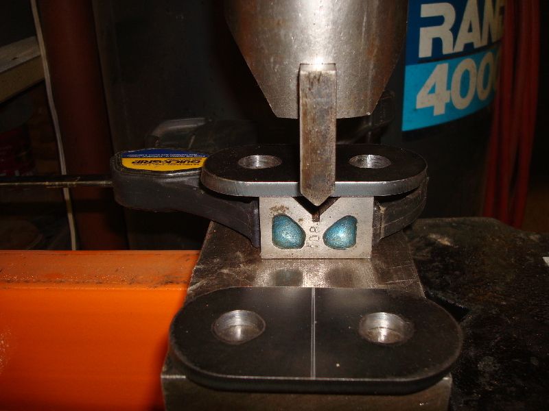

First order of business was to make hinges for the top of the gate.
I made some CNC plasma cut parts then bent them 90* on my H/F 20 ton press with the metal bending anvil I made for my landscape rake build. After that it was on to making two mounts for the cylinders.
I'm always looking for new ways to lock hinge pins so they don't rotate with the cylinder and came up with this idea:
Larry

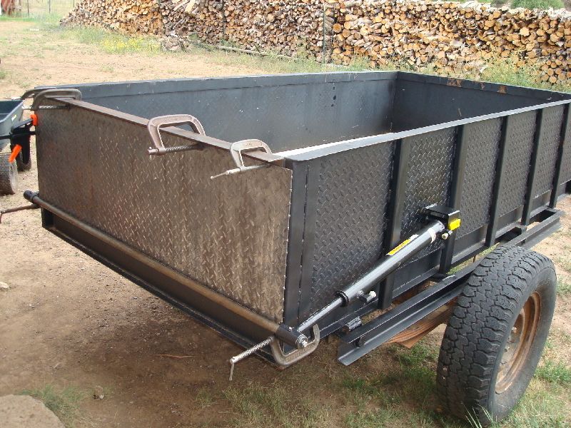

I managed to complete the tail gate fabrication in a day. This is what it looks like after all the welds cooled off:
Next was to design and plasma cut a curvaceous hinge bracket. That component is key in getting the gate to operate as both a tailgate and a dump gate. In the first pic on the left is the a-cad drawing, on the right the real live part that I plasma cut:
Here the hinge bracket is fitted and welded into position. Notice the welded caps on the end of the cylinder cross tube, those further aid in keeping the cylinder and gate in alignment
Larry
   / Dump Trailer - start to finish
#58
After a paint job, cylinders installed and a close up of the top hinge bracket used for dump mode:
Larry
