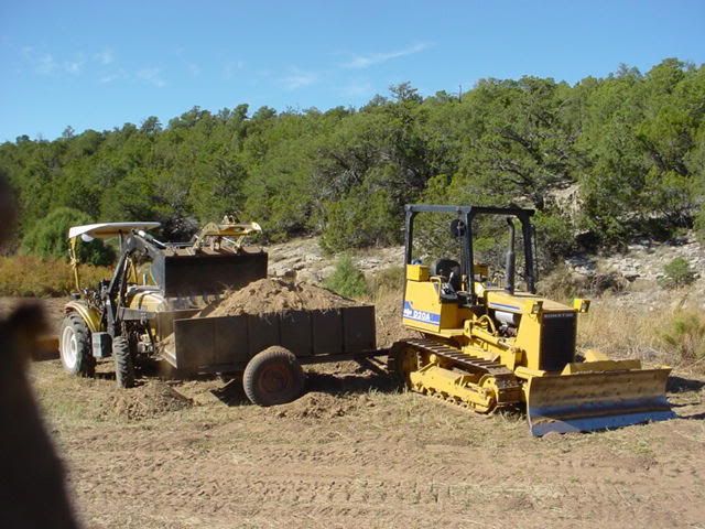

Yo Bob,
Thanks man, below are a couple of "overloaded" Pics of the trailer in action. First three are stump hauling, and of course I use the FEL to stack it as high as possible then use down pressure to pack it.
These are firewood hauling. My wife just love's the dump trailer overloaded with logs, see the smile on her face while she's splitting them? ;)
And of course loaded with dirt piled just as high as I can get it:
Notice all the above pics the tailgate is not installed? Now that I know this trailer will hold up to my use, that's when I decided to add the tailgate.

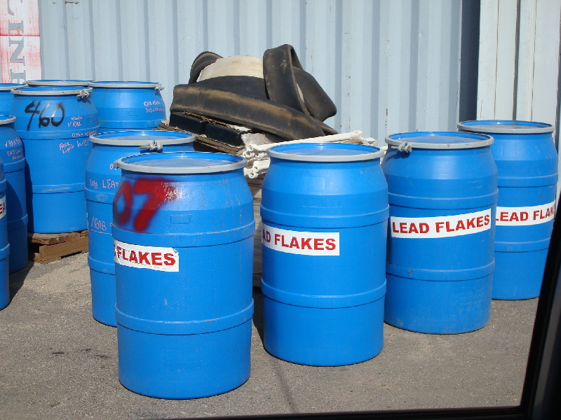

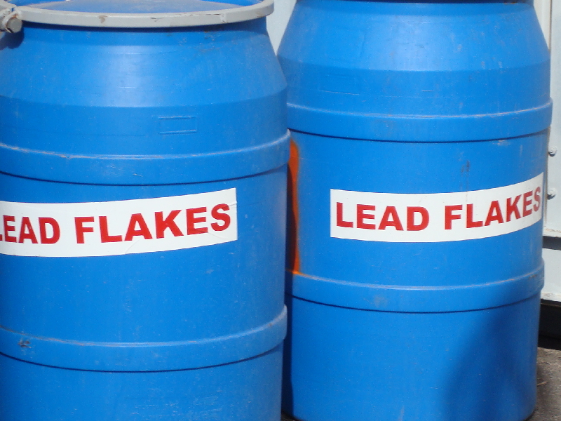

Bob,
I don't have any lead bricks or wet cement to haul around and dump, but how about these barrels of lead flakes? does that count?

The only thing I would say is that the rear corners look like a potential weak area. It wouldn't take much to make mincemeat out of your precision gate assembly should some idjit mistakenly twink a corner inadvertently.
If you go by a model such as the good old Army M150 (or is it 105) trailers, they all have an external gusset that braces the sides. I'm sure you've though of this, but I just wanted to put that out there as a suggestion. My experience is that no matter how nice you make something it will get messed up with use.

o2,
Thanks for the gusset idea. I think I have a good understanding what your referring to. We shall see how this new "precision" (thank you very much) :D tailgate holds up over the long haul. You may have noticed from the above pictures, so far I've already used the heck out of this trailer. If I somehow manage to tweak the tailgate, then back to the drawing board for sure with the "o2batsea plan B" gusset reinforcement idea. I'm pretty sure though that if I tweak anything while hauling it with the dozer, the entire trailer will be a piece of scrap :eek:. At that point fixing the tailgate might be the least of my worries. This trailer was made from scrap to begin with, so it wouldn't be a total loss right?
