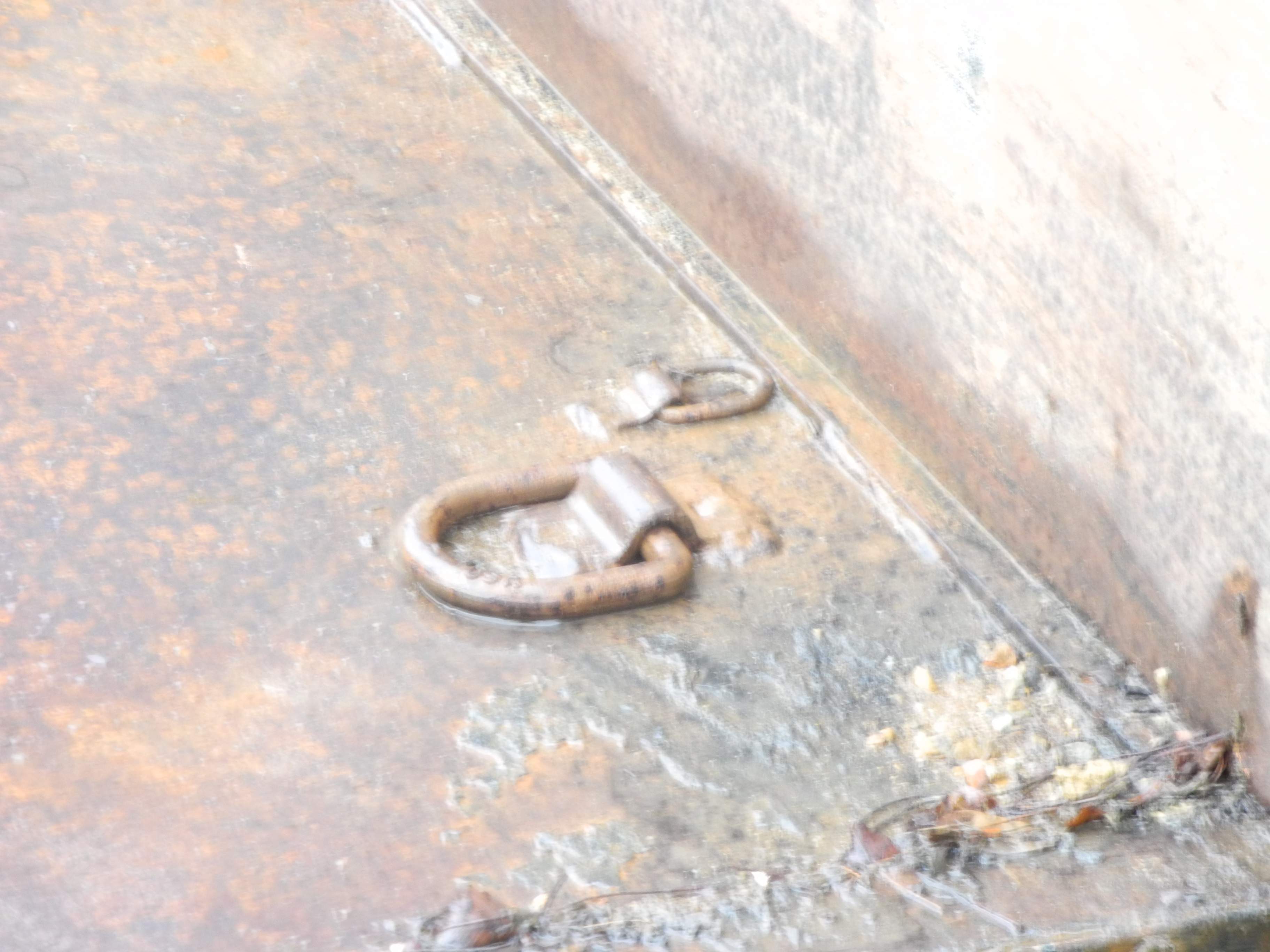

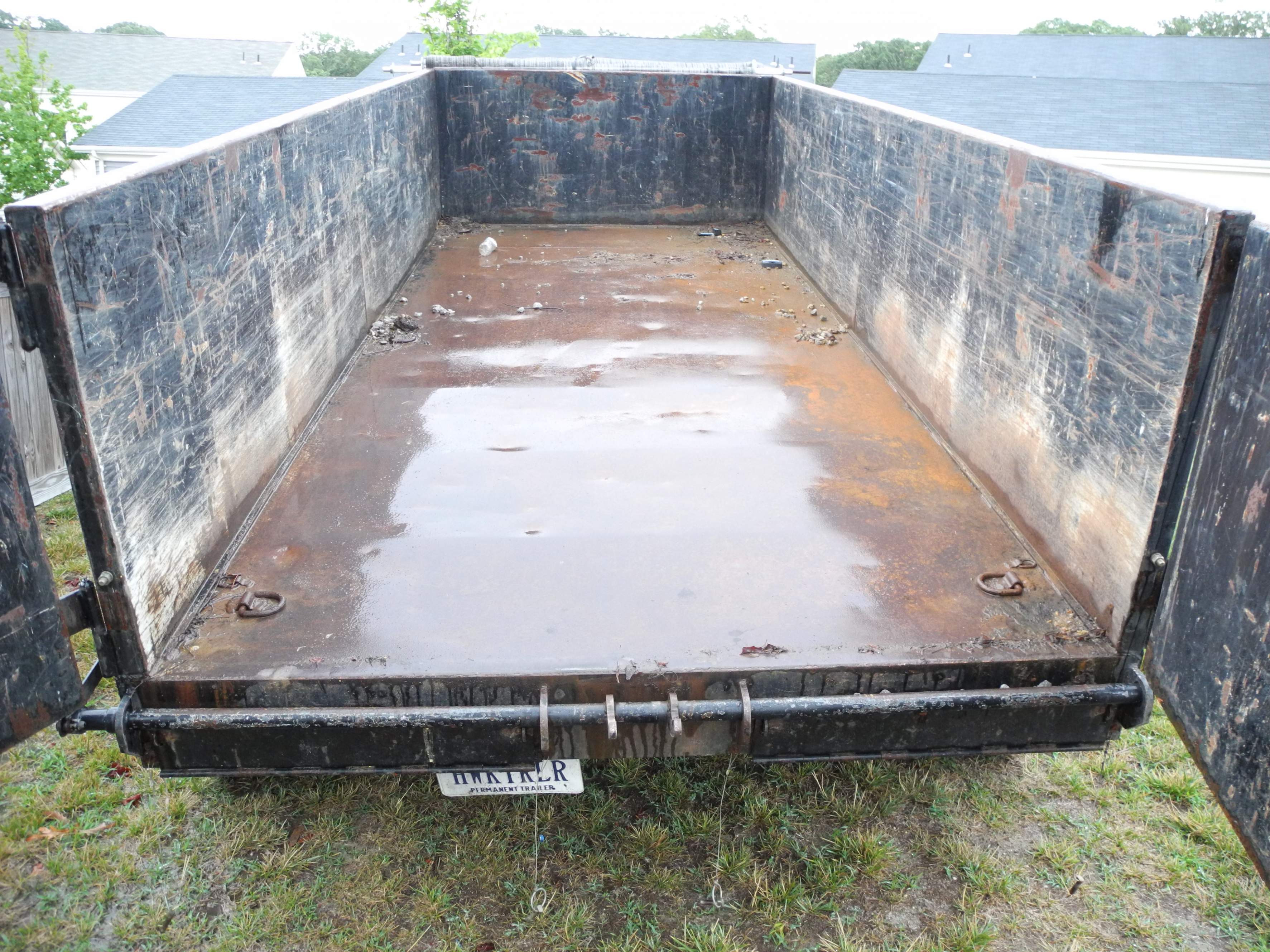

Thanks for the input guys and for the video Hawk. Dump trailer it is! I'll make sure to get some of those D rings for ties down points.
GL,
Here are some pictures of the D-rings I had the dealer install.
You can't see the ones at the top all that well, but there are two at the top, two in the in middle, and two at the rear of the trailer.
Hawk
