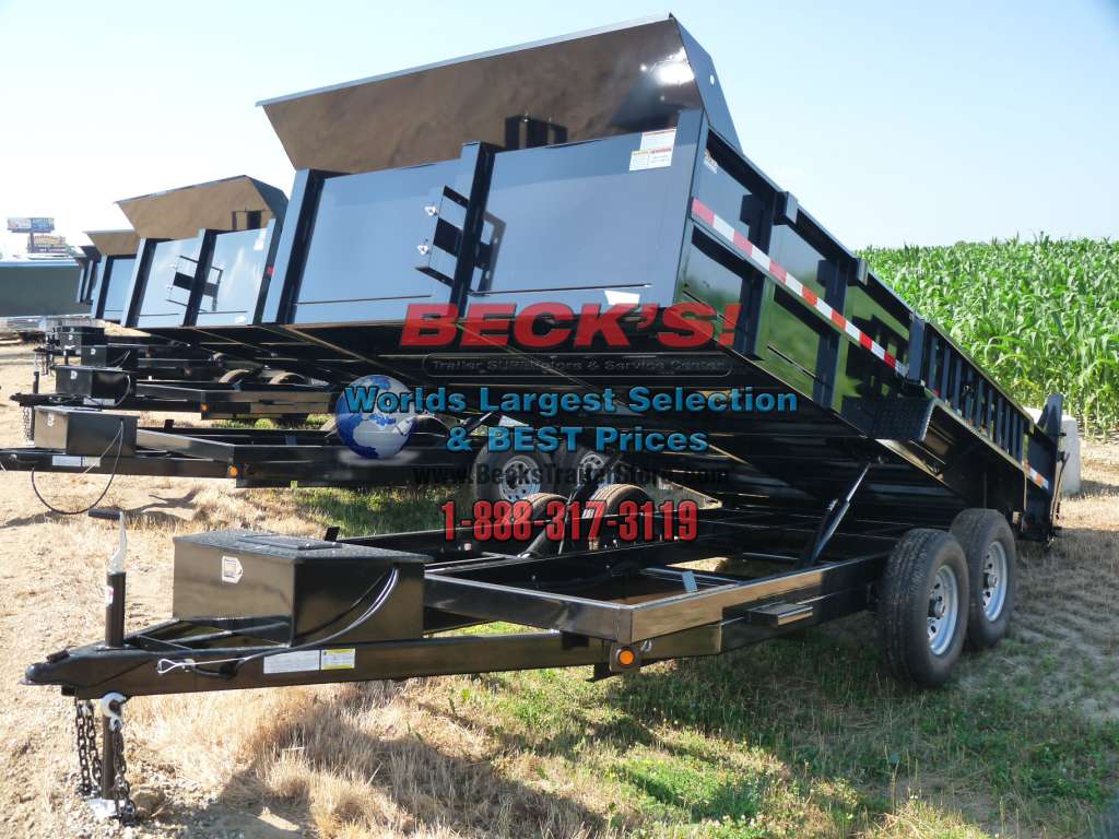

What do you guys think of this one?

That is a nice looking F-150. I have always been partial although I do not own one now, last was a 07 Supercrew FX4 I sold in 08 to get my Nissan Titan. Titan pulls a little better and is a better off road machine but thats it. The F-150 was so much more spacious, better riding, and just overall refined.
As for the dump trailer that looks like a nice one but on major issue I see with any dump used to haul equipment also is the weight. 4,000# off the payload is quite a hit for a 1/2 ton truck. Not a big deal if you have a diesel 1 ton but with only 5,500# of legal payload I could not get my 28HP Jinma with the FEL and a implement on the 3 point on legally. It weighs 5,600# like that and is not that big of a tractor but I do have rear wheel weights and the tires filled. In comparison my 18' car hauler is only 1,400# empty.
View attachment 274498View attachment 274499

This is the same trailer I have, so far a good unit. I have pulled it with my super crew, same truck as yours and it did good. DO NOT try to pull it with out brakes. Also do not load it to capacity and try to use the f-150, it gave my F250 diesel a work out, so just a FYI. CJ

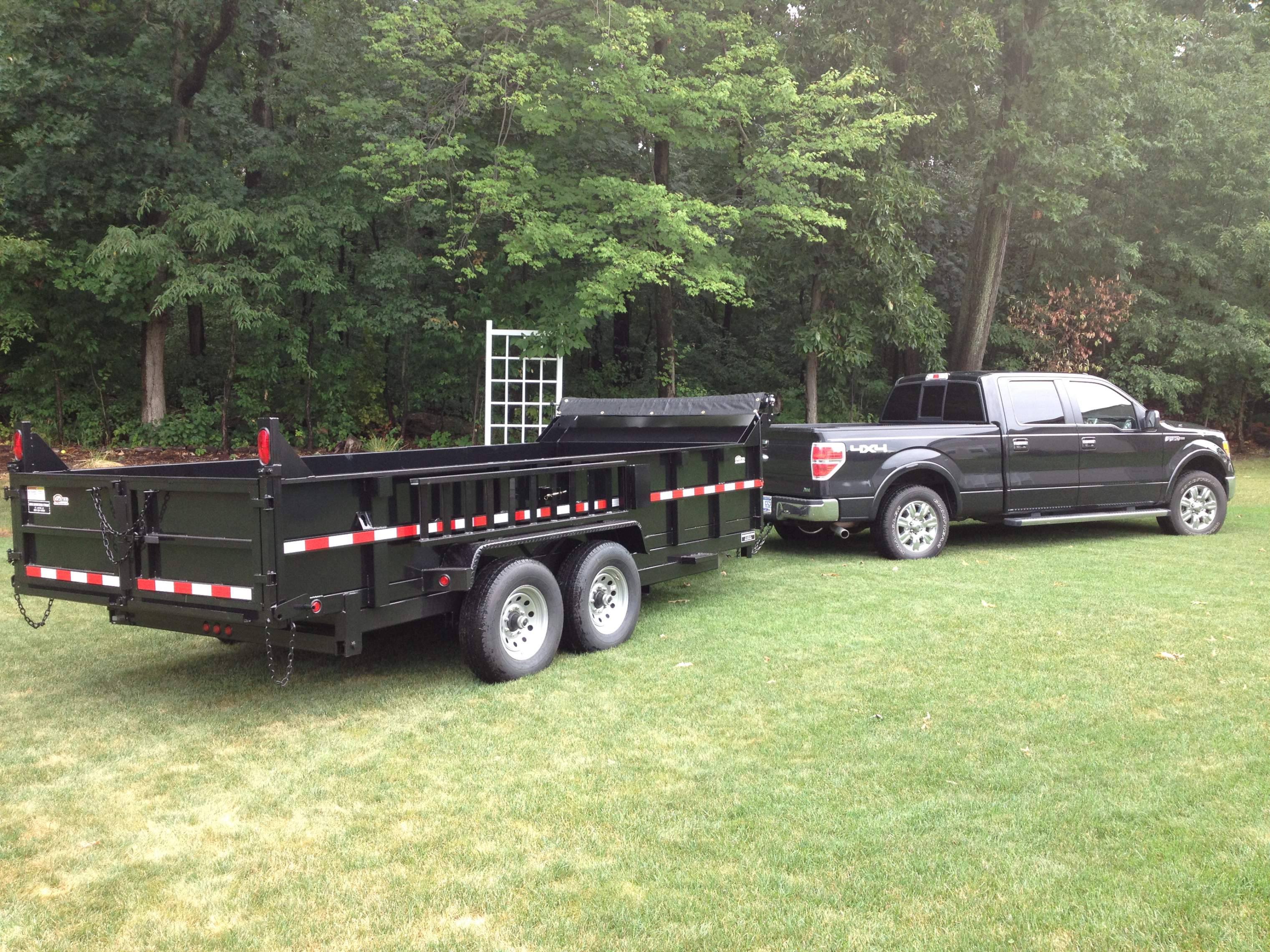

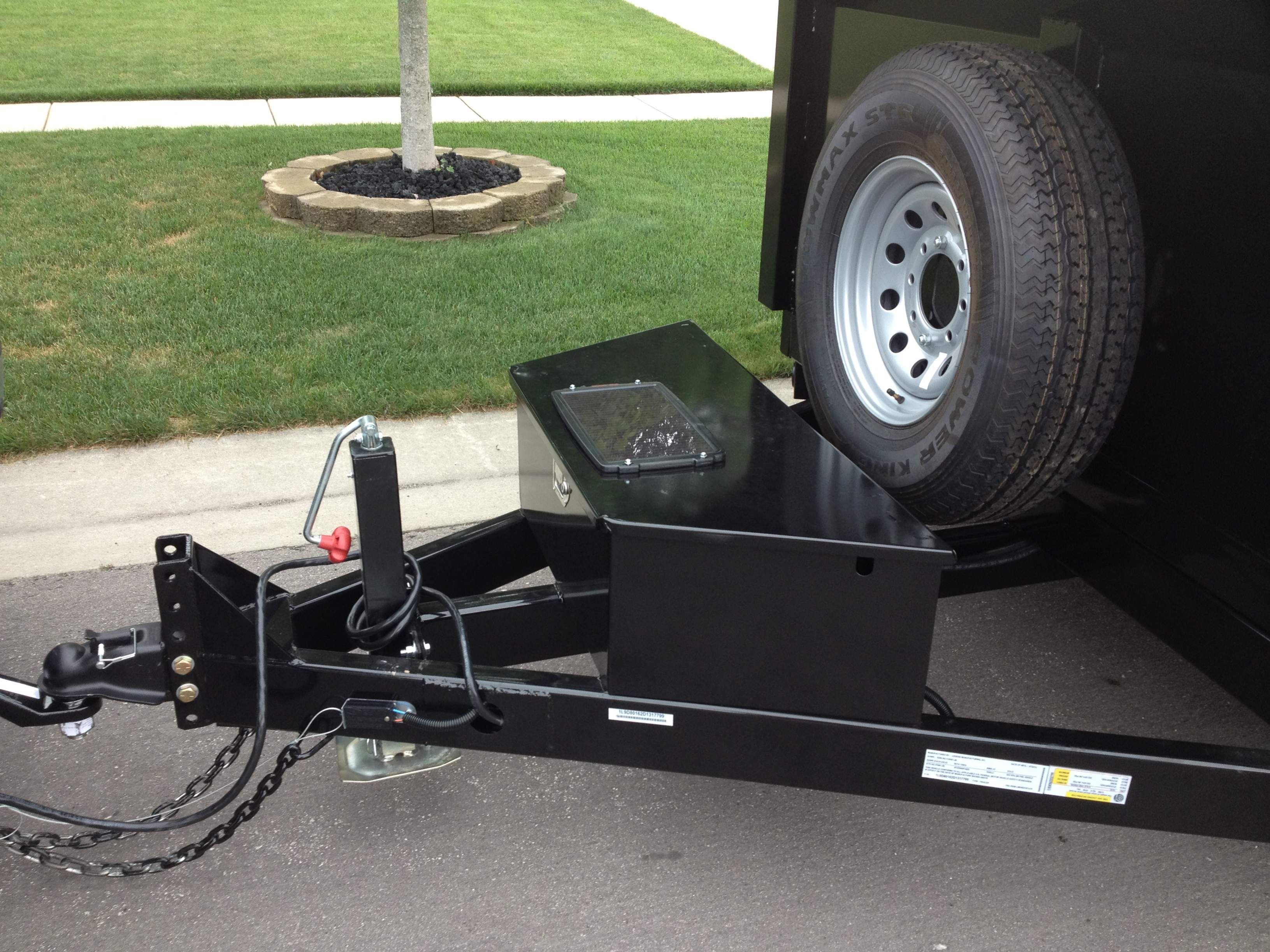

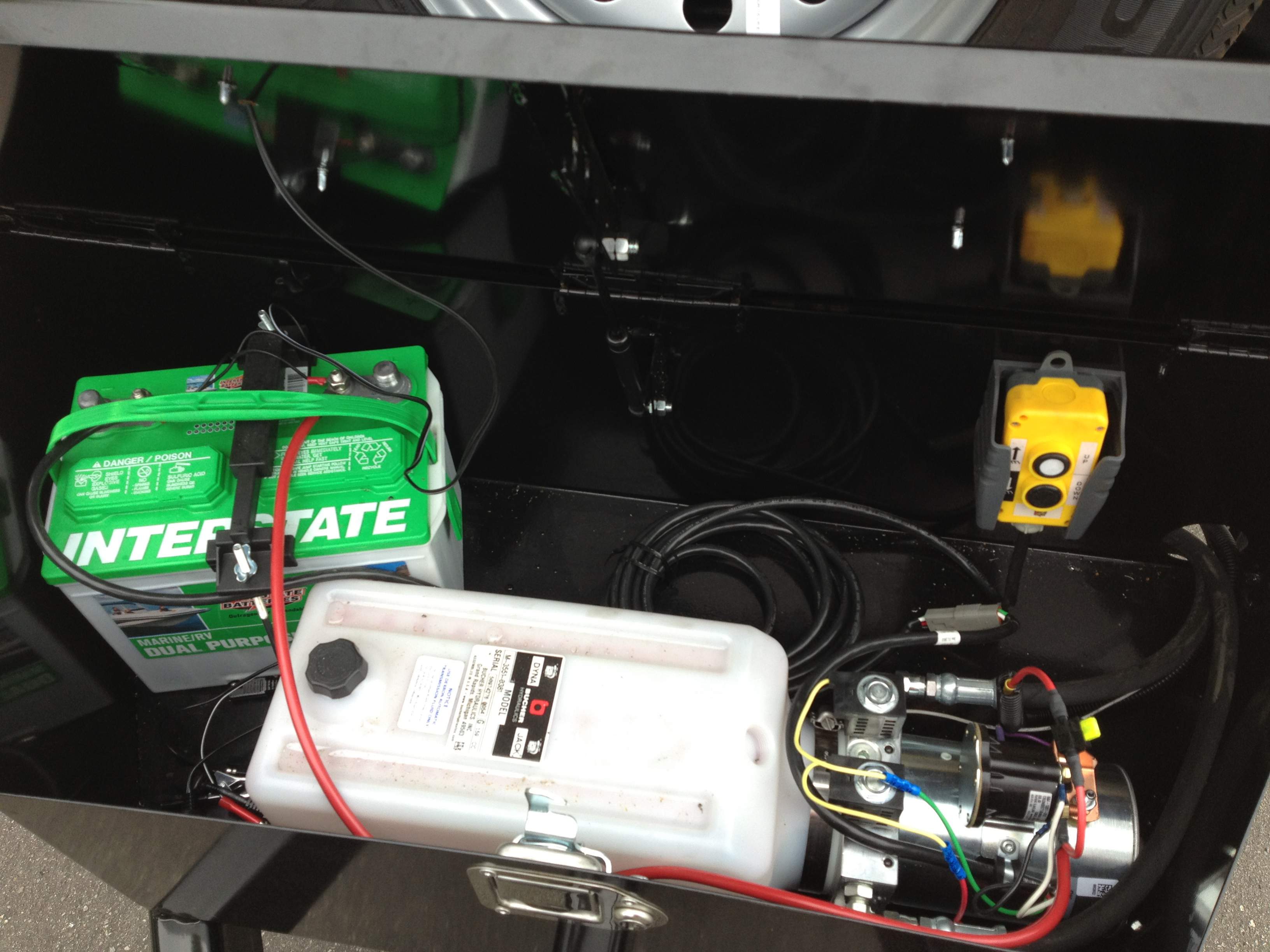

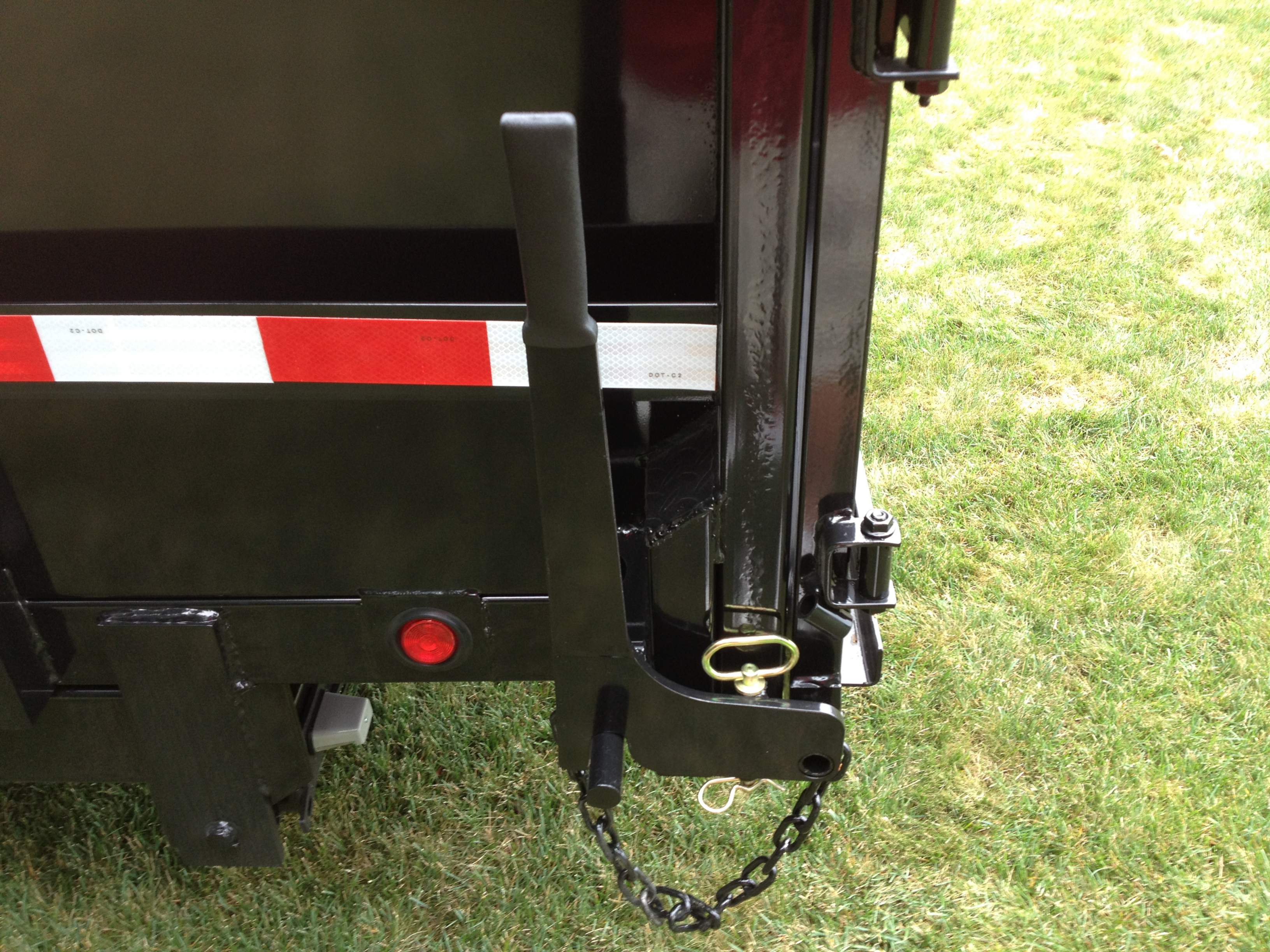

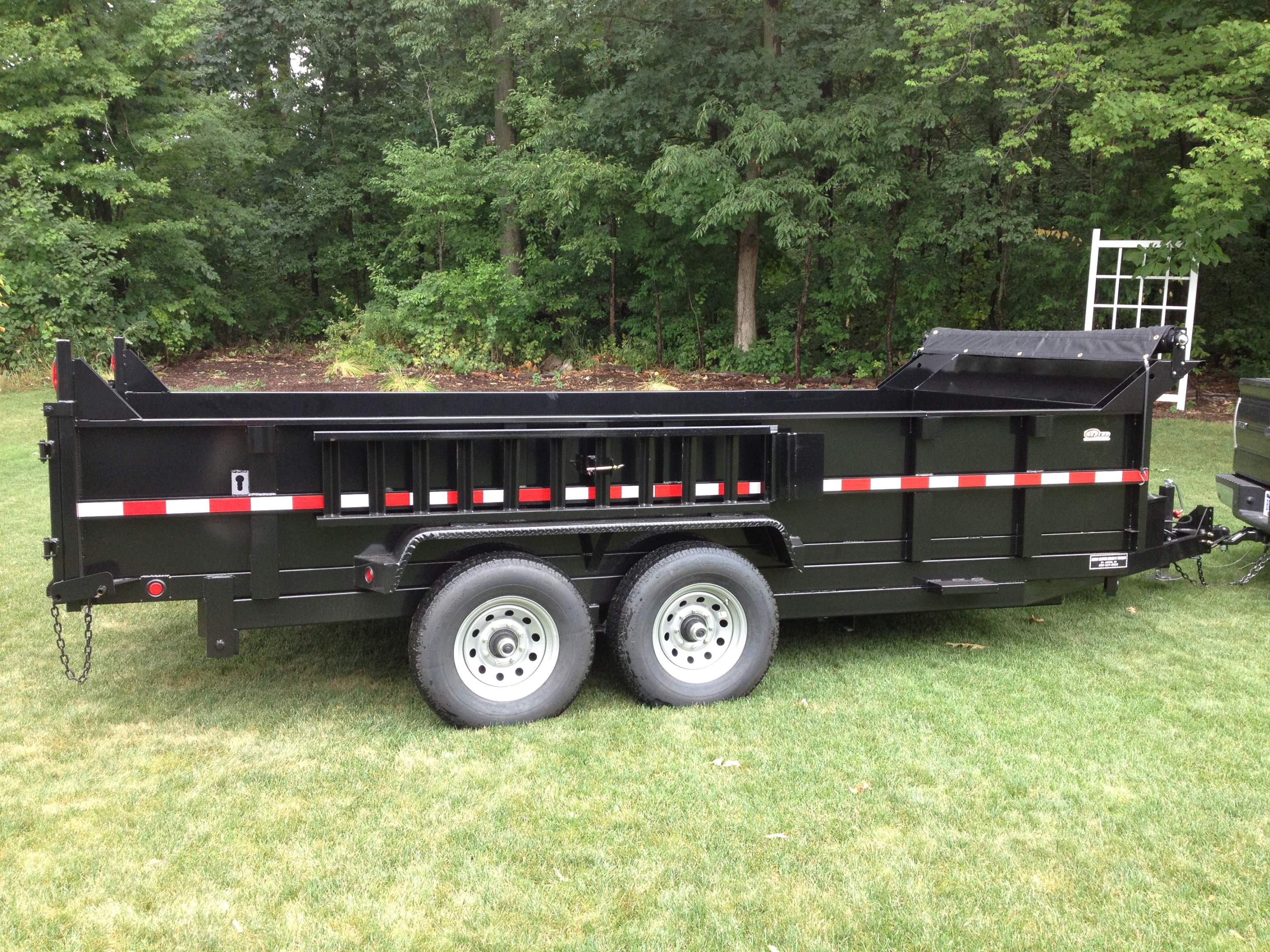

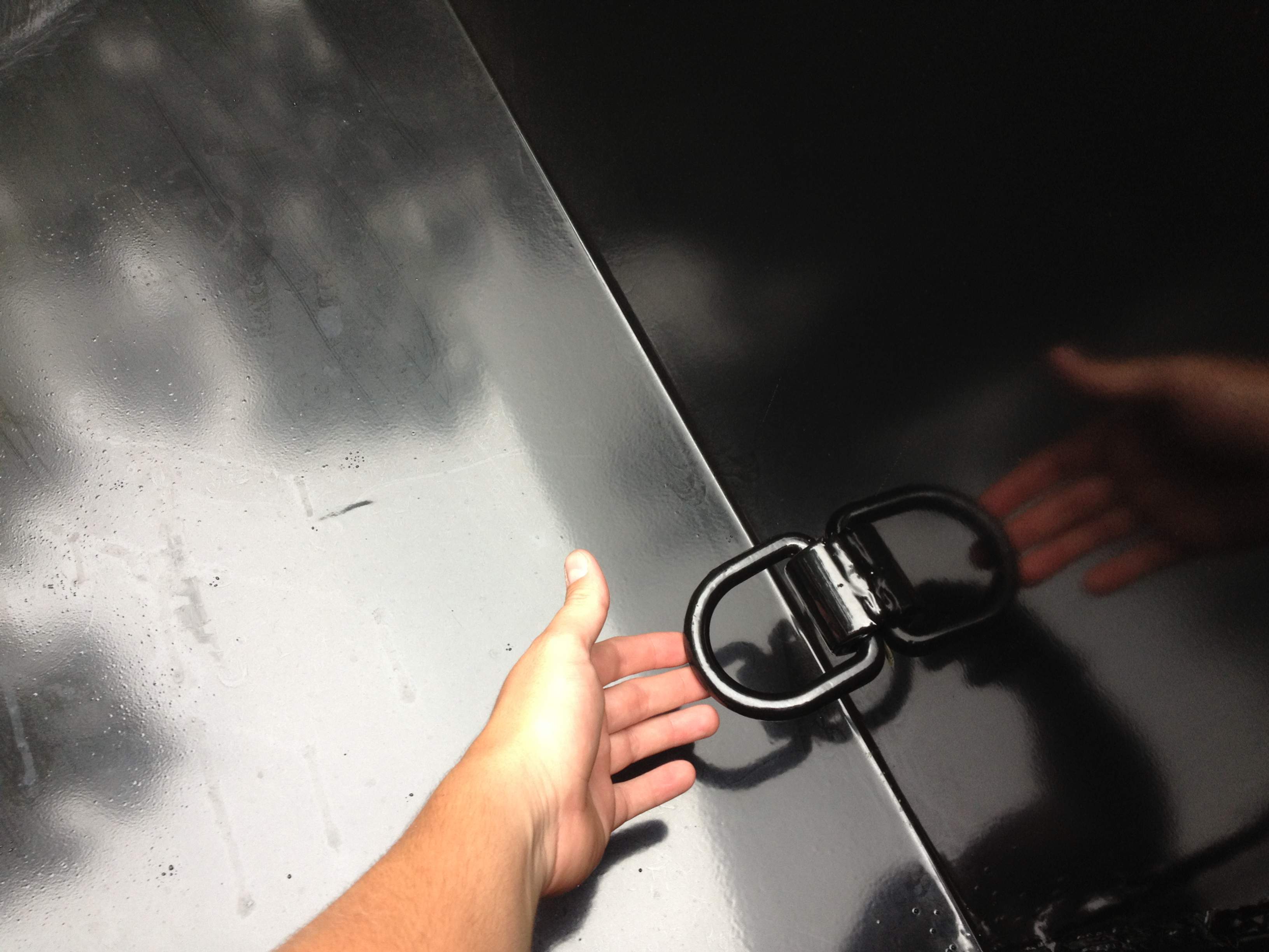

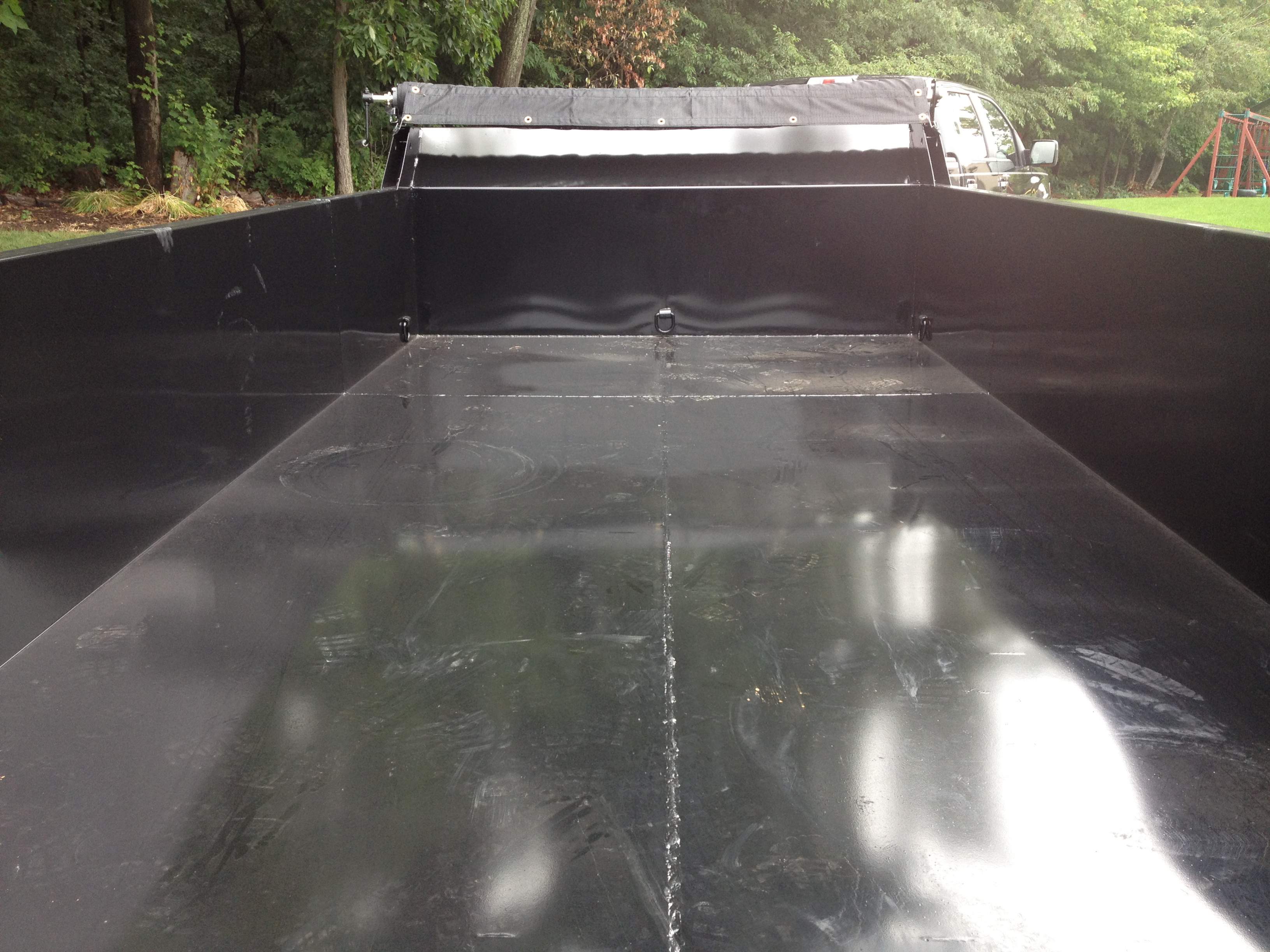

Thanks guys for all the help in making my decision. I picked this 16 footer up yesterday. Here are some pics...
IMG_0480.jpgIMG_0481.jpgIMG_0482.jpgIMG_0488.jpgIMG_0489.jpgIMG_0490.jpgIMG_0491.jpgIMG_0492.jpgIMG_0493.jpgIMG_0494.jpg
   / Dump trailer to haul tractor? #39
Nice.
Chris
   / Dump trailer to haul tractor? #40
Nice. You'll appreciate the D-rings. :)
How much of a dump angle do you get with a low profile trailer? Mine isn't low profile, but I could use another degrees, especially when hauling moist mulch and manure.
Sent from my iPod touch using TractorByNet
