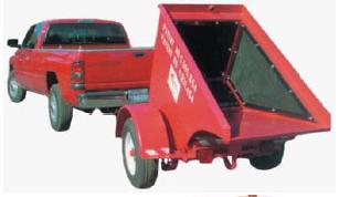

"How aout one of these?"
Boy, that might make a nice dual purpose implement: As designed for a dump box, or, as a counterweight for the FEL work.
Although the website gives a cubic capacity, it doesn't list the weight capacity. Might want to ask about that.
