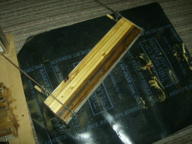

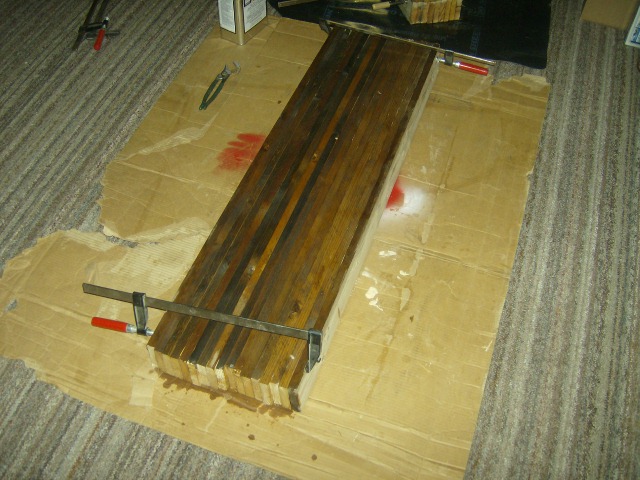

I considered all the recommendations and settled on the floor varnish mostly because I already have it.
I clamped the long boards for the deck and sides together and I clamped the short boards for the front and tailgate together. I spread the varnish on one side. See the pictures below.
When that dries, I'm going to flip the assemblies over and do the same with the other side. Lastly, I'll lay the boards all out and varnish the wide surfaces in much the same manner.

   / Dump Trailer #233
Will that method make your boards stick together ? and leave an edge?
I think it will, good luck and the edge can always be sanded off
Where I'm only putting one coat on here initially, I'm not too worried about it sticking them together.
In fact this morning I went to turn each assembly over to varnish the opposite edge. The boards slipped out of the clamp and fell helter skelter all over the basement floor. I take that as a sign that the varnish is not sticking the boards together too badly.
In addition to making the varnishing of the edges faster and easier, I chose to clamp the boards together to eliminate drips accross the working surface of the boards. I guess it's the trade off with the edge on the board.
Thanks for the heads up, though. I'll have to pay special attention to the edge tonight when I pull them apart to start the first coat accross the wide surfaces. If I have to do some sanding, I will.
