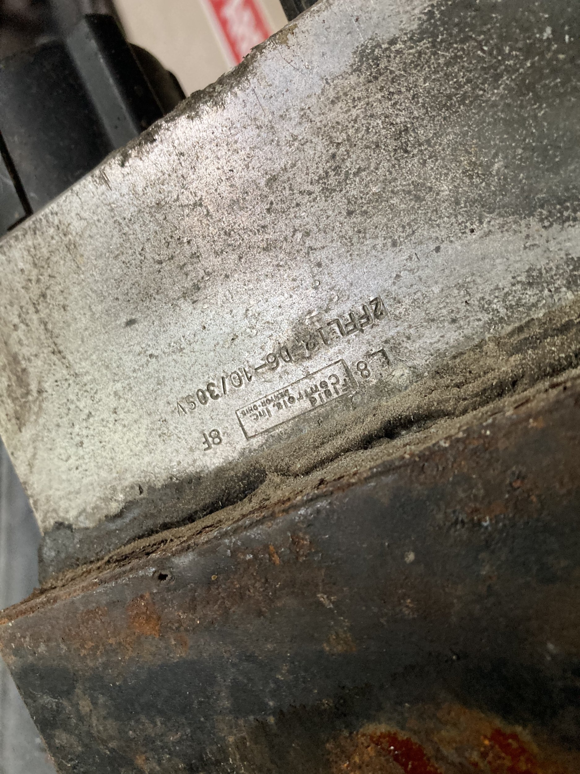

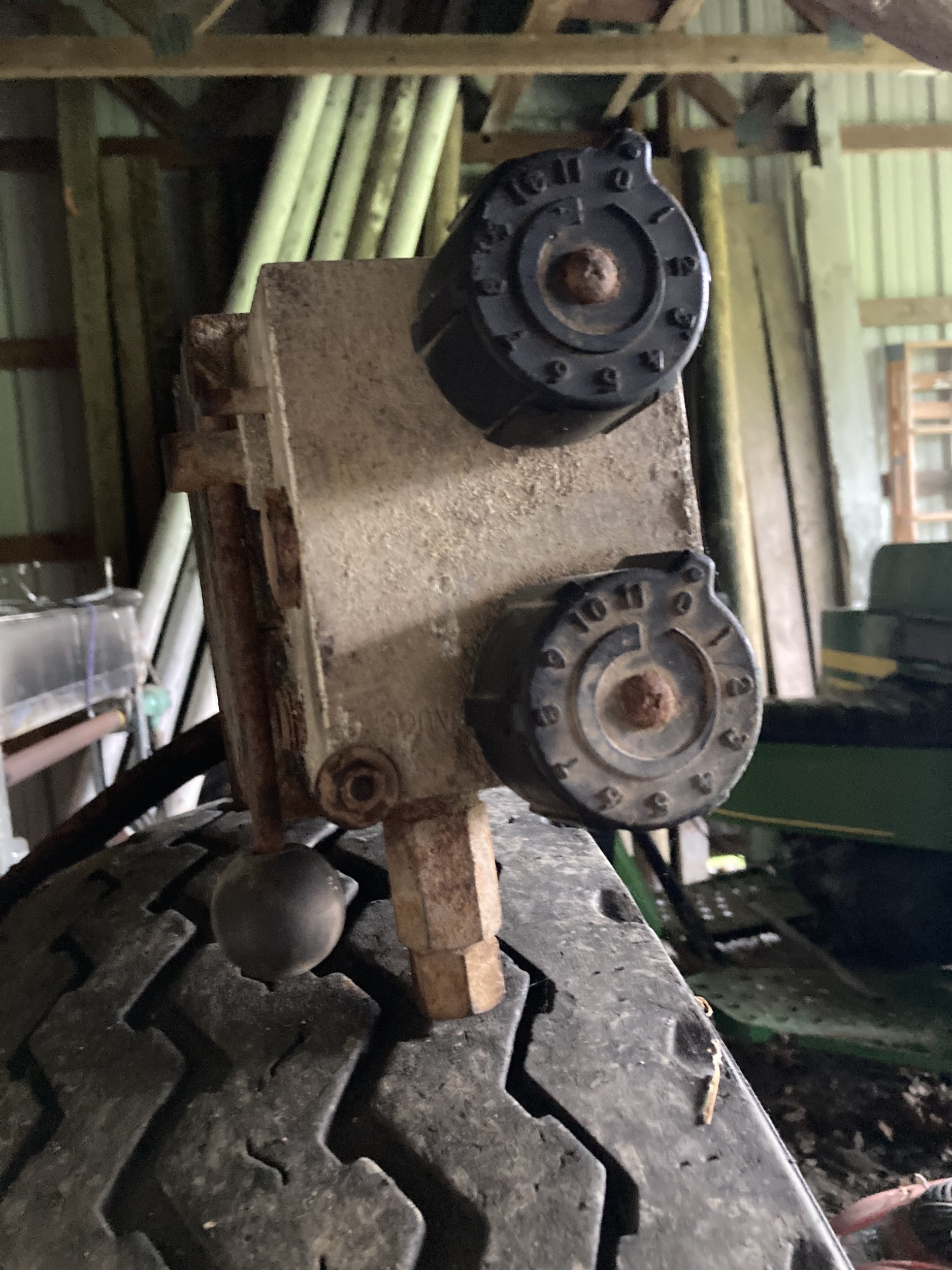

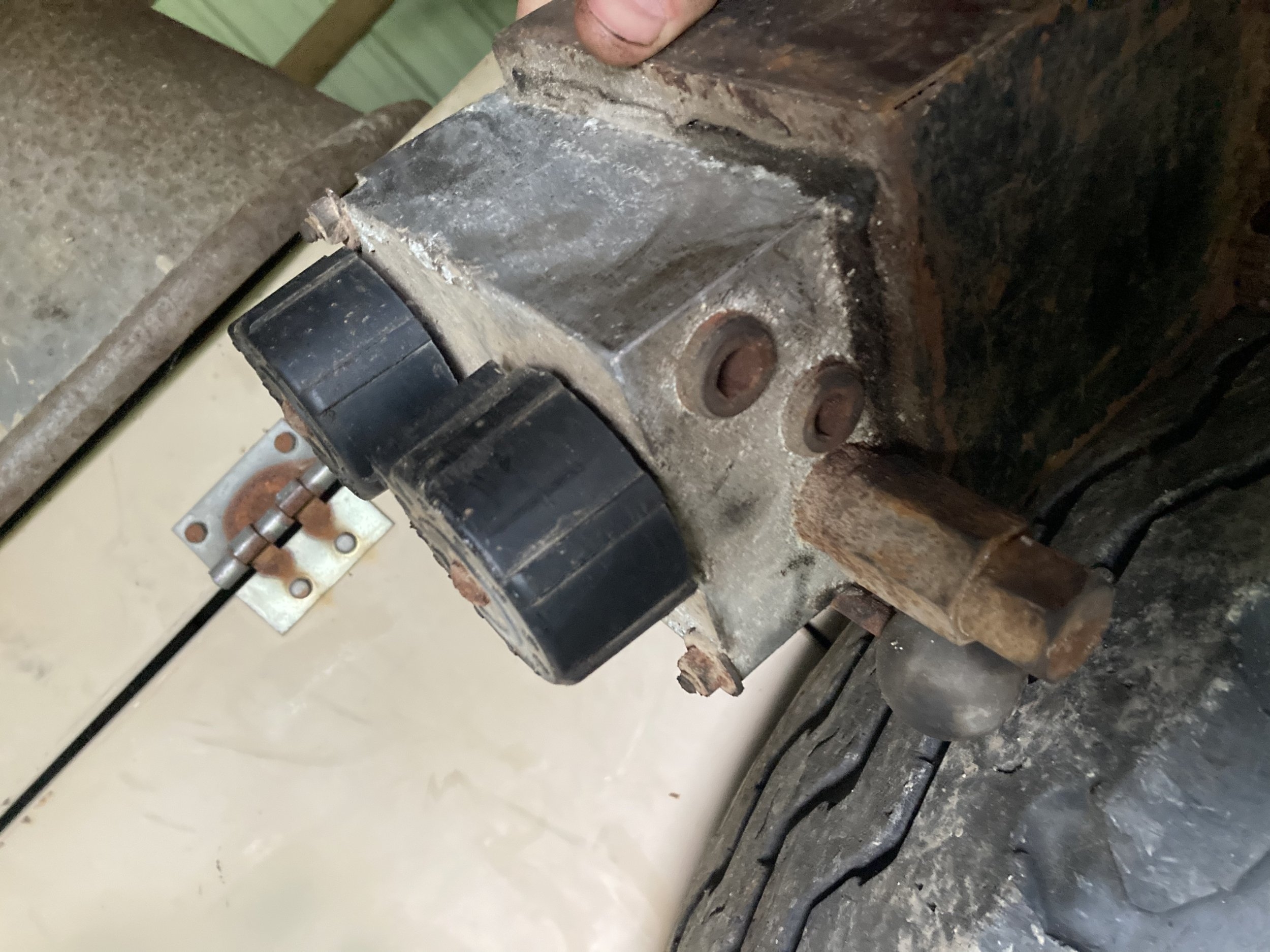

I attached a photo pointing to what someone told me was pressure relief on the valve body. The other pictures are the flow control valve that was removed.
How would I go about specifying the right pressure relief valve to add to the system

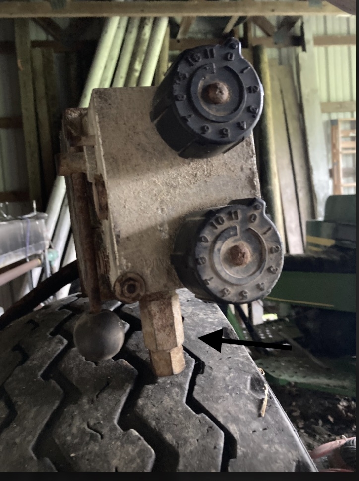

Is that the diverter? Whatever it is, I've added an arrow pointing at the relief valve.
Relief valves are adjustable. They can be opened up. Inside will be seals plus some sort of compression spring-loaded poppet or ball bearing that seals an orfice. Adjustment for pressure at which it opens is done by changing the preload on the spring. Some springs have a threaded adjuster, others use shims.
Either way changes the preload and thereforenthe psi at which it opens.
Most Ag machines run at 3000 psi max, but not all do. Don't screw around with psi; and only use rated hydraulic fittings. Plumbing fittings will often thread on, but please DON'T.
For finding a proper psi, look at the markings on your hoses and hose fittings. Then call the manufacturer and ask what working pressure that part number is designed for. Set relief at that pressure +- 10%. Be real suspicious if anyone tells you higher than 3000 psi for a working pressure.

That photo you added the arrow to is the flow control valve I removed.
The flow diverter is the square silver box still on the truck.
So it looks like the flow control valve I removed was acting as the relief for the the valve block and the flow control valve. Interesting. The return to tank hose on the flow control valve was a smaller size hose.

Yes, I'm sure the one I drew the arrow to is a relief valve. i didn't know which box it was on.
The one you are pointing to with your finger in the photo may be a relief valve. I've never seen one like that, but that means little. Kinda small, but It is on the main valve body and located where you would expect a relief valve to be on the valve body. Lets say it is a relief, and also there was a relief back on the flow control valve assembly. That makes the right number, and also puts them where they should be located in the circuit. Makes sense.
