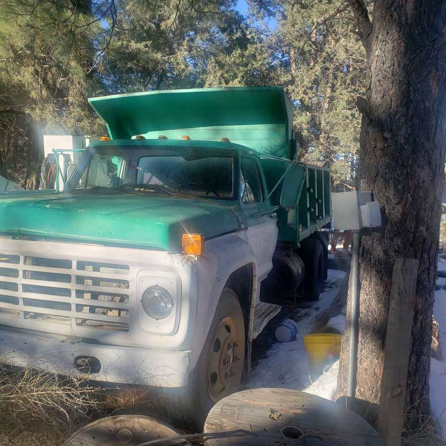

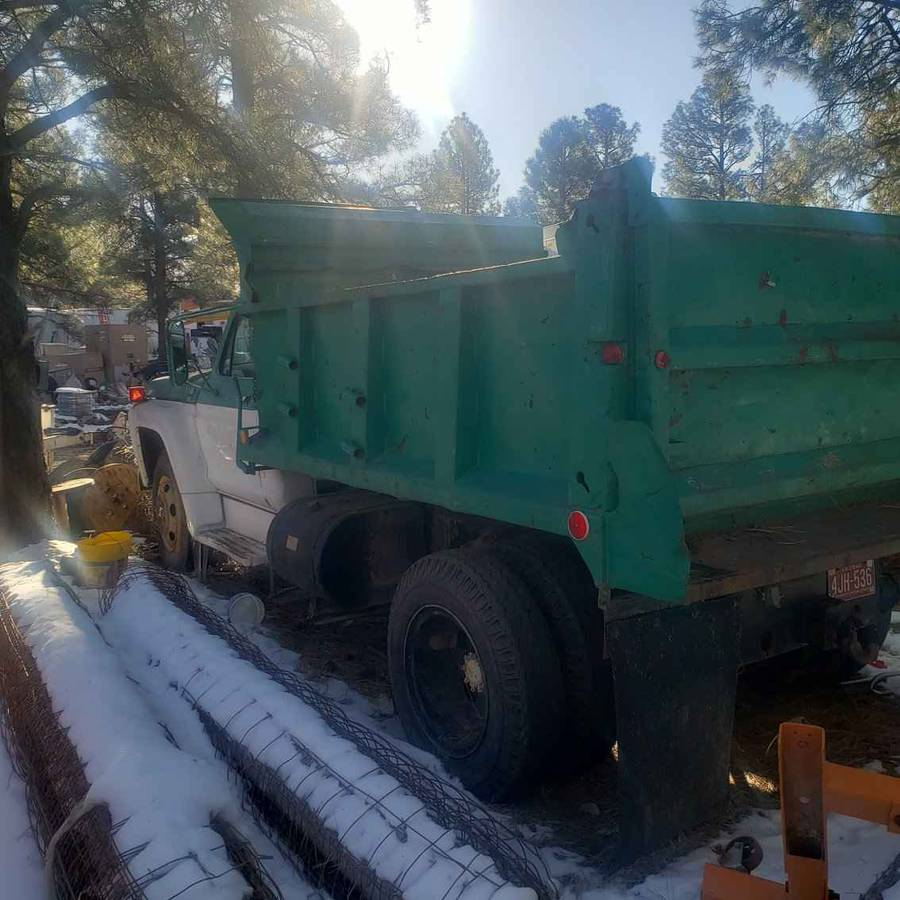

I don't think the OP wants a 10 wheeler. Here is a F-600 for reasonable, needs some work. I realize it is in the wrong location for you but gives you something to consider, quality/price.
Dump Truck - heavy equipment - by owner - sale
I only count 6 wheels on an F-550 or F-600
