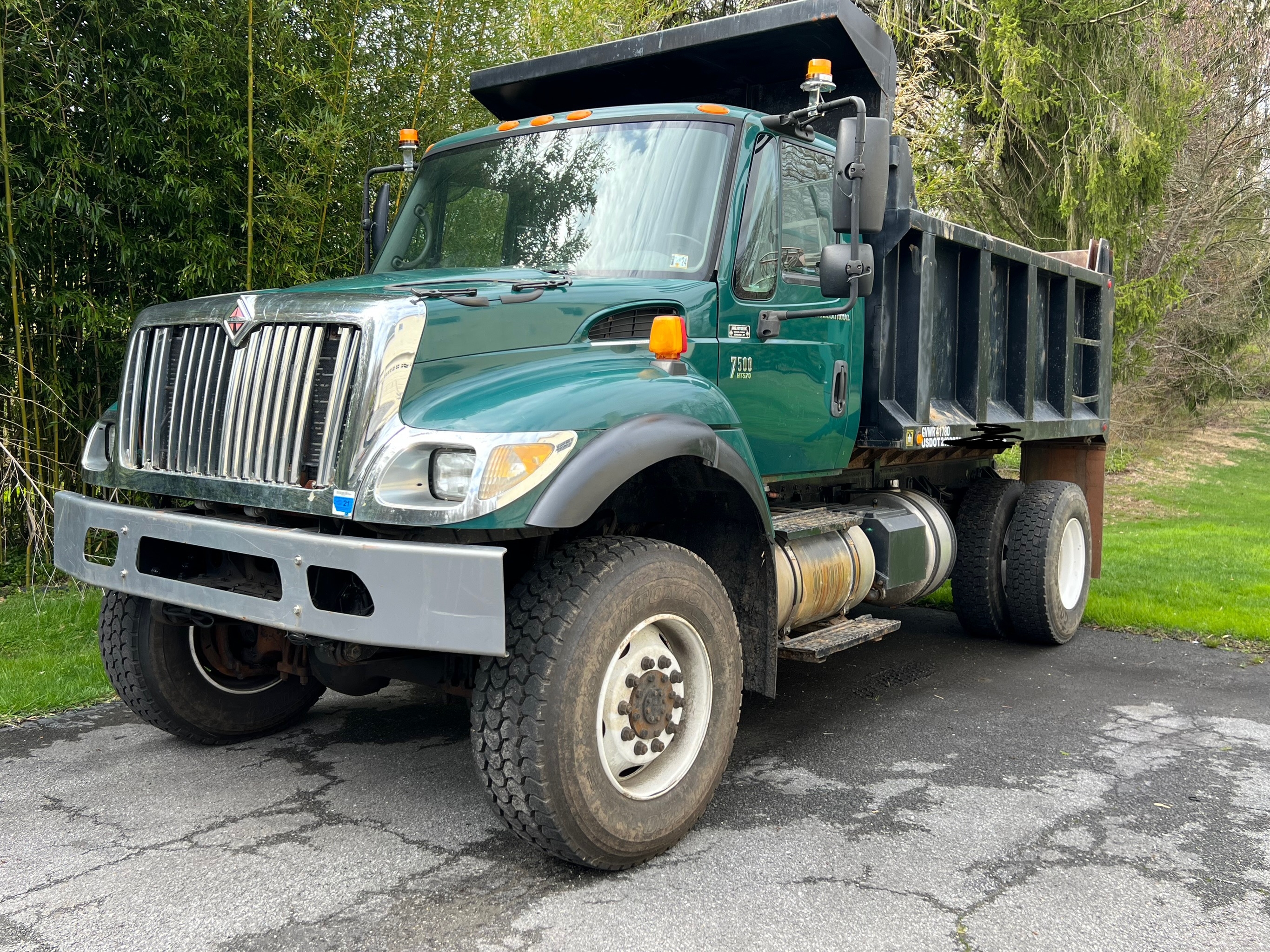

12’ dump with 4’ sides
Another nice thing about a 10 ton dump trailer is the possibility of hauling my excavator with it.
I wouldn’t want to load your excavator into a dump trailer. The ramps are super heavy for one thing. When you get the height of a deckover dump trailer and the weight of a 10 ton excavator the weight of the ramp is even more of a concern. Chaining machines in a dump trailer flat out sucks. Most people just Bluetooth bind them in dump trailers. It’s less of a problem than the previous issues but you can’t spin the machine in a dump trailer either.

I haven’t had a dump trucks in a couple years. I have 3 dump trailers. I’m mostly using them for dumpsters on my construction job. Occasionally I miss my dump truck but it wasn’t big enough. I really need a tri axel dump if I was going to have one but I can hire the trucking done cheaper than that investment. I miss the ability to tow a machine to the job with the dump truck and then jump right into hauling instead of having to go get a dump trailer first. The dump trailer also takes forever to dump. It’s rare that I would haul over 2-3 loads a day so it’s not a big issue but site hauling like your 200 load log job is painfully slow in a dump trailer.
