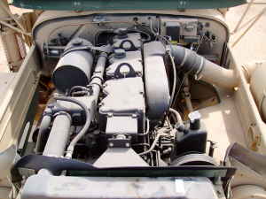

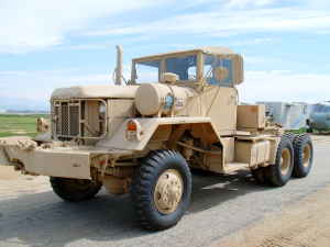

Here is the Militarys farm truck.
AS NEW, M 818 MILITARY TRACTOR WITH WINCH. THIS TRACTOR WAS DEPOT OVERHAULED IN 2006, IT HAS NEW ENGINE, TRANSMISSION, TRANSFER CASE, DIFERENTIALS, BRAKES, TIRES,WIRING,LIGHTS, GUAGES, AND WINCH. TOOLBOX IS SEALED CONTAINING MANUALS, AND TOOLS. ALL BRAND NEW. EVERYTHING ON THIS VEHICLE IS NEW, IT HAS 32 MILES ON IT. JUST RELEASED FROM THE MILITARY. CAN ONLY BE SOLD TO US CITIZENS, NO EXCEPTIONS. VEHICLE CAN NOT BE EXPORTED OUTSIDE U.S.THIS IS A ONCE IN A LIFETIME FIND, AND VERY RARE. THE ENGINE CODE IS 94012 NHC250. THE ENGINE BRAKE HORSEPOWER IS 250.0 @ 2100 RPM. THIS IS NOT THE MULTI-FUEL ENGINE, IT IS A DIESEL ENGINE. HAS POWER STEERING AND PINTLE HITCH AND UNDERWATER FORDING SYSTEM. ALSO HAS THE LOWER FIFTH WHEEL COUPLER. HAS TWO SPEED WITH 5 FORWARD GEARS (MANUAL). AXLE DRIVE TYPE IS DOUBLE REDUCTION. BRAKES ARE AIR/HYDRAULIC. COMES WITH SPARE TIRE. FRONT AXLE ENGAGING MECHANISM TYPE = AUTOMATIC. THIS IS A 5 TON TRUCK 6X6, Clear California Title, Proof of U.S. Citizenship required for purchase, Cannot be exported.can email more photos.$20,000
Not sure if this add is legit or not but it looks fun:)
