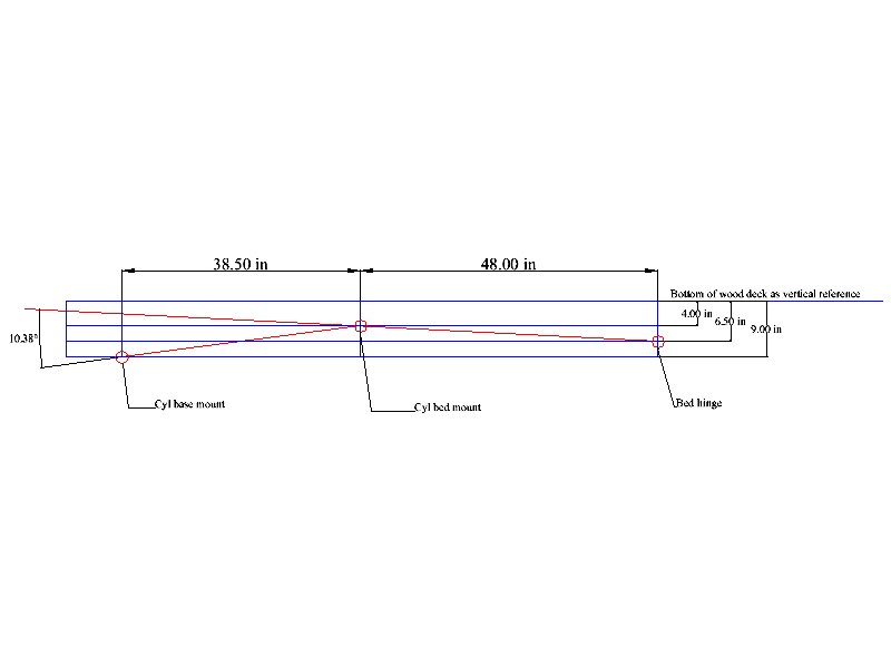

As built:

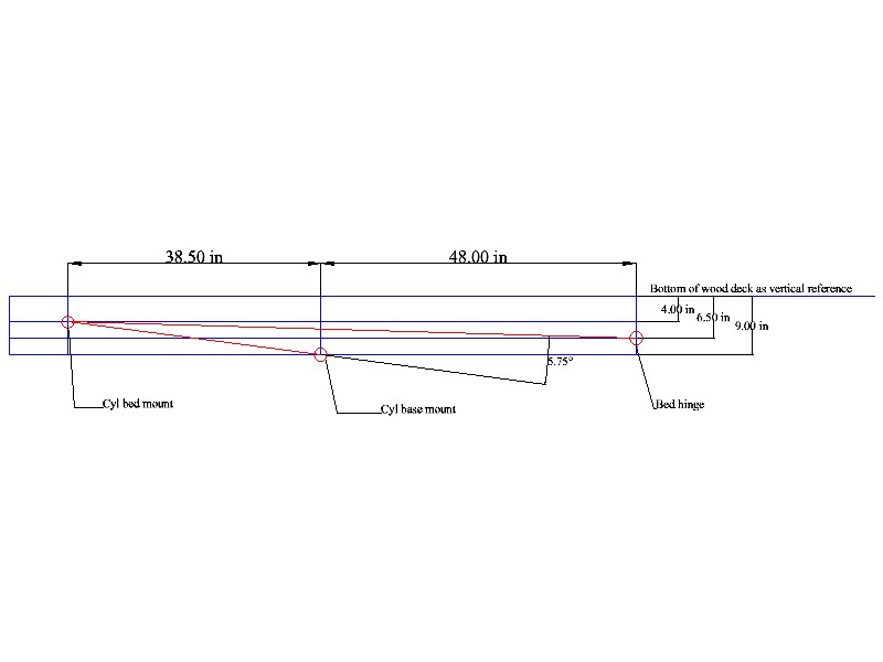

As per my understanding of rswyan's (and others') suggestion:
Omitted from the drawing for clarity is that there is also 12" of rear overhang past the hinge and 21" of front overhang past the base cyl mount. Since these affect both designs equally, I left them out of the drawings. 4" bore cyl with 30" stoke running a guess of 2200 psi as that is my understanding of the factory setting of the relief valve on my tractor

The cold finally let up a bit and made it up to -8 today so I took the time to get some measurements and plug them into CAD to get the cyl angle. My 10 deg guess was pretty frickin close. Cad says 10.38 deg at rest. So using the link from Surplus Center forces go something like this:
Current:
10.38 deg = 4981 lbs of lift 4' from the box pivot
Lift whole thing 4": 13.39 deg = 6398 lbs of lift
Lift whole thing 6": 19.44 deg = 9201 lbs of lift - really don't want to raise it this much
If I were to reverse the mounts as rswyan suggests:
At existing height: 5.74 deg = 2765 lbs of lift 8' from the box pivot
Lift whole thing 4": 11.5 deg = 5512 lbs of lift
With factoring in the mechanical advantage of the lever of the box (if I"m calculating right), the second way would give me an extra 549 lbs of lift BUT also an extra 2216 lbs of horizontal push now trying to push the box off the front of the frame rather than the back. I'm not sure this is an improvement. Now if I were to reverse the cyl AND lift everything 4" I could gain 4626 lbs of effective lift for a total of 11024 lbs by comparison. This is obviously a big improvement but has the challenge of the cyl base mount being in the middle of the reach which is it's weakest point rather than now with it on the front frame. Anyone know how much force is required to bend a 3" pipe pushing in the middle of a 8' lenght?
If I got this right, I'm either going to weld it solid to the wagon frame at it's current height or raise it 4" and weld it solid. If that doesn't work, I'll incorporate a scissor lift once I look at the geometry a bit more.
In these calculations I made an error as to the length of the lever and the ratio between them. The second option should have had a factor of 1.8:1 not 2:1 for calculating equivalent lift. Lever length for the first (as built)option is 48" while the (my understood) proposal has a length of 86.5"
So to re-calculate the proposed layout:
5.74 deg = 2765 lbs of lift @ 1.8 lengths of the original lever (86.5 vs 48) = 4977 which is pretty much exactly what I have now. 2765 lbs of lift on a 86.5" lever is the same as the 4981 lift on the 48" lever. Please correct me if I'm wrong.
