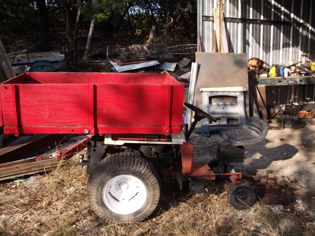

Well guys I needed a way to move small amounts of soil/rock that I've been digging up with my hoe, so I dug thru some inventory and built this. It consists of an Allis transaxle, a 5HP Briggs and a monkey Wards front axle with steering system. IT may not be pretty but it works well.

And what happens if you get off the machine with the dump bed fully loaded? The operator looks to be the ballast. :eek:
/ Dumpbed Backwards Tractor
The bed is very slightly over center towards driver.

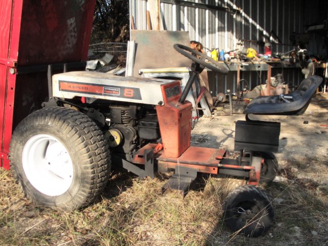

What cain't be seen underneight is a 2"x6"x1/4" thick full length frame. I feel safer with this than some of the loads i've seen in FEL on small tractors.
Yes Eddie all parts were on hand. That transaxle was ment to be run from the flywheel side of engine, so running it as I am it still has 3 foward and reverse.

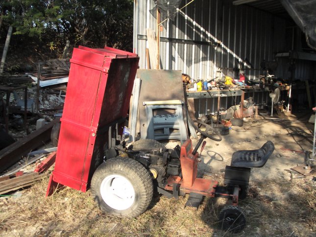

Is dumping powered or manual??
Very nice use of spare parts!
/ Dumpbed Backwards Tractor #9
SkunkWerX said:
That is a cool little mule ya got there!
Its auto-dump... just get off. :D

The first time I looked at the photo I assumed you steered from the rear wheels by twisting your butt around-using the steering wheel for leverage.
After looking at it a few more times I think maybe I was right? or not?

Thanks guys, I have more fun building than useing.
The ball hitch was for pushing the dump trailer that the bed came off of and it can go back with two bolts.
Here's a shot of trailer as I built it last year.
In the above pic you can see the tailgate catch/release rod running down the side. Just a twist. This is manual/gravity dump at this time.
