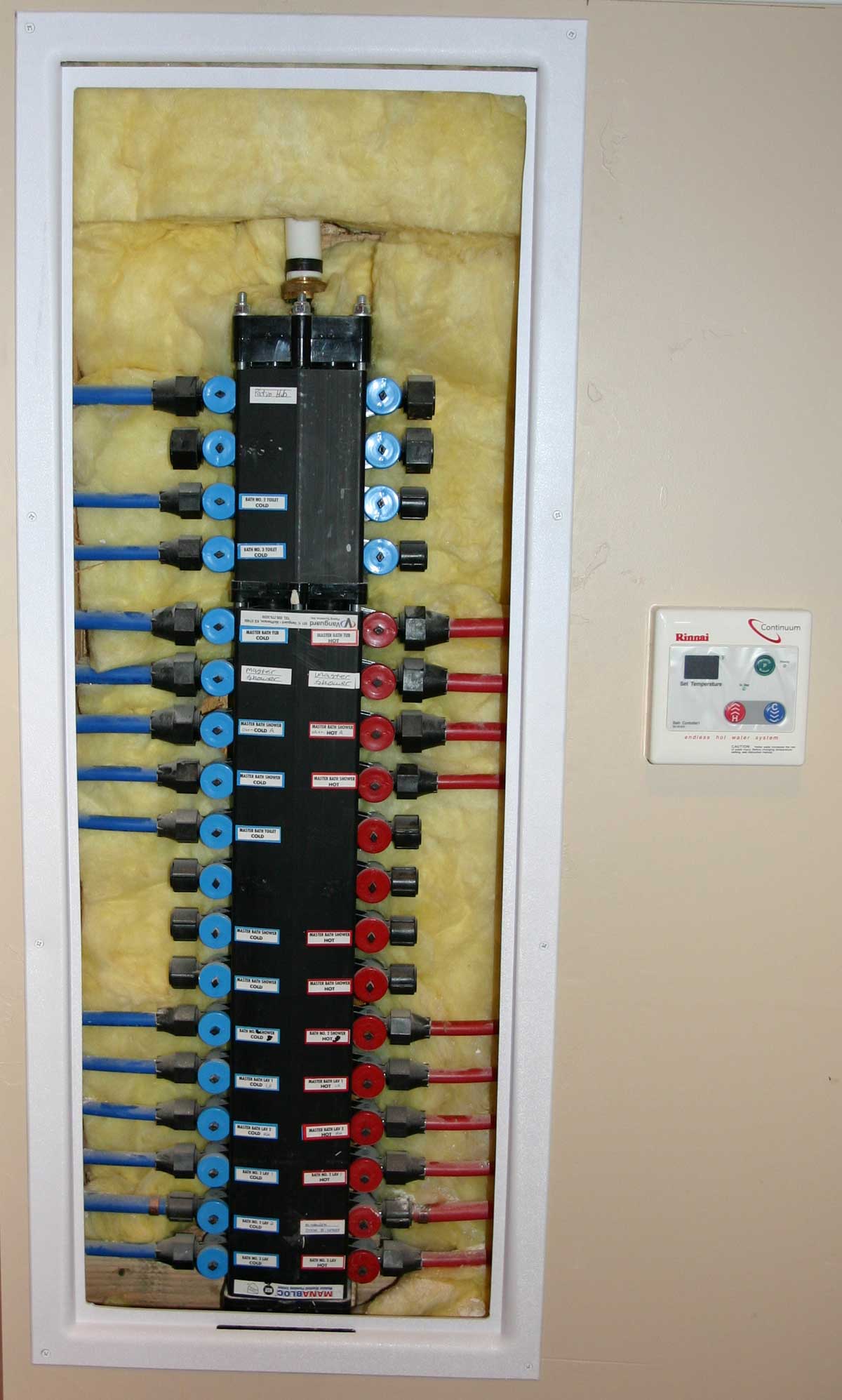

Here is a house I toured and took a picture of the installed a Manabloc.

   / Dura-Pex vs copper pipe #80
_RaT_
Did by any chance you see if the PEX tubing went into the Tankless hot water heater? I just had one of these installed, and they used coppper coming out of the tankless unit to mate to the plastic cpvc in the rest of the house.
Thanks,
Scot
