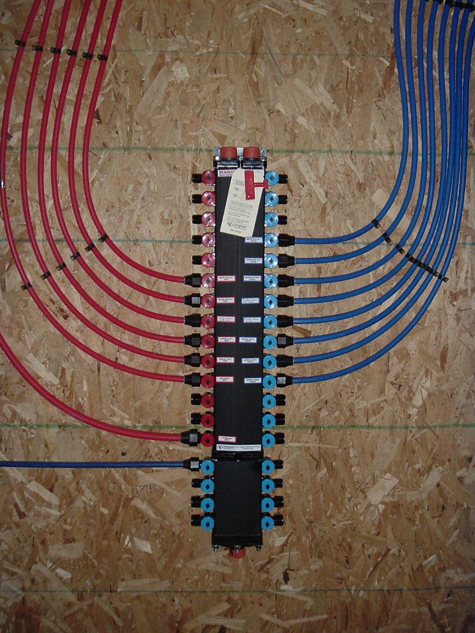

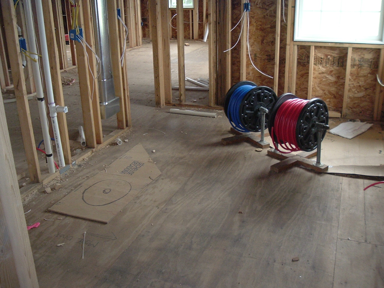

I just finished our new house and had PEX installed for both water supply and for radiant floor. Pics of both attached. We have 2 distribution blocks for the plumbing -- a small one right off the well for the kitchen sink cold and the outside faucets. The second, main distribution block is downstream from the water softener.
PROS--
Quick install -- you set up a pull like its electrical wire (but see CONS)
No water sound through pipes or pipes creaking--its silent
Can shut off a single fixture in the basement like a breaker panel
Cheaper than copper
Water tastes fine and I've never heard of a taste issue
You can flush the toilet while your wife's in the shower and she'll never know
Minimal fittings equal less hydraulic loss equals better flow at the faucet.
CONS--
I had a plumber do it, so now when I want to add on I have to buy the crimp tools and parts.
The tubing is pretty stiff and requires a large bending radius (12-16") so you need to watch for kinking and plan concealment.
Also the tubing has a natural curve from the reel you have to work with.
You go insane hoping the drywallers don't put a screw through it -- we kept pressure on the lines through sheetrock, so we would know.
Overall to end user its a better product, and I would use it again.

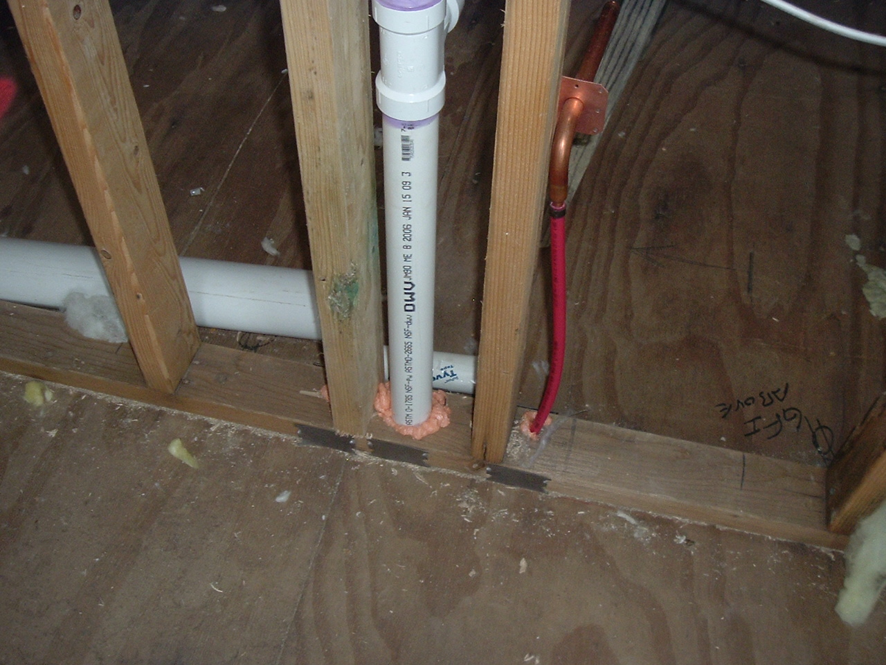

Not the best picture for it, but you can see how it transitions to copper to get through the wall for fixture connetion. We bought these pre made with nail plates.
