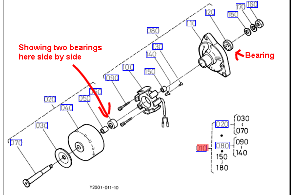

Yesterday I burned the accessory belt on my B1750. The temp was rising and quick check under the hood showed the fan stopped.
When it cooled down I realized the dynamo is not turning very easily, actually it was not turning at all. I took it out, it didn't smell bad or anything, just would not turn.
I took it apart just to see, there was a lot of caked dust but the field seemed to be fine. I measured the resistance and also the field against the ground and nothing wrong. It looked like the bearing on the bottom is the culprit - the one that stays in the field half. I got it out with brass punch and sure enough the bearing ball cage was in pieces.
Email tractorsmart this morning to see if they have it; is there an upgrade available? The part schema talks about dynamo, I found suitable alternators on ebay under 100 bucks - I hate to spent more money than necessary but sometimes it makes sense. More power HOHOHO would Tim Allen say.

That's the plan:)
Tractorsmart replied to my inquiry and they say there are three bearings in the dynamo. Now I don't have it with me, but I took it apart yesterday - why would there be three bearings? :confused:
Edit:
Ronnie Bowman got back to me: I was just going by what the parts manual says for the B1750.
See the attached picture.
However I did find that same dynamo used in other tractors and only calling for a single bearing of the same part number at that location.
As always, you can't go wrong dealing with Tractorsmart:thumbsup:

Ronnie was right, of course. There are three bearings in the dynamo. I fixed it and the tractor runs well again.
Pretty good engineering from Kubota, btw.
