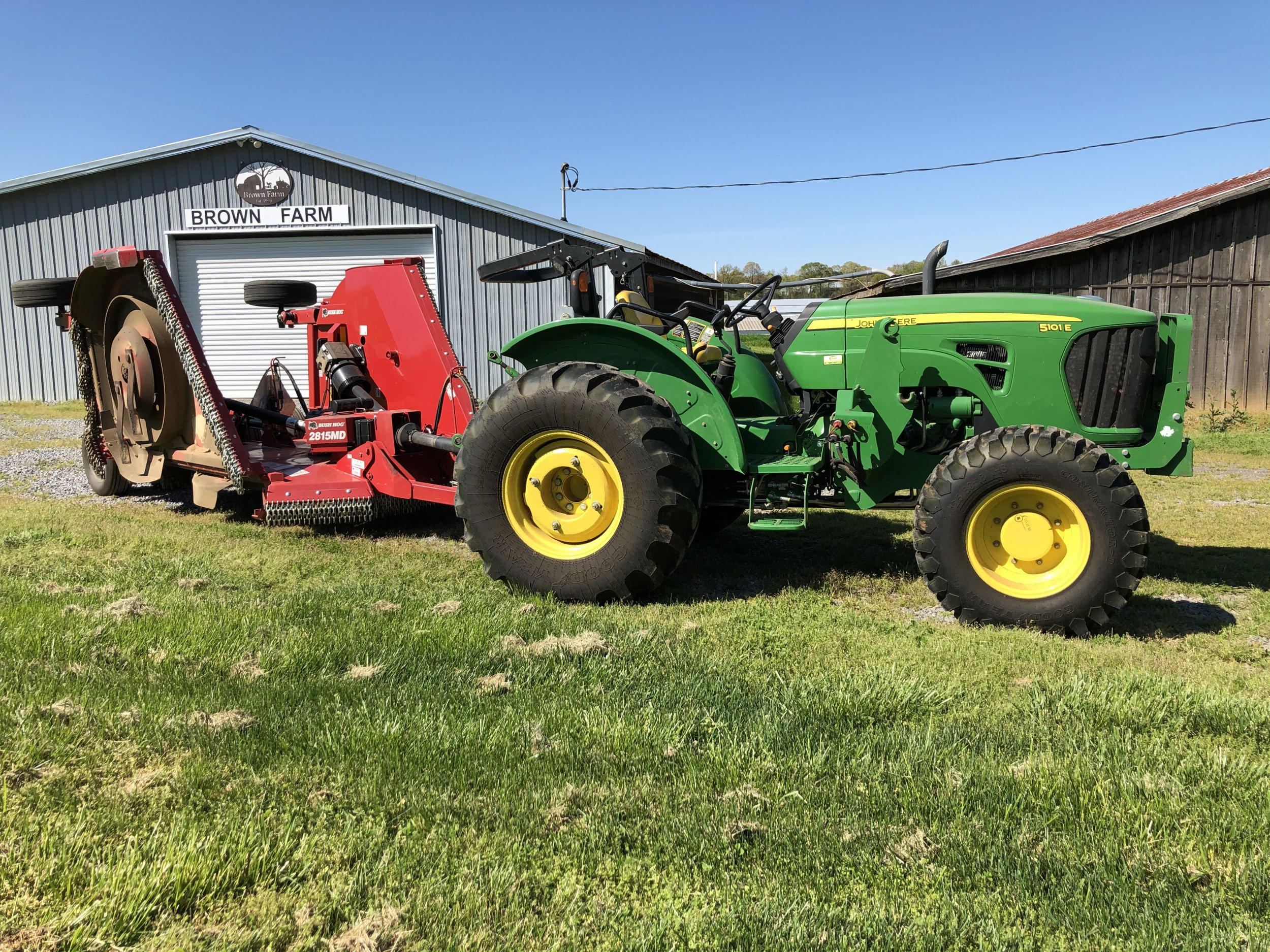

My 5101E which I absolutely love : is way stronger & sounds totally different thru the exhaust than my 5093E.
I sold my 5085E & replaced it with a 5115M for the 32spd + 16 additional speeds in creep ranges & the Extra POWER.
I run all 4 R4 tires 90% fluid filled on all of my tractors for traction & stability on my steep hills & banks.
The added weight really hurt the little 85hp Compared to the 93/101hp

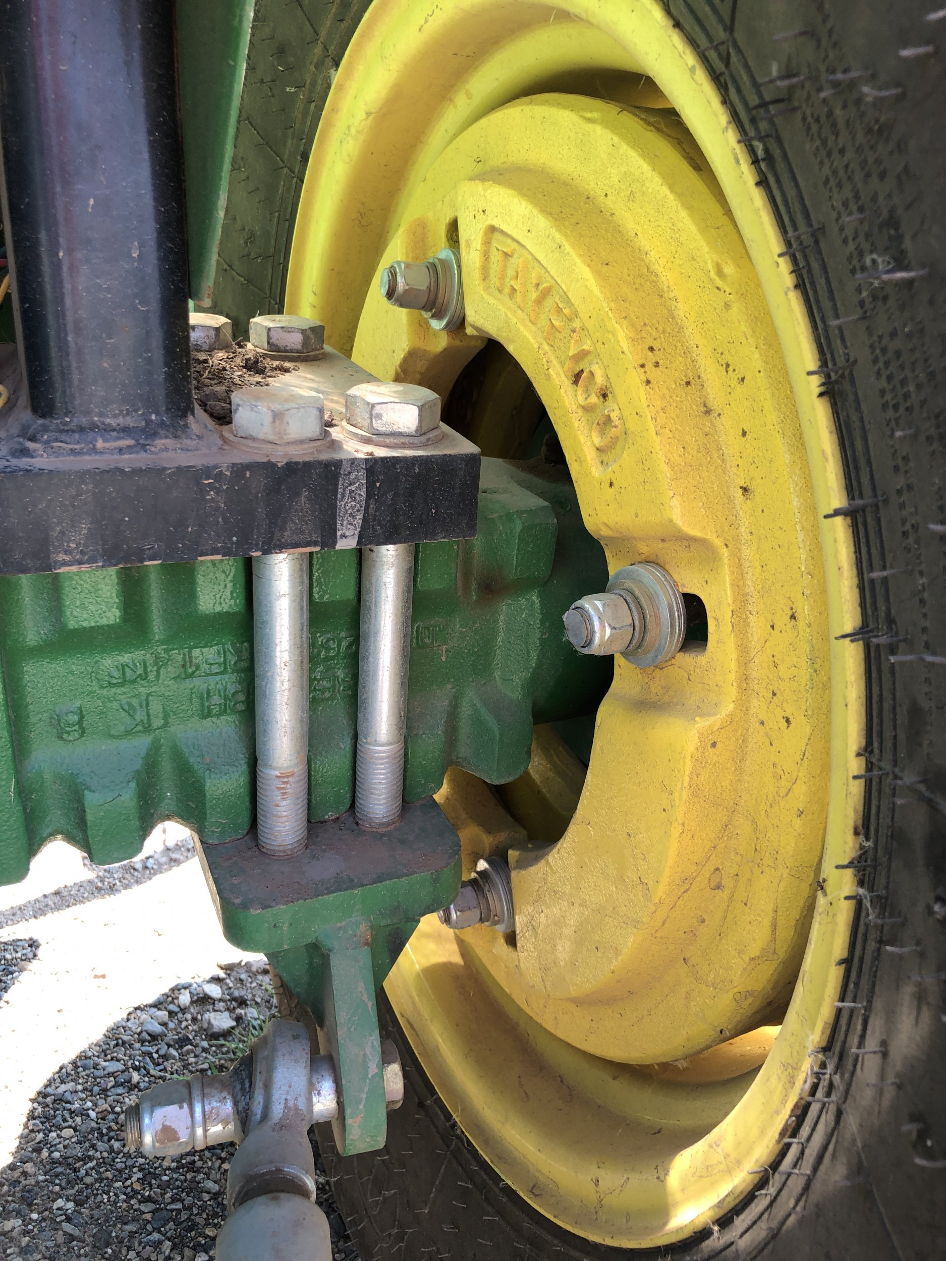

Would you mind when you get a chance posting a picture of the wheel weights, I have my rear tires loaded but I am definately interested in some more weight.

The inside weights are 150lbs each on 5093E.
I ran 2 stacked together on the 5085E I sold.
Only one would fit inside the 5115M
The outside weights on 5101E are 350lbs each but I had to turn wheel centers around to accept them & run 4” steel wheel spacers to keep my same width.
