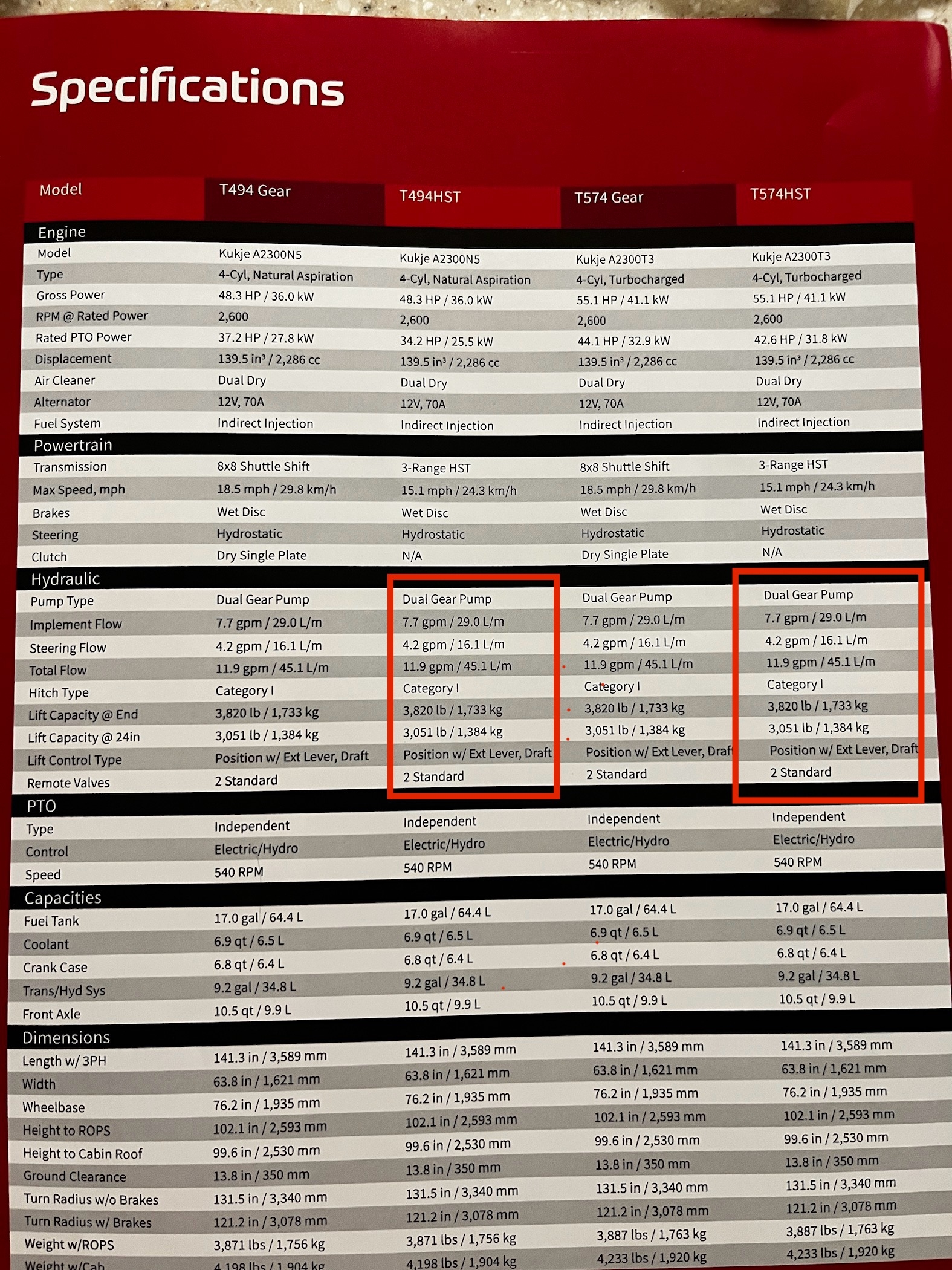

I may be mistaken, but thought turbos add more complexity.
I mentioned to the dealer - annd he was trying to sell me the 494!
Apparently the Kukje turbos have the same astounding track record as their engines?!?
   / Would you pay $1,500 for 14% more HP? #23
I have no experience or input for the turbo. I can say that it's a lot easier to have a lack of HP or weight than it is to have an excess. My next to last tractor was an L3200. They wanted another $1,500 for an L3900. The L3200 was replacing a B7500 and the extra 11HP and 1,000# was substantial. Turns out that after a half dozen years of the L3200 I wished I'd have gone with the L3900. Of course had that been the case I may not have gone with the L4240:)
#24
Turbos in the good old turbo Diesels are still reliable.
Older such engines for from Catepillar, John Deere, International Harvester, Cummins etc. are good examples.
Dealer said he’s had zero break-fix jobs on these turbos.
   / Would you pay $1,500 for 14% more HP? #25
6.7 additional hp isn't much. tractor weight is as much your friend as as extra hp.
if you're questioning additional hp, look at your future tasks, possibly unseen as well.
i'd look at 70+ hp utility tractor. just a turbo for that size tractor isn't much. maybe hire out the work you illustrated. all the best, just don't rush into a purchase you might later regret for not going larger.

Any addition increases complexity.
Turbos are good at increased elevations. They pump more air into the cylinders.
New school turbos are much more reliable than old ones.
If you are working your machine hard before you shut down it's good to let the engine idle for a few minutes. It gives the turbo time to cool down and cycle oil through.
Other than that I've had no issues.
