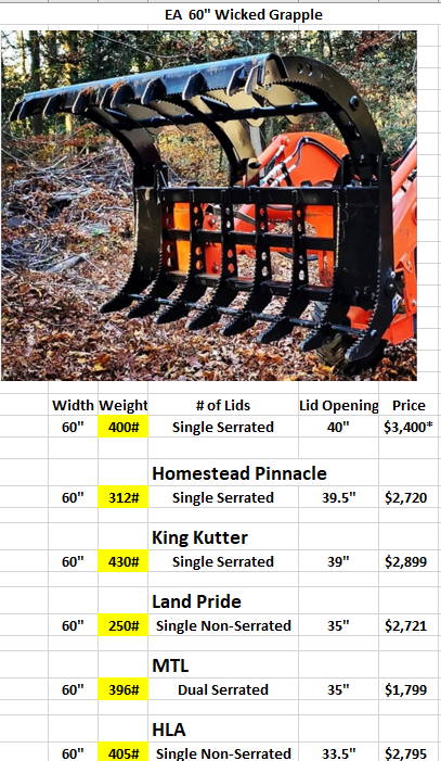

If I was in the market the Frostbite would be my choice.
I looked around those and they are in budget, but I can't wrap my head around the narrow width and single thumb for brush work. They are light, due to smaller size. Their website gives almost zero useful info.
I am ticked that EA fell apart because (surprisingly), my home CFO made my budget big enough that I could have had one.
I'm still researching. I think I've decided on Root/Brush style rather than Rake/Clamshell style. I appreciate new brands to research. Once I get done, I will 'publish' my findings to help future buyers.

Checked out raptor. A little short on details. The 'tractor' versions are only the clam style and are very light. That could be good or bad. 60 or 72". I'm thinking 66" is my sweet spot. Just a bit narrower than my tractor. +/- 6" is not a deal breaker though.
The Skid ones say they have 72, 78 and 84", but only allow you to choose the 78 or 84. They are a bit on the heavy side, but so have 3" cylinders, which is big compared to most I have researched.
No info on steel quality, cylinder length or tine spacing.
Why are so many of these working out of NC?

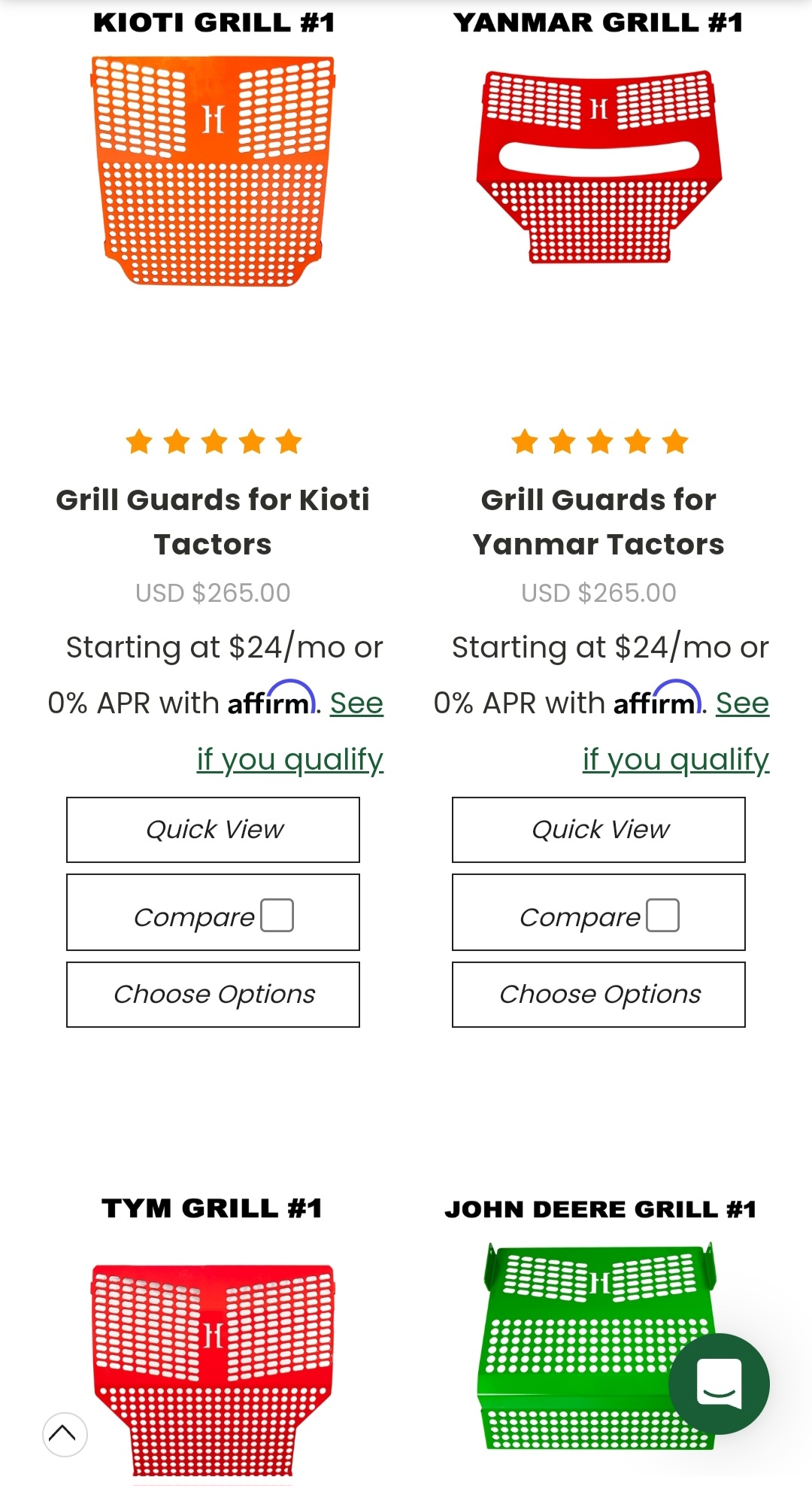

   / EA grapple not an option now what? #88
Nice thing about Homestead, they have grill guards for some makes/models.
