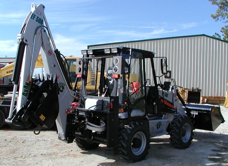

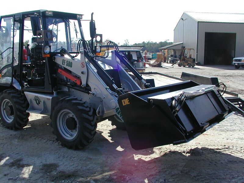

Re: Lights
Well, here's a picture of one set of lights on the EF-5 lit up, in bright mode. This is basically what you would see if the turn signal was on and the brake lights were on.
The picture was obviously taken with flash, so that gives you a bit of an idea how bright the lights are...

#107
Re: Lights
Here's another, taken from the back. The lights are somewhat directional, so they're a lot brighter here because you're looking straight at them, and the camera is closer. It's hard to tell because of the overload, but the top light is the red brake light, and the bottom one is the amber hazard light.

   / EarthForce EF-5 enhancements #108
Re: Lights
Holy crap, Mark!!! /w3tcompact/icons/shocked.gif
I dimmed my monitor and still had to squint. /w3tcompact/icons/cool.gif
I'm starting to understand the tonnage of candlepower them LED's are putting out, but with regards to using them as a backing-up warning device, is there any chance you could take similar pictures while the tractor is in direct sunlight?
Not trying to challenge their worth, fer sure, but now I'm just plain curious.

#109
Re: Lights
Sure, Harv, I'll try to do it tomorrow morning...
As far as using them for a backup device, I don't think they'd work in daylight. At the very least, the unintended victim would need to be facing the tractor... Now, at nighttime, it's a different story - they light up the night!

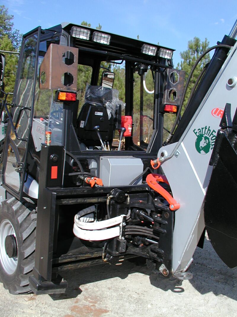

Re: Lights
Harv - Ok, here's the picture you requested. Actually, it's a little worse-case than you requested. The sun is not just shining, it's shining directly into the lights(about 3 p.m.). You can tell that by looking at the lights on the right, which are not on, and from the reflection in the rear glass.
Unfortunately, I've now run into a limitation with the camera. The difference in brightness is still very large to the naked eye - it still hurts to look directly at the amber one (the one that's on, of course) from a distance of 20 feet (I stepped it off this time). But, the main difference you can see in the picture is that the amber reflects ambient so much better that you can the red illumination shows up better than the amber.

Re: Lights
Here's a close-up. In this picture, the amber light that's in the lower left, the factory turn signal, is on - it's a 21-watt incandescent.
#117
Re: Lights
Thomas - <font color=blue>So what new device shall be next.</font color=blue>
Well, not counting the air shock for the seat, which I hope to have in a day or two, and wiring the lights and rigging a circuit for hazard warning lights and turn signals, I'm planning on several things: a bunch of gauges, probably connected to a PLC of some sort, a (wireless, hopefully) tilt indicator for the bucket, and some other ideas I haven't fleshed out yet... There will always be something to do, though. /w3tcompact/icons/wink.gif
   / EarthForce EF-5 enhancements #118
Re: Lights
Mark -
For some reason I lost track of this thread there for a while, but I took a look at your daylight shots just now and dang, them babies is bright. /w3tcompact/icons/shocked.gif
Anybody with eyeballs should have no trouble noticing you coming at them, but I guess they would at least have to be facing you. Now, if you wanted to dance a laser beam out the back, you could probably get their attention no matter which way they were facing. /w3tcompact/icons/cool.gif
