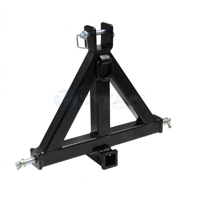

Get a hitch receiver frame for your 3-point hitch. It is loads easier to use than dealing with the fixed drawbar and has a standard receiver tube that you can use to swap out draw bars or rotate a 3-ball setup. Once you get used to hitching up this way (back up to trailer and lift the 3-pt from your seat) you値l never go back to the old way.
My buddy gave me one since i wouldn't take any money for hauling beans to the mill. I love it. i use it mainly for my log splitter but also for moving EMPTY trailers around the farm. It weighs 45-50 lbs. I believe this one came frome Titan attachments. Around $125 with free shipping.
