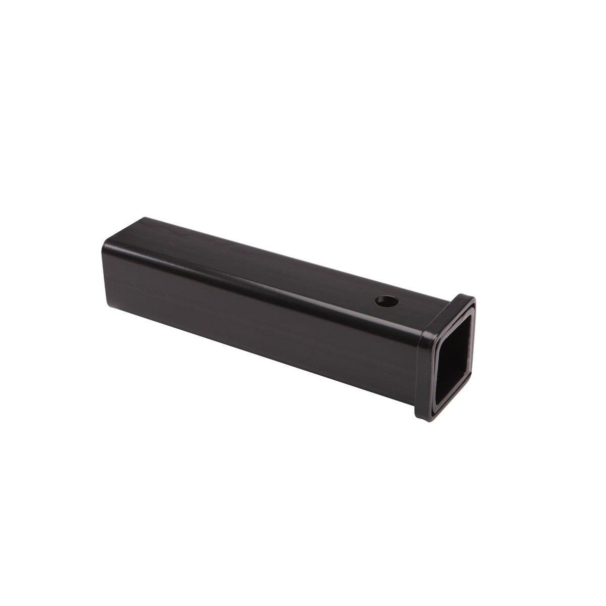

Get one of these at HF store or most any hardware store and weld it to your draw bar. Then you can use a triple ball hitch. Total cost about $40. for receiver and tri ball.

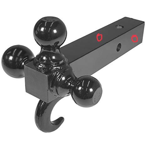

I thought about that for the OP as well. However, if he welds that to the drawbar, he won't be able to pin things to the drawbar anymore. If he just matches one hole on the triple ball hitch on his existing drawbar, then drills a matching hole to the second hole on his existing drawbar, he can then just pin the triple ball hitch to the drawbar when needed, and remove it when not needed. No welding required and maintains the existing drawbar for other uses. He could also rotate the triple hitch 90 degrees and drill one hole through that axis, too, so he can use all three balls. Heck, he can get the triple hitch with a hook on it, too, like this.
I added some red circles as to the two holes I'm talking about. Just make sure they line up with the 2nd holes on the existing drawbar.
He could still use the receiver I mentioned and just insert a hitch without a ball and use the hole in it as a drawbar for other attachment equipment. There's many ways to skin a cat.

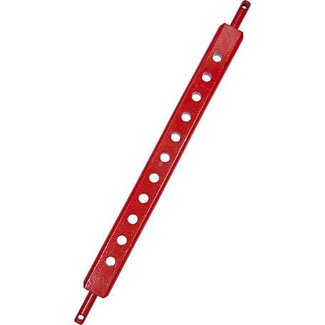

As CADplans mentioned he could mount a ball in this type of 3 pt. bar to tow his splitter. I'm sure the splitter has enough tongue weight to keep it from raising the 3 pt. arms.
If he mounts a ball on the center of that hitch, he'll have to either mount more balls offset from center (probably no big deal at low speeds), or remove the ball and install the other if he wants to maintain center (again, probably no big deal with a log splitter).
