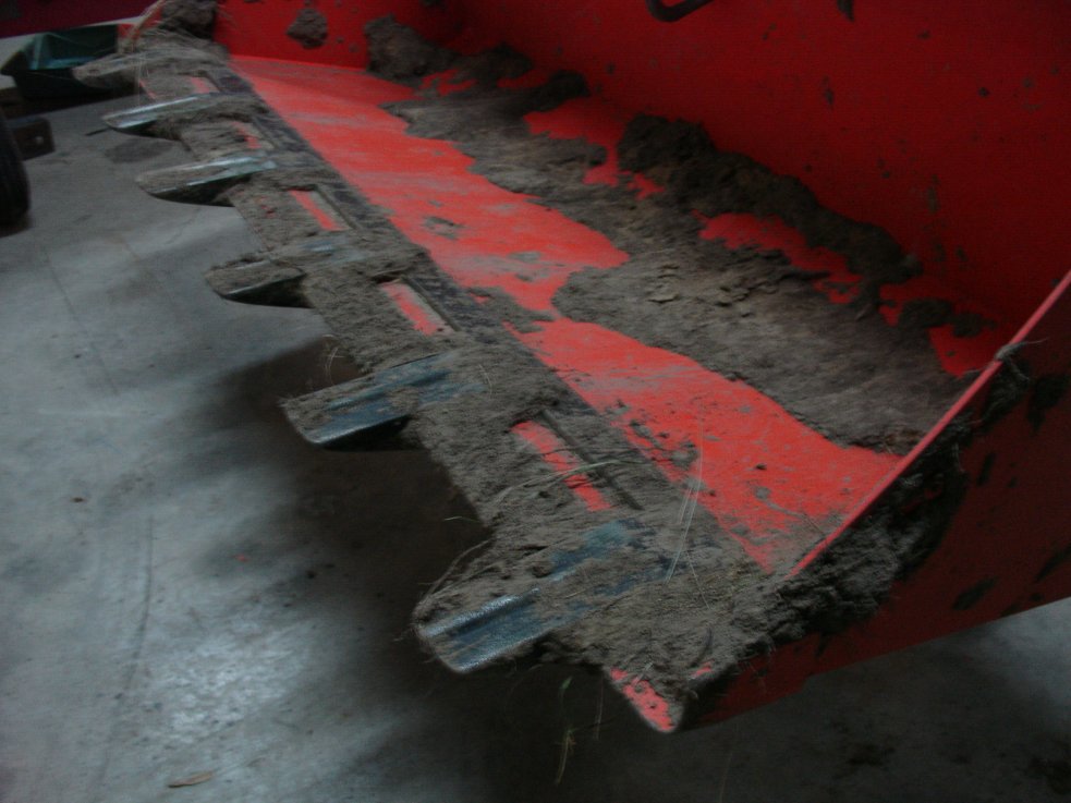

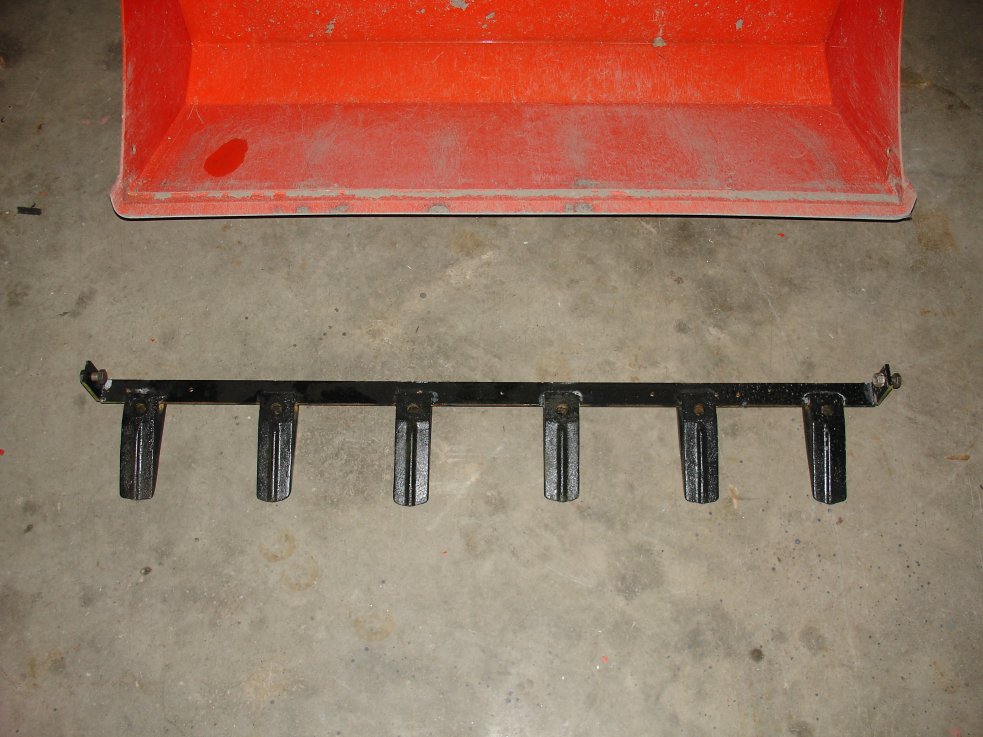

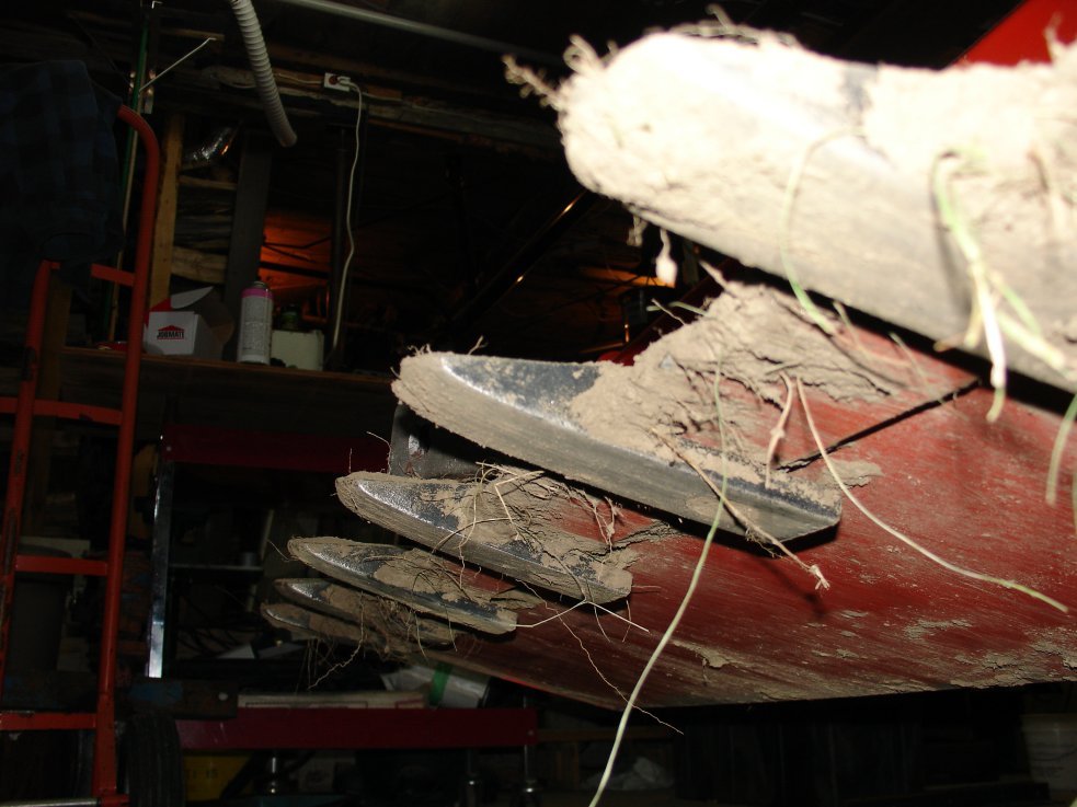

Here is my set-up and it works great and fully removable.

/ Easily Removeable Toothbar? #5
I switched the stainless bolts to avoid the rust problem.

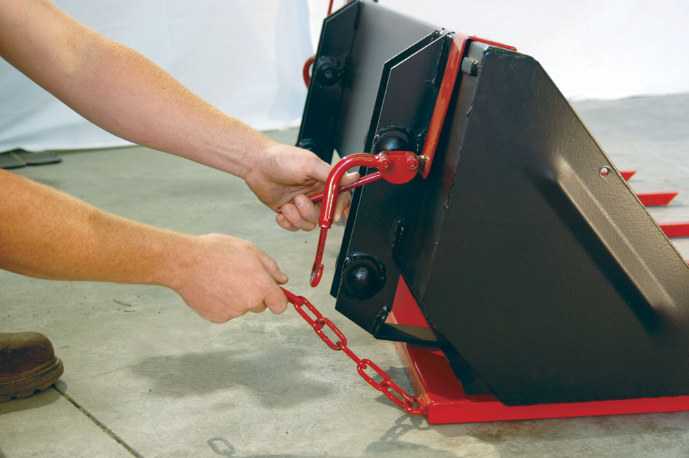

/ Easily Removeable Toothbar? #17
