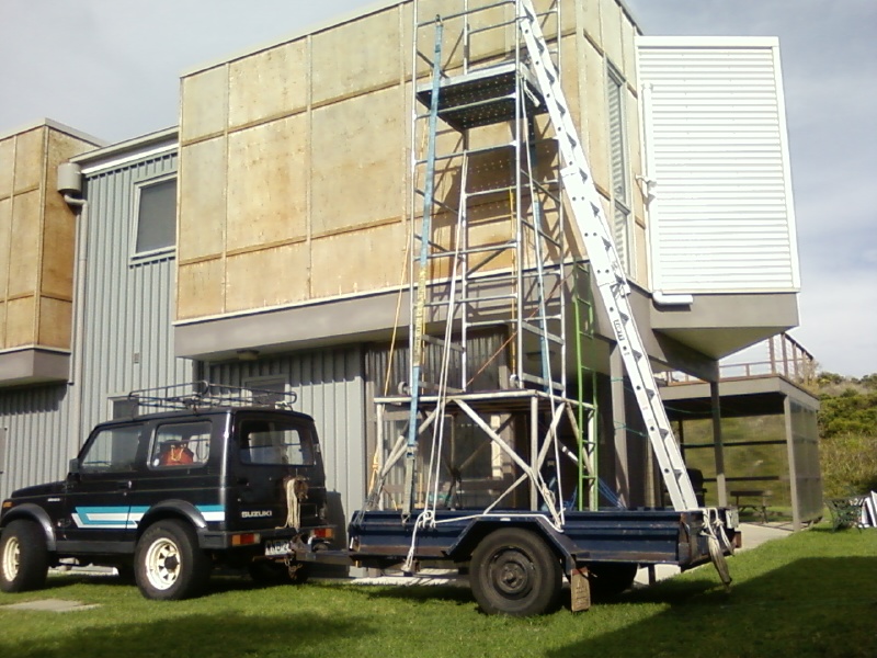

   / easly movable scafold build #2
5 metre scaffold, on top of old rainwater tank stand, on top of trailer... plus lots of rope and straps to hold it all together....

   / easly movable scafold build #3
I like what you've done, BHD.
I've been thinking of something similar, and found a way not to do it.
This looks like a decent idea, but poor implementation.
The story:
Mobile scaffold tower | News | Vertikal.net
Bruce
