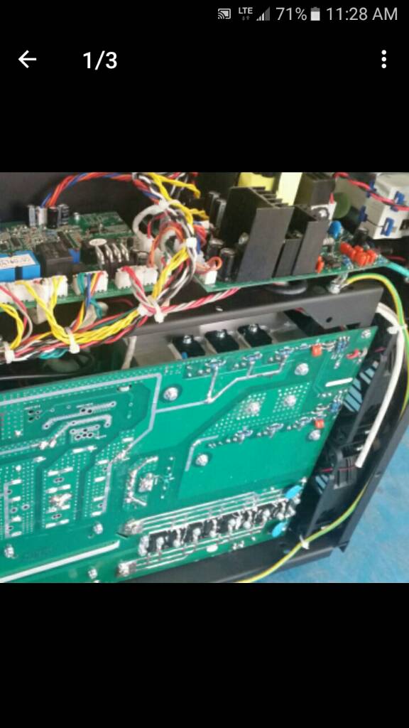

   / Eastwood Mig #28
Hobart has gotten Miller cast-offs. They used to be fairly one to one, but now that Miller has gone to mostly inverter MIGs Hobart is stuck with the older transformer designs.
As far as made in USA, or assembled in USA, this is one of their units they say is made in Wisconsin, the new multimatic 220. Look at the Mex, and Made in Mexico on every board.
