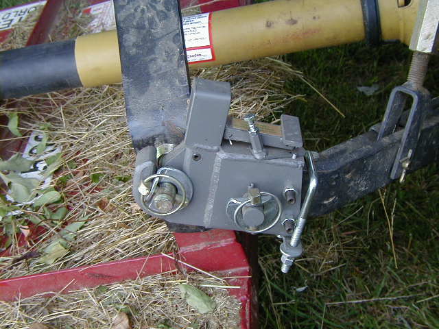

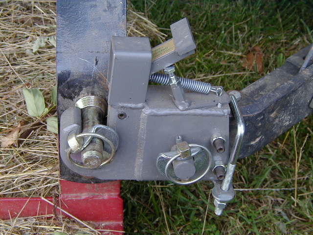

I've never seen this quick hitch up close, so I just wondered what kept the arms from sliding off the end of the pins. The pictures in the advertising don't show anything that will hold them together

The same pin that keeps the 3ph arms from falling off the attachment.

Here's what one looks like close up, maybe you can tell something by the pic.

The first pic is with the latch open, the easy change comes with the washers that are held on by the lynch pins.

I have the system on my 23, and with the exception of all the adjusting screws and the ubolts, mine is the same as everyone elses. I have found that these items may not be needed as much as it seems. I have only the pins going thru the sockets in my lift arms, now everything fits without adjusting anything. Your lift arms are not at the same angle for a 48" tiller as they are for your other implements and with all the set screws I found that they were not "square" all the time, dont have that prob now.
