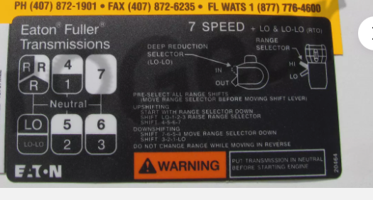

I found a Freightliner tandem chassis speced the way I want EXCEPT it has this 7 speed.
I don’t want to end up hating it because of the transmission.

Got me curious, looks like the T14607B is fully synchronized single range and was used in school bus applications.
Yes, the 7 speed EZ shift was
But the Eaton Fuller was a concrete truck or tandem axle HD transmission is not full

But the Eaton Fuller was a concrete truck or tandem axle HD transmission.
Basically a "7LL" then. U pattern OD on this example.
